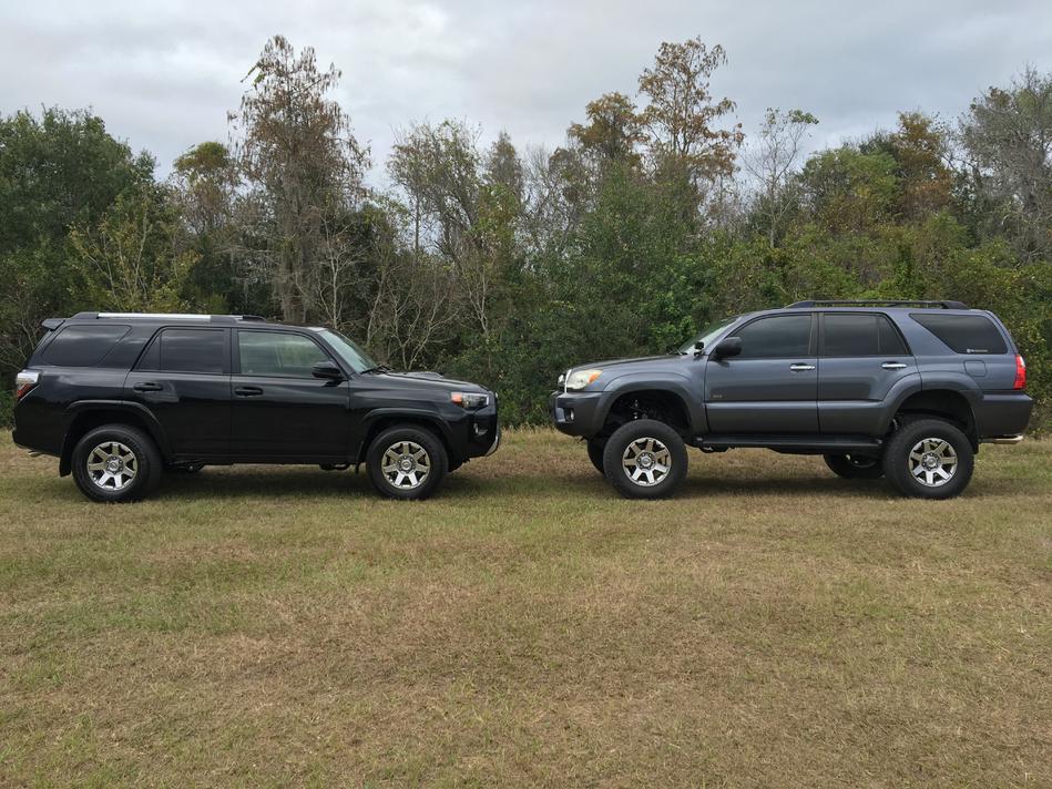

I have them on my 4th gen and they are incredibly stiff when the vehicle is not loaded. It does ride high though.
