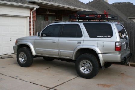

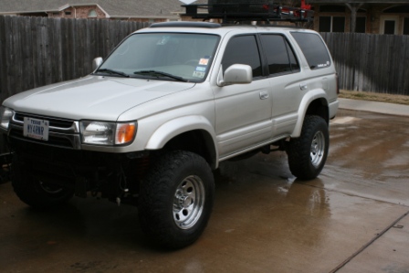

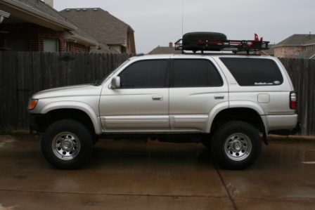

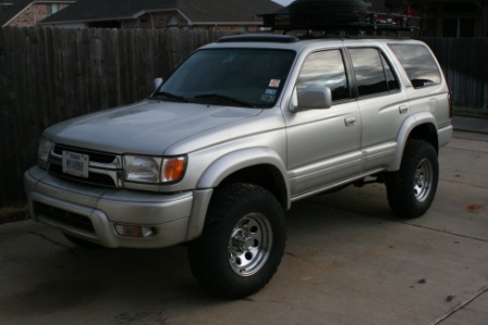

Sorry I did not take photos of each and every step. The runner is now at my friends getting the front bumper fabricated. When I drove it over there, it felt like I had a more solid ride, less creaking, and the steering did not have as much slop in it as before. Overall, I am very pleased with the 4crawler body-lift and recommend it to anyone. I hope to have it back sometime this week with the new bumper. I will then re-install the sliders and my new BudBuilt skid plate, then post a photo of the new and improved runner. Here are photos of before and after the body-lift.

now see my 3rd gen sits that high and its stock how much lift did you put on it?
yeah dude your smoking crack, the '99 only sit one inch higher then the others, his is lifted about 2.5-3 inches taller then our is now.
i just want to know how you figured that out with out a comparison photo or any real point of height reference???
not slamming you man, just perplexed.....

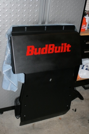

Post some pics up of the budbuilt..
As soon as I get my runner back with the new bumper, I will install the skid, and post photos of both. I just got through painting the skid plate - painted it black and the BudBuilt logo red.
The first two photos are before the body lift, but still with 2.5 suspension - the last two are with the additional 1.5 body - for a total lift of 4". I think your stock runner may be close to what mine is in the first two photos prior to the body lift, but not anywhere near what it is now. Do you have photos of your stock for comparison?
