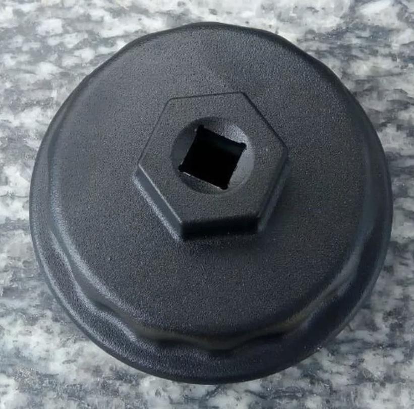

I buy one of these for every vehicle I have owned, motorcycles as well.
