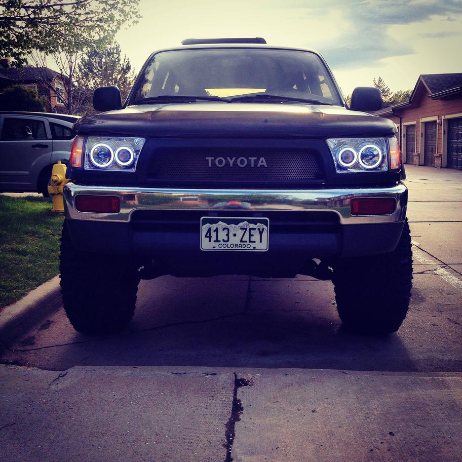

Took me awhile, but I got it done! Love how they look

I do like those a lot! Updates the front end quite a bit. I'm always on the look out for stuff like this because I have rock chips in both of mine....
Would love more info on those.
Do you have a link and cost of these? Also how long did it take to get them from Russia?
??????-???????? ??? Toyota Hilux Surf / 4Runner 185 ("?????????? ??????"), ???? ????? :: Rumin Sport - ????????-??????? ??????????? is where I bought mine. Everything is in russian online so the company will work with you. They run about $300 U.S. Dollars and about $50 for shipping. It takes about two weeks with regular shipping. You can trust this company as well, they will not steal your money.
Now I did a retrofit on these headlights, so I swapped the projector, halos, and put in new halogen highs. Everything inside is new. Had to do cutting, trimming, and new wiring of course. I bought all of my new stuff on the TRS Website. For about another $400. Eveything came to a total of about $800-$900 all done. Message me if you'd like specific info on what I used. Thanks guys for liking them!!!!

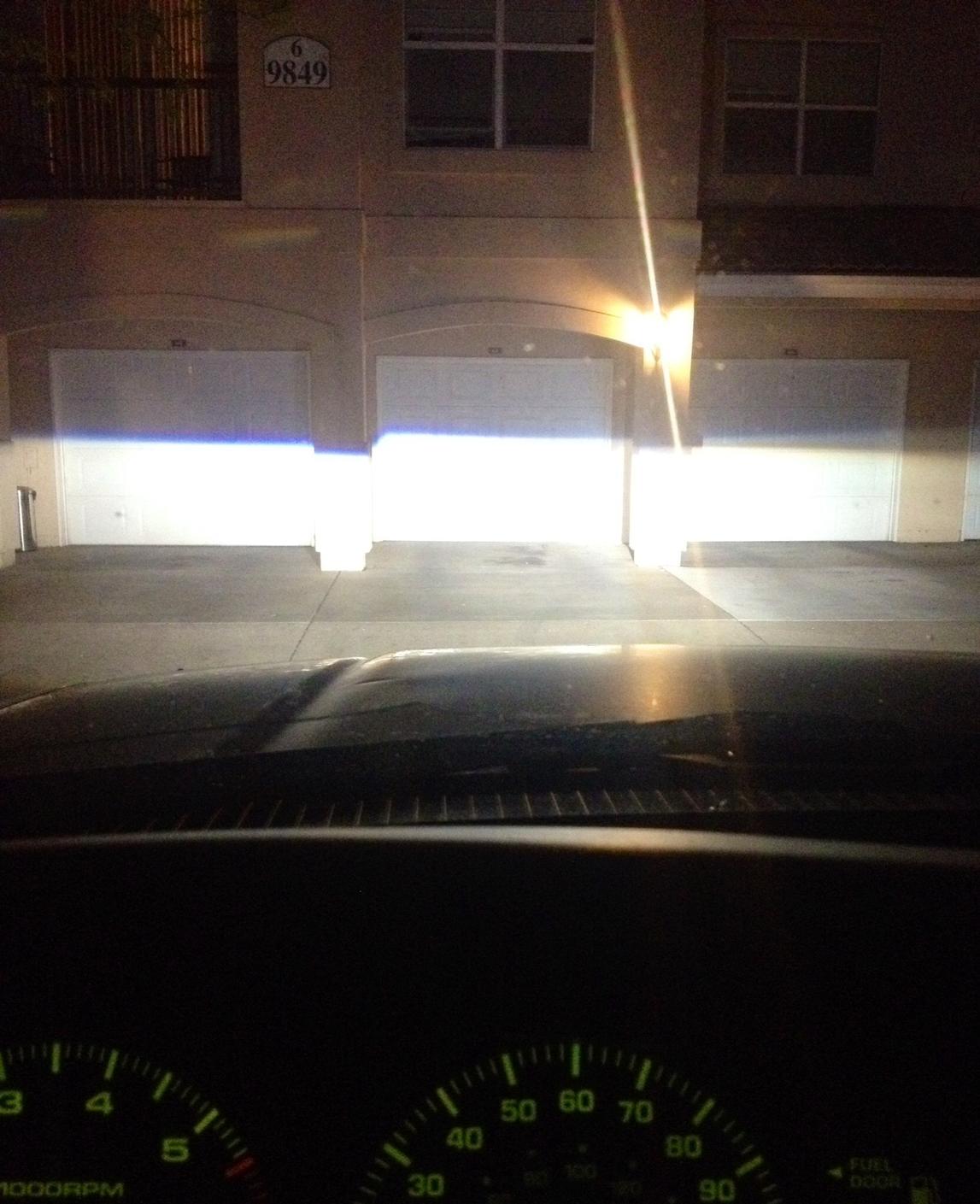

I would agree with you that the lights and projectors that come with the russian made headlights are pretty cheap. The halos are also about 1 inch led spaced and I just didn't like the look. I wouldn't leave the housing as in if you got them. The housing itself is pretty decent tho. I don't know about the right hand driver subject you brought up. I had to open the housing and create a new mounting template for the projectors I retrofitted so I might have fixed that problem there! I will try and get some light output on them tonight.
