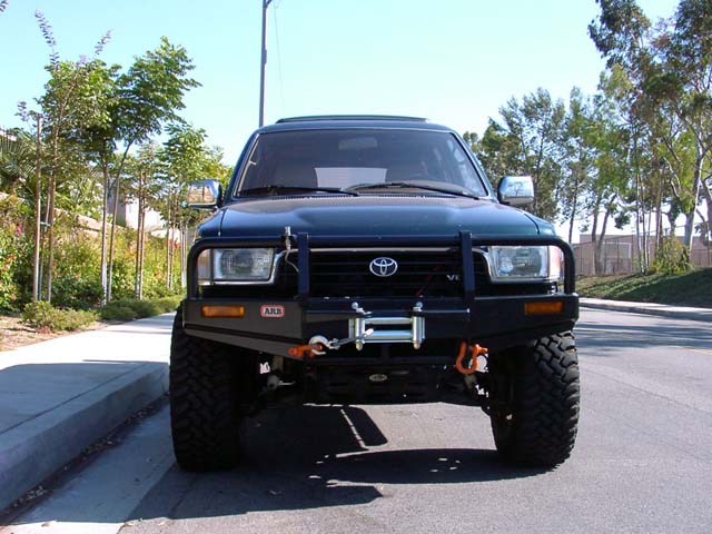

Hey guys..
In the market for a new bumper. From what I understand, there is a ARB front bumper made for the Tacoma, but also fits a 3rd gen 4runner. The one below in image is shown on a 2nd gen, but I'm wondering if this will fit on a 99 3rd gen? I love the look of this bumper. Can someone please point me in the right direction, provide me with a model# and where to purchase?
I believe the bumper is an ARB Bull Bar with winch. Im not going to be adding a winch as of yet, but will in the future.
Thanks guys!!! Appreciate it
yup, that's the ARB deluxe bull bar bumper
for us 3rd genr's, we'll need the Tacoma version, but numerous member use them with no issues.
Autoanything.com has them for $866 shipped, but with a phone call and some haggling you can get them to come down about $40 bucks or so, I'm planning on getting one in a few months as well
ARB Deluxe Bull Bar, ARB Off Road Deluxe Bull Bars

The ARB is for a Tacoma but fits the 4Runner (probably since they have to be certified for airbags in Oz and apparently don't sell the 4Runner there). The PN is 3423020.
Shipping weight is about 150 lbs, but it comes on a heavy pallet. It probably adds about 80 lbs, after you remove the factory bumper and mounts.
You have to modify the frame rails (cut off the ends) and guys usually weld 1/4" steel plates on the end of the rails for support. You should be able to find some good how-to threads, and even some videos. ARB has changed the mounting hardware over the years so it's best to get it then see what you need to do.

If you don't already know this the photo in your original post is an ARB bumper on a 2nd Generation 4Runner.
Below is a pic of the ARB bumper that fits the 3rd Generation 4Runner. These are two different bumpers and are not interchangeable as far as I know. Both versions of these ARB bumpers were made for the Tacoma but are easily modified for the 4Runners of the same body style.

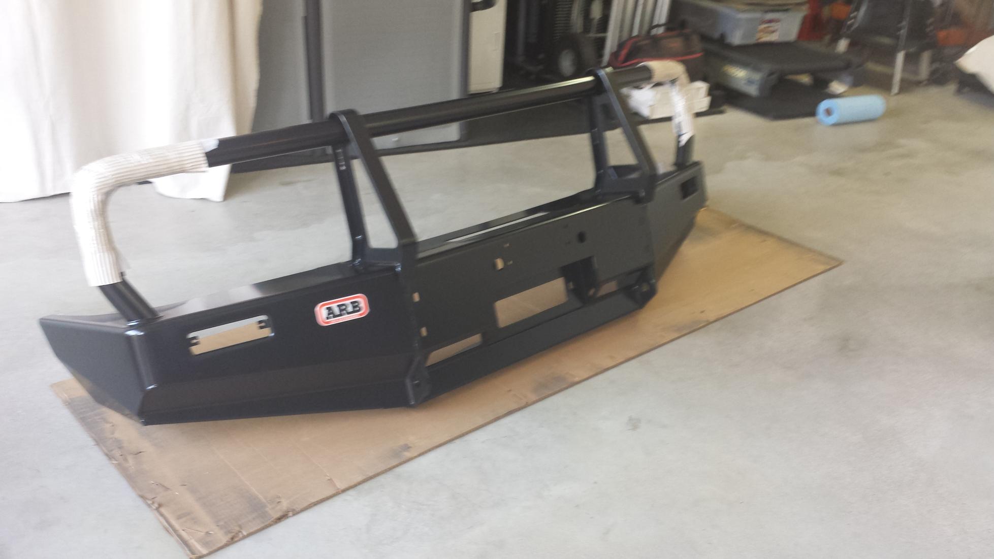

I recently bought the ARB 3423020 from Auto Accesories Garage delivered to my house for $797.09. They have online promotions and was able to get 8% off the listed price (had to call them because the promo of 15% off excluded the ARB) the guy went ahead and gave me 8% which knocked the total to $797 with free shipping...I began installing last night, I need to find a build thread that shows where to cut the frame rails. It is a well built bumper. It was delivered in 4 days.
That is a great price!
Mine was $981 delivered (after discounts), but this was when there was only about 5 left in the U.S. They were on backorder with ARB and the manufacturer wasn't shipping them to the U.S. for at least 4 months. I agree that they are very well made.

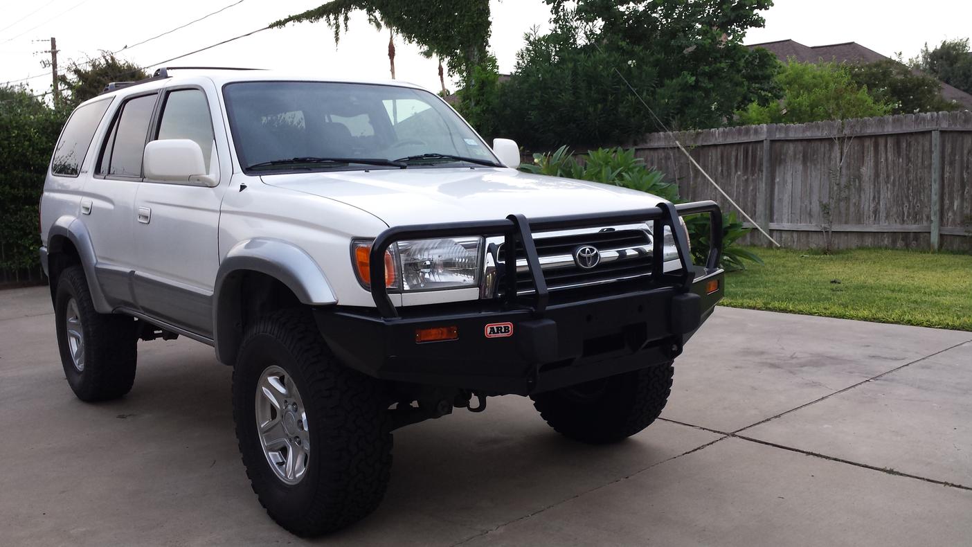

Looks great! Have you thought about color matching the ARB and Limited trim/flares either silver or black? How much is your gap? I'm thinking that 3/8" is probably optimal. Any ARB owners know what is the smallest gap you can have without risking damage to body panels?
I mounted it today. Thanks mach1 for the tips.
Looks great! I love my ARB bumper. A lot of people think they are way too chunky buy in my opinion, they are the best-made bumper you can buy. What other bumper is designed with a proper crumple zone and air bag approval?
