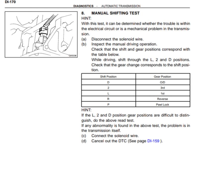

you can download the fsm from the link posted by [MENTION=198376]4Runner4Leon[/MENTION] and go through the diagnostics.drive.google.com/file/d/0B4-QOr310iQRYjY5MDQ0NjgtOTc5Ni00YzZhLTk4NjUtYjk1Y2ZiNjMxMTFk/view?ddrp=1&hl=en
