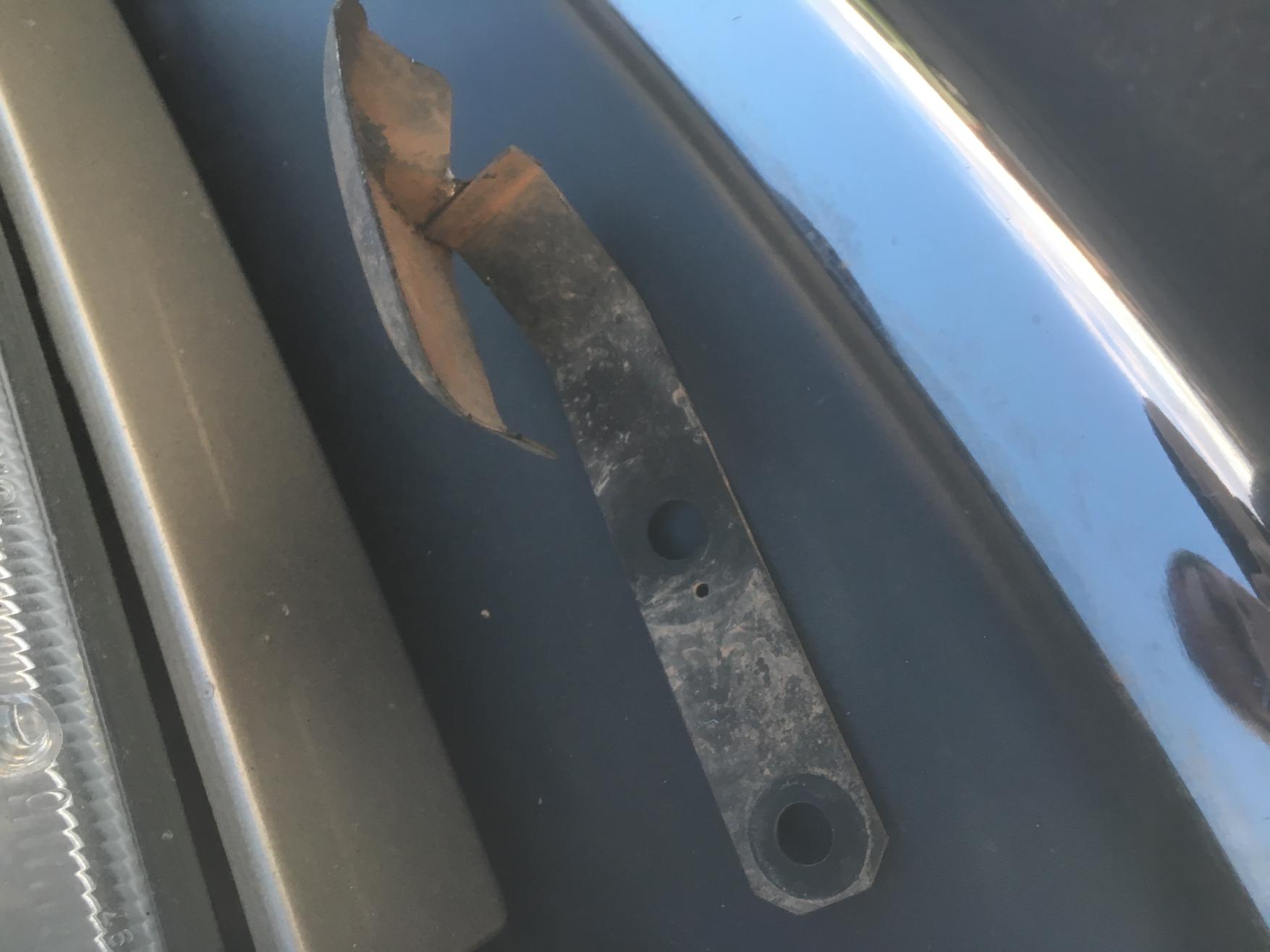

My F150 horns point straight up, so I removed the cover from the stock horn, bent it a little in a vice, and attached it to the nearest bolt so the horn doesn't fill with water next time it rains.
