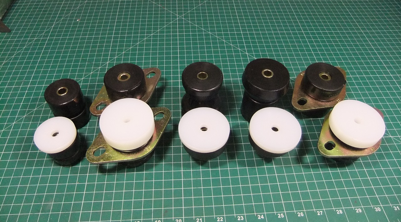

Question about body lifts:
How necessary are new body mount bushings?
