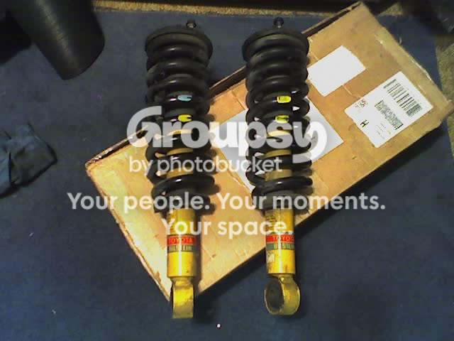

Need some help! So i ordered my tundra springs for my 99 t4r from discount toyota parts online using part numbers 48131-AF100 (driver side) and 48131-AF090 (passenger side). Well they arrived via fedex today and both springs colors are yellow/blue as you can see in the pics. The factory tag has been removed from one but had a sticker with part number 48131-af100 FR, I'm assuming which means front right? I know the driver side spring should be yellow/yellow. Is there a passenger side spring with that same part number with the colors yellow/blue. I know i specified left hand and right hand with the part numbers when i ordered them. I am also wanting to know what kind of issues i would have running the yellow/blue on the driver side? Any info on this would be greatly appreciated. Sorry for the big pics i tried to resize with no luck.

The difference will be 0-.5" in height, hard to say exactly. I would have them send you the correct one so you don't have as much discrepancy and the drivers side carries more weight. There won't be any issues as I did that my first time putting my tundra coils on (not my finest moment).
Thanks for the info.

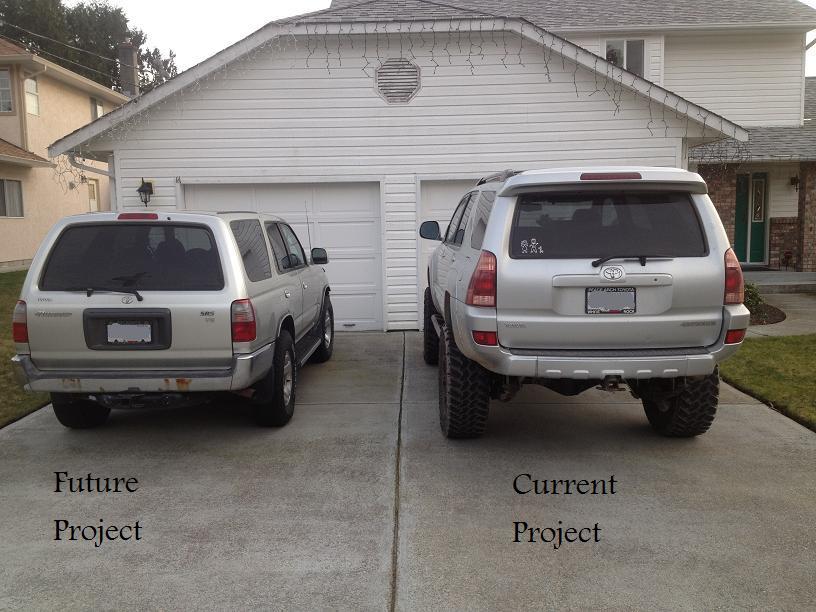

I found a new project for the next couple years once I'm finished my 4th gen... Right now it's all stock except I threw my 4th gen rims on it! I plan on finishing a few more things on my current project before I start, but I will definatly start paying alot more attention to the 3rd Gen sub-forrum and will be full of questions at some point once I figure out what I want with this thing... (Its my dads but he said "have fun with it" :boink: )
