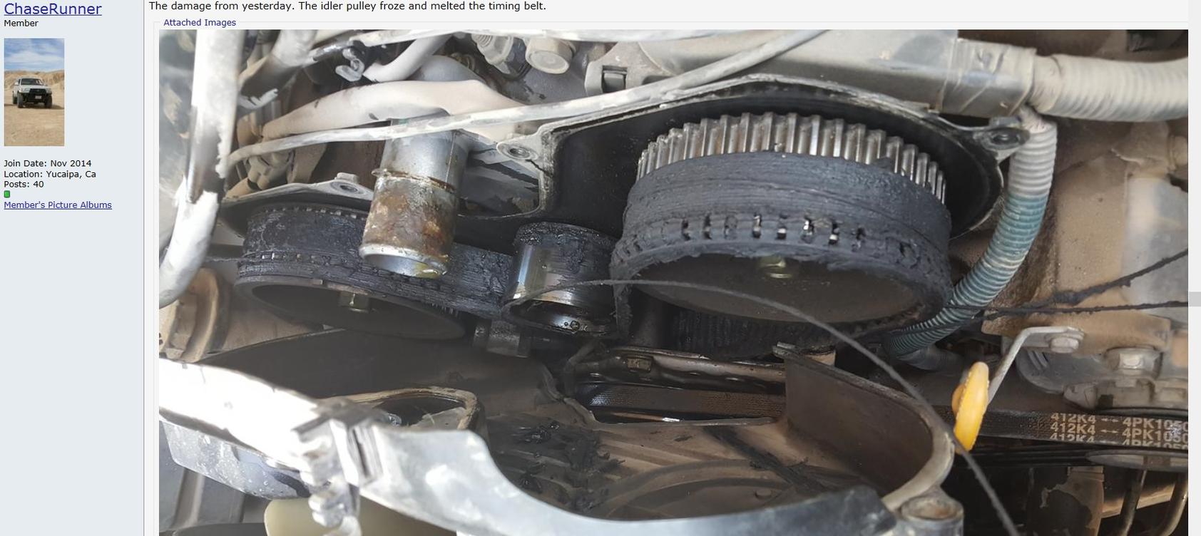

I guess this would be a reason to replace the pulleys when doing the timing belt.
pic from this thread: http://www.toyota-4runner.org/so-cal/220475-june-2016-meet-run-9.html
