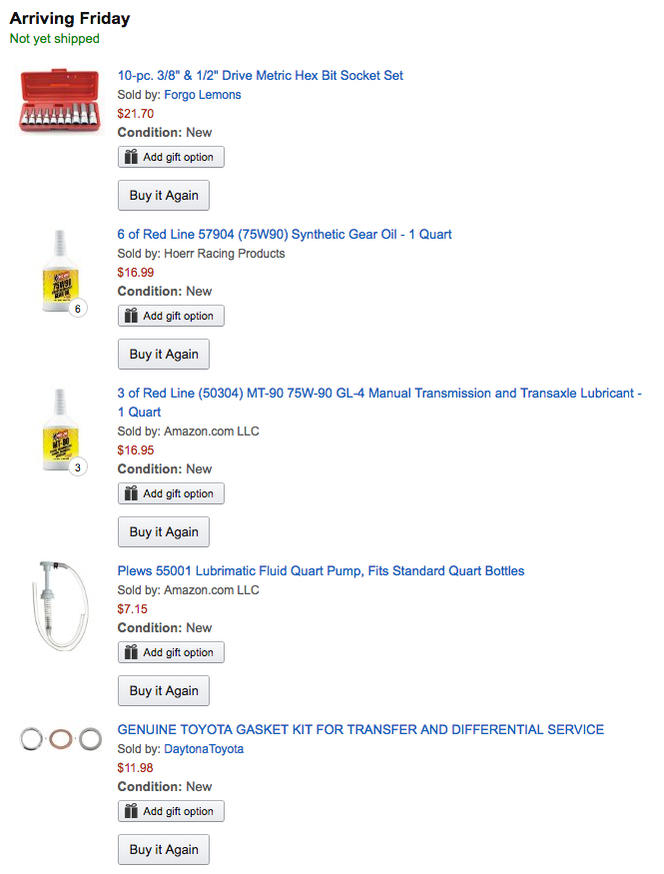

I was gonna buy this pump.
https://www.amazon.com/gp/product/B000BQW5LK/ref=ox_sc_act_title_1?ie=UTF8&psc=1&smid=ATVPDKIKX0DER
Another question, can I use my ten pack of Toyota oil drain plug gaskets for the diffs, trans case & M/T? I see special gasket kits like this.
https://www.amazon.com/gp/product/B017V4BAXI/ref=ox_sc_act_title_2?ie=UTF8&psc=1&smid=A32SNTCC2T0DPY
I'd rather use what I have.

That pump would work. I just bought one at O'Reillys. It had a tube extension so you can use the gallon size containers as well.
As for the gasket kit you provided a link to, the part numbers and quantities are correct:
These are the part numbers for the drain plug washers to do a fluid service on your rigs:
Transfer Case Fill & Drain Plug Washers: #90430-A0003 (need 2)
Differential Fill & Drain Plug Crush Washers: #12157-10010 (need 3, 2 for the rear fill and drain plugs and one for the front fill plug).
Front Differential Drain Plug Washer: #90430-24003 (need 1)
Engine Oil Pan Drain Plug Washer: #90430-12031 (need 1)
Auto Trans Drain Plug Crush Washer: #35178-30010 (need 1)
What's the difference between two. Besides one saying transmission oil and one saying transmission and transaxle, and the other just synthetic.
The MT 90 M/T fluid is GL-4 which doesn't have the reactive sulfurs that the GL-5 gear oils have. GL-5 oil in our M/T breaks down the Brass parts.
GL-4 for the trans & GL-5 for the diffs & T/C.
