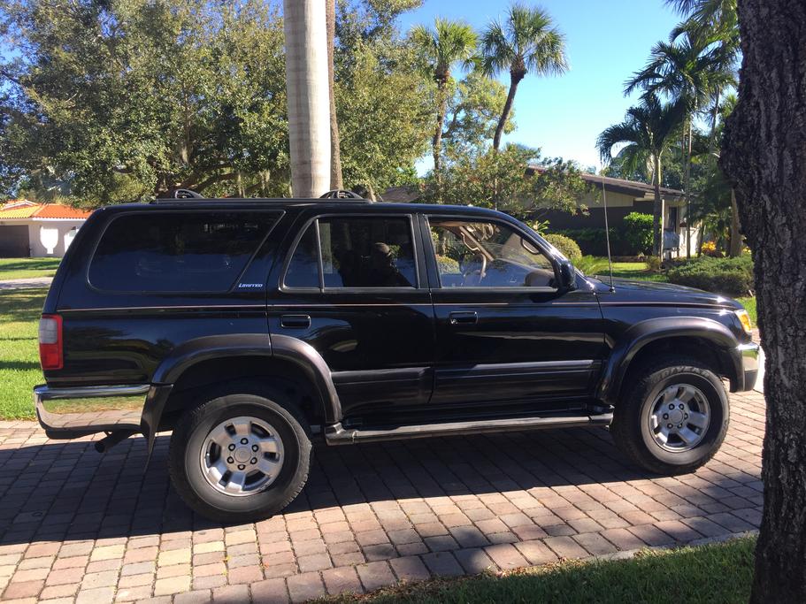

Before - See rear sag:

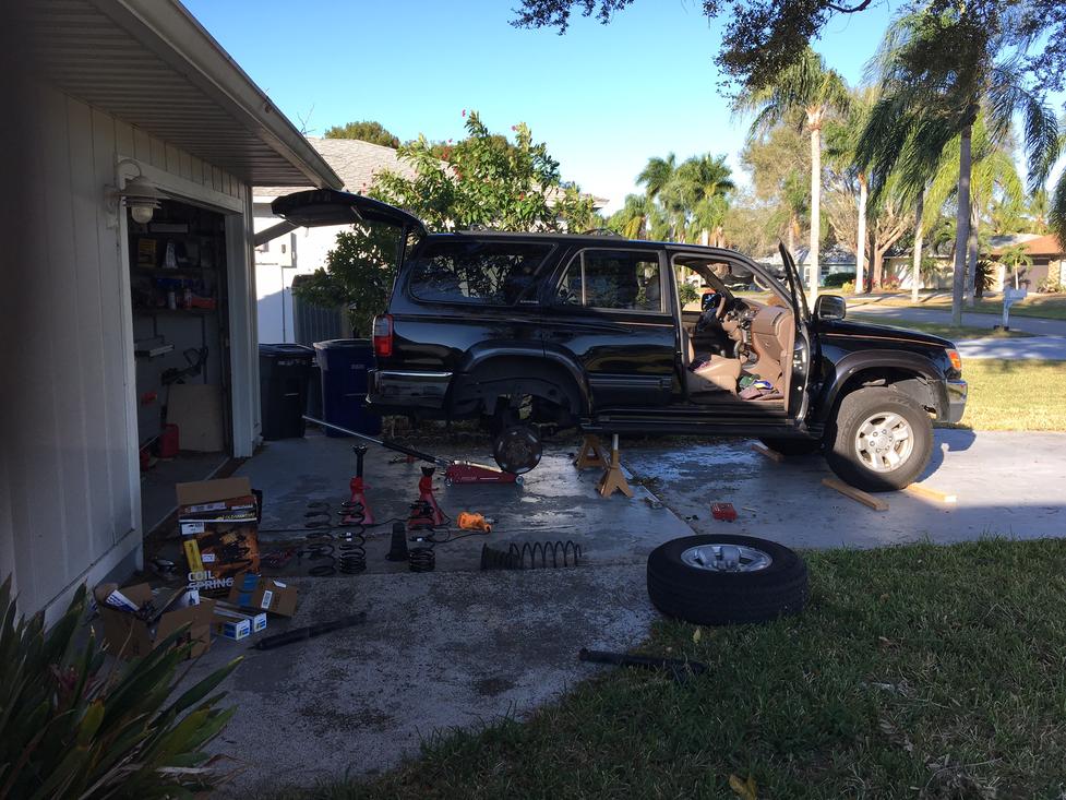

During - Using 6 ton jack stands on the frame, undid the e-brake bracket, unlinked the sway bar, and dropped the rear axle using a floor jack. Springs came out with scarcely a wiggle, new ones went in no problem.

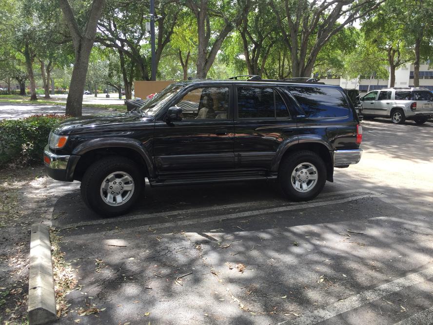

After - haven't measured, but a decent rake front to back - I don't notice a stiffer ride, in fact, I think it is damping quite a bit better in the rear.
