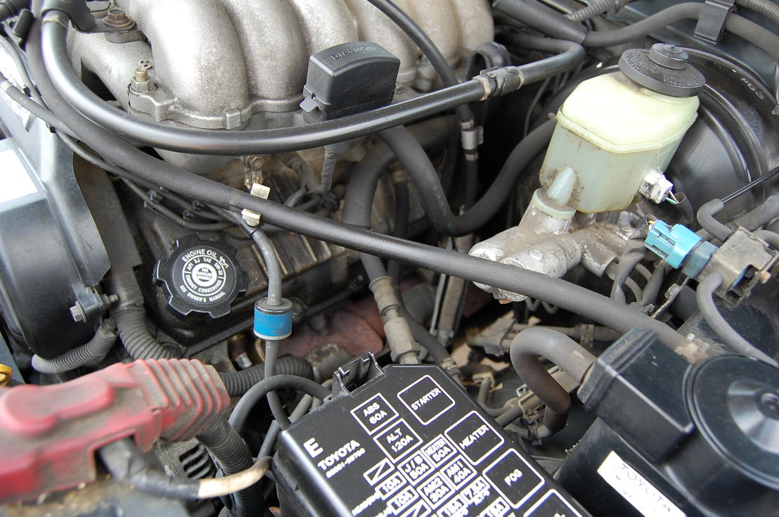

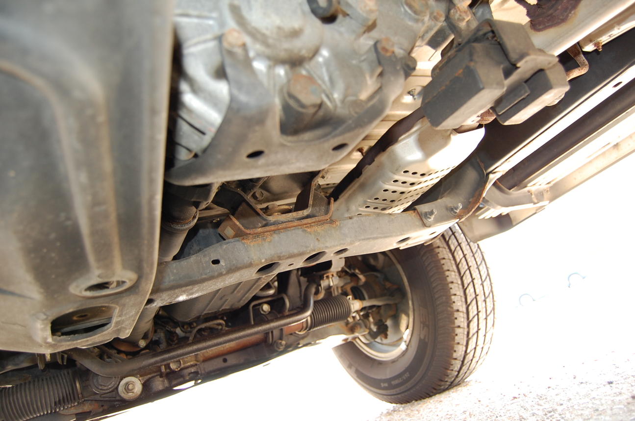

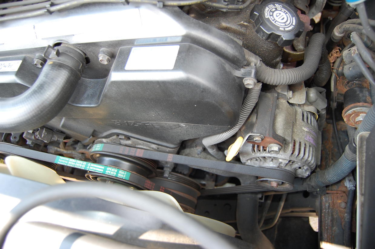

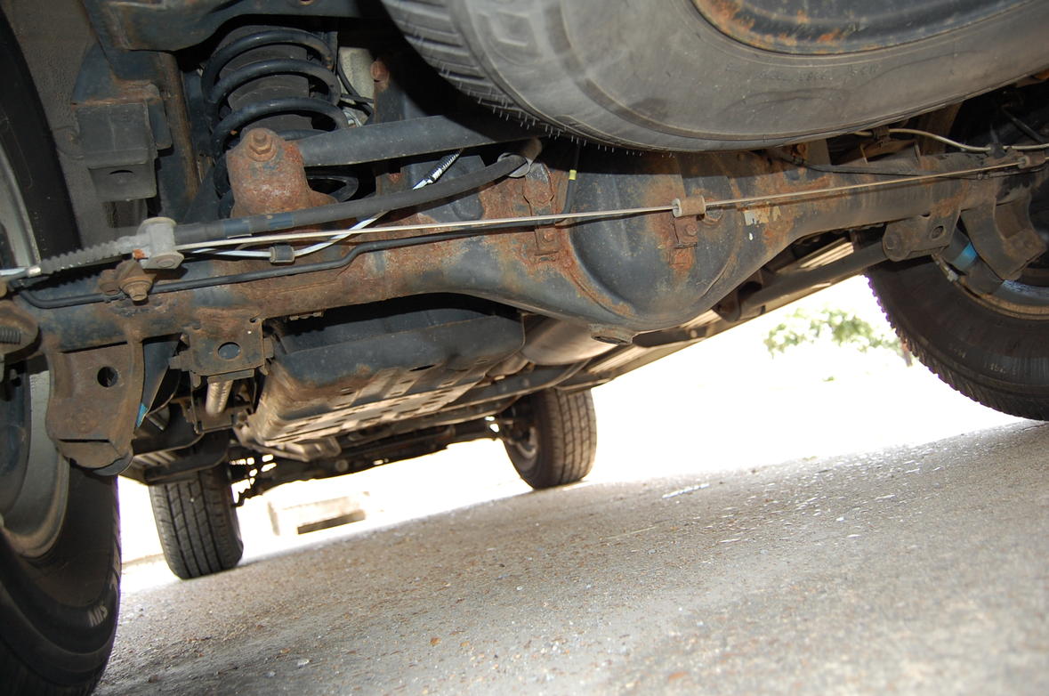

Thank you so much for all the helpful information. This is exactly why I came to this site for help. I just got a few pictures of the undercarriage and engine compartment. Should I be concerned with the rust shown in these pictures, or does it look like normal wear/corrosion on a 11 year old truck? By the way, is the only difference between the 1999 and 2000 Limited (both having multi-mode 4WD, AWD, and a rear diff lock) the 1 inch coil lift?

What do you guys think about the rust in the pictures above?
That doesn't look too bad to me, but we've only heard of rust in CA so what do I know.:) It looks like the steering rack might be leaking though, it's hard to tell in the pics but it looks wet.
about the 2000 year models, my 2000 has the push button awd, center diff lock and rear locker, just like the 99s. So don't limit your search to just 99s massey. The rust in those pics doesn't look that bad though, I'd have a mechanic do a once over on it and snag it if he approves. It may be a LONG time before you see another 99-00 for sale with all those features!
