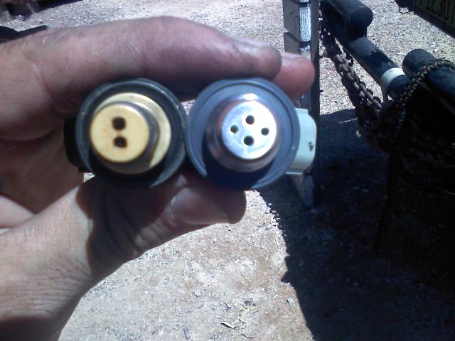

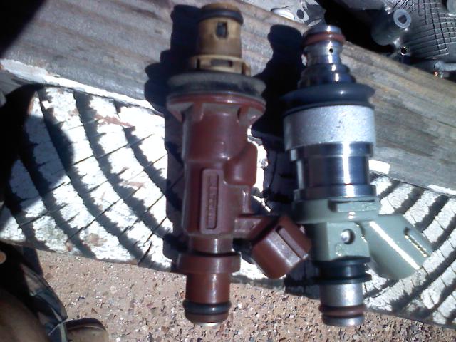

ALRIGHT EVERYONE! I got the new injector from rock auto, a GB rebuilt one. I yanked the intake off tested the #4 injector ohms it tested good at 14.1 ohms when cold. I came inside and tossed it in the oven just long enough for it to get hot, pulled it out the oven, tested again... Annnnnd... drum roll... outer limits!... which means there is a open in the injector when its hot. There is a break in the electrical connection only when hot. also of note: the stock injector is plastic and the GB rebuilt one is metal. I thought the stock ones would be metal too... guess not. also the metal one has one extra seal where the plastic ones just are molded with that extra hump. the nozzles look different too. Do any of you know why they are different? when they changed them? just curious.
I just check the bad injector again after it cooled down and now it reads fine again. There it is, thats why a only hot misfire. hope it helps someone.
