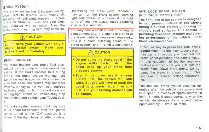

Thanks raydouble, yes it did come with the manual, I didn't look for this symptom in there, thougth this would be the quickest, does it reference this in there?
Look up "brake system" in the index should be there. They describe the hydraulic booster system.
Here's a scan of my paper copy of my manual on pg. 197....
