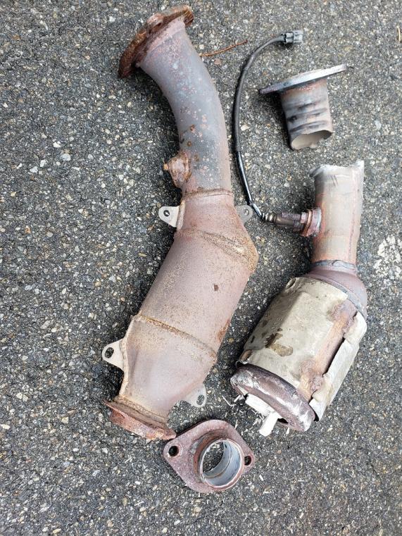

I broke my new Walker cat in half in a 6 months, I put my original 20 yr old cat back in. I may just straight pipe it, no smog in my state anything over 14 yrs old.
