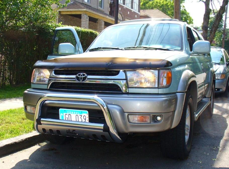

You encouragrd me to do the same on my 3rd Generation 4runner. I simply followed you instructions, step by step.
This bullbar fits car perfectly. Guys, if someone decides to do the same, I'll be more than glad to answer your questions on installation. And for those, who always want pics, I'll attach few.
