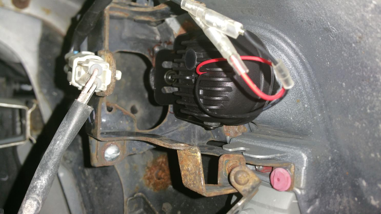

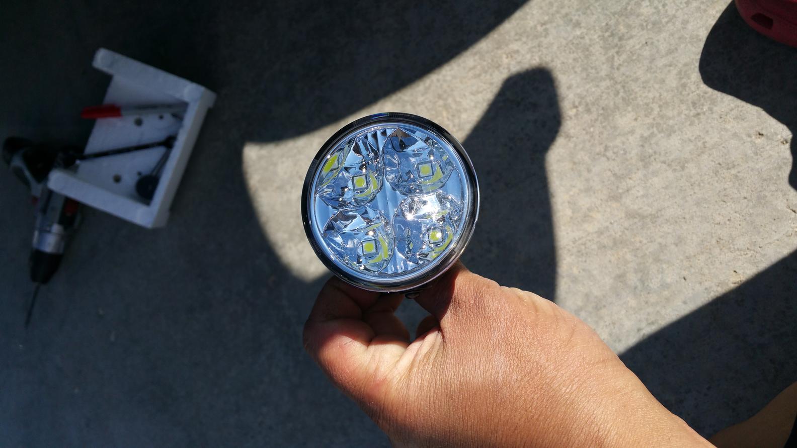

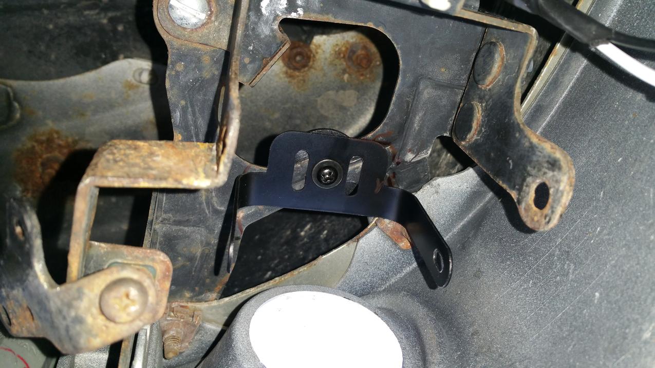

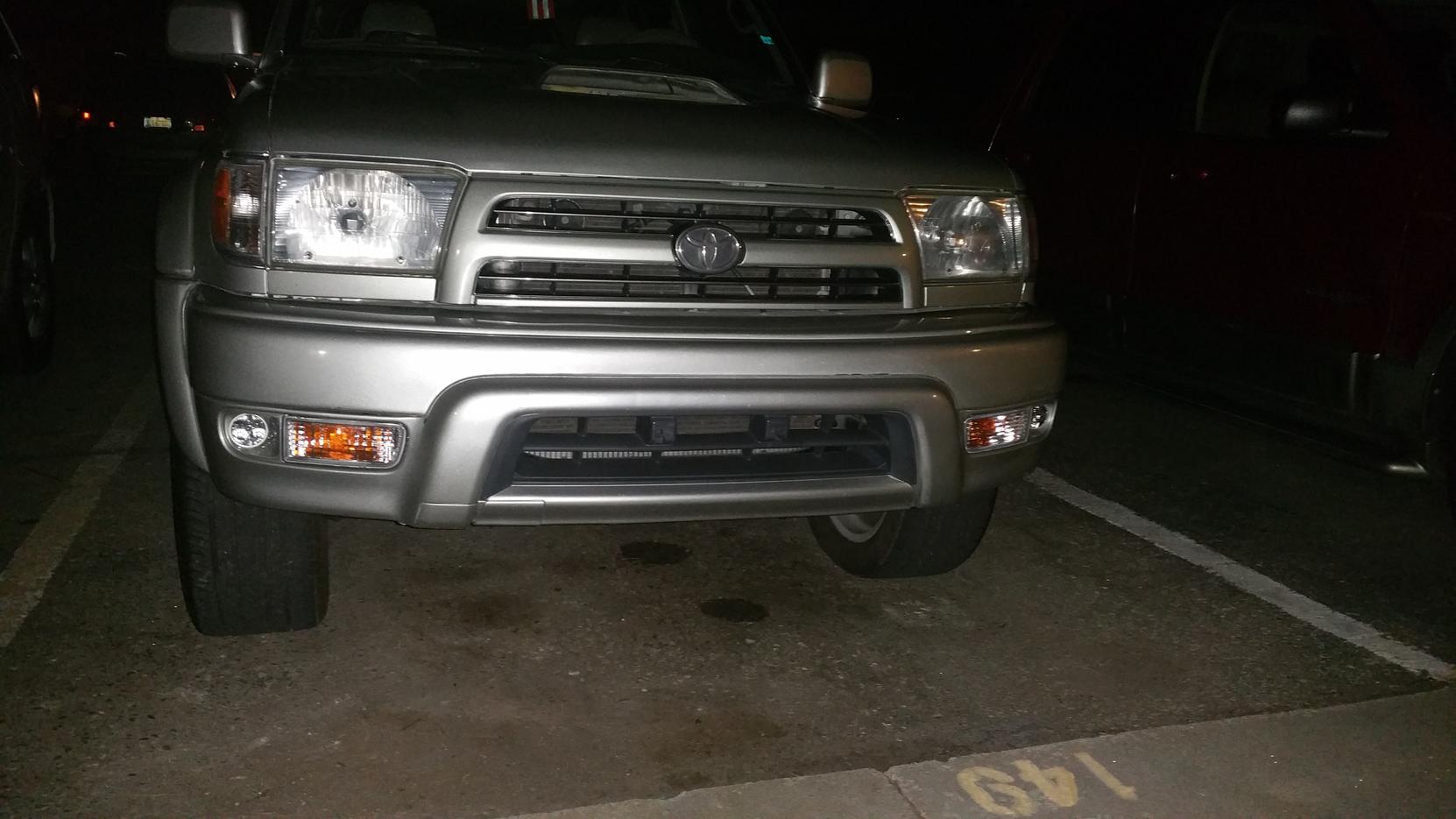

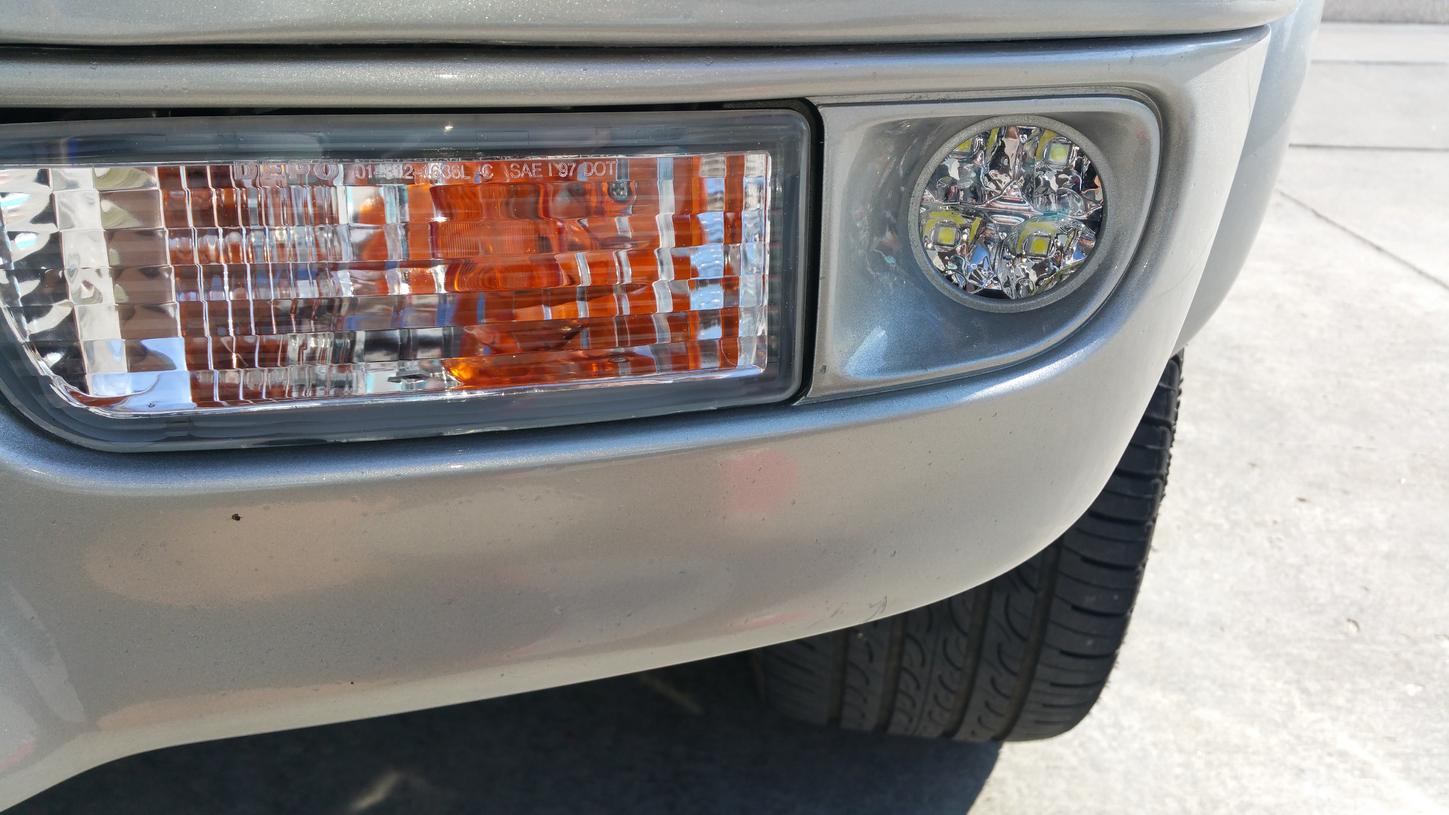

i was looking to replace my factory fog lights since the glass on them was all damage but since they are so small 2".diameter is hard to find options so in my search I find this Walmart Led 2.75" diameter fogs thinking I can modified this to make them fit but for my surprise the fit nice without cutting the plastic on the bumper i just drill a hole in the factory bracket and done. Hope this will solve some problems for much 3rd Gen owner s wanting to replace the factory fogs I'll post pictures later.

Awesome! been wanting an alternative since my 4runner didnt have any fog lights and the stock ones are way to expensive for what they are.
can you get pics from the back with the light installed also? looking forward to the update!

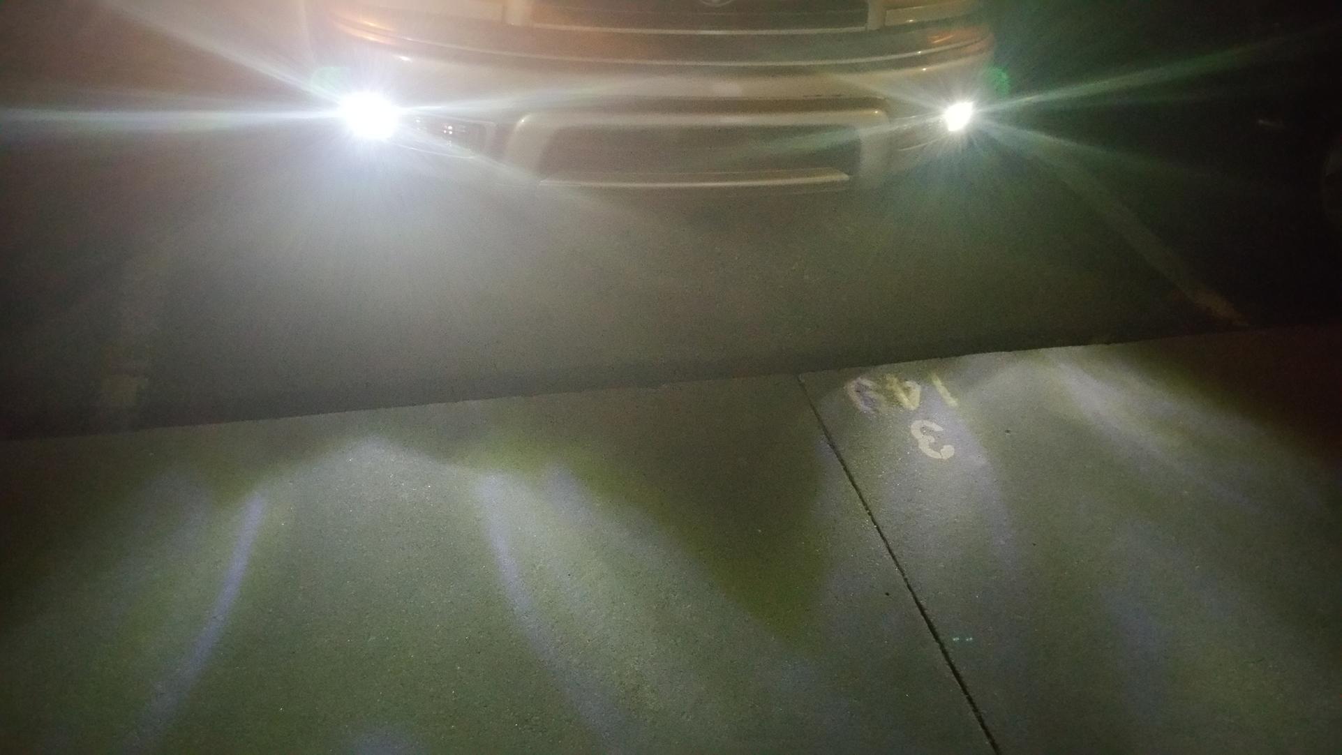

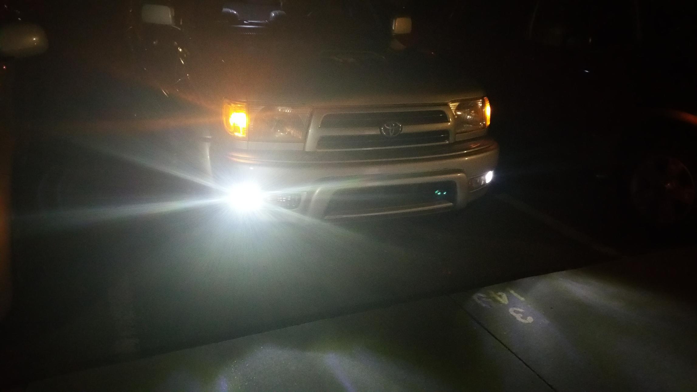

Are these DOT approved? I'd be a bit worried about using these on the road in traffic due to the pictures and the amount of glare from eye level. I went a similar route and found that it is very hard to find aftermarket fogs (besides rigids) that keep the light low enough for road use. Just my two cents!
Install looks great though :cheers:
I went down this road looking for similar fog light options but wanted something I could run on the road but would still make a decent difference when offroad.
Those do look nice though.
Looks like ProBurner 4-LED Racing Light Kit #551349916. Google search with the info he provided. Bam.
