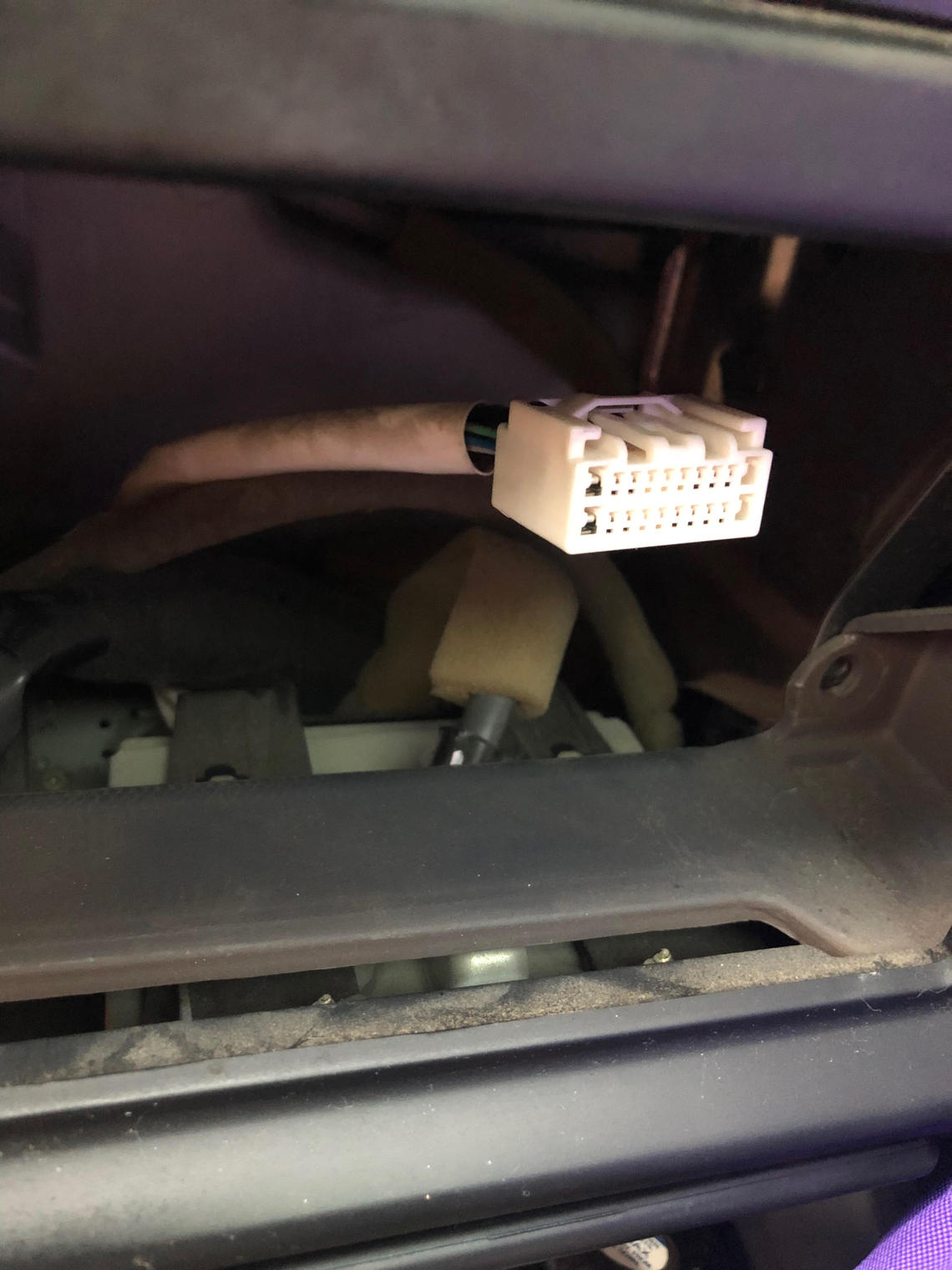

Hey guys,
I am trying to put a new radio in my 2000 SR5 and all the wiring harnesses I find for 4runners in the time have two plugs instead of just one, which is what mine has. Would anyone know where I could find a plug that would work for this so I don't have to cut it and hard wire it in.
Thank you!
(P.S. I upload a picture if the plug it has in it for the radio, hopefully it uploads)
Hi,
[MENTION=280910]Tracebulldog21[/MENTION] I'm giving you a quick answer because 1) I'm in Ireland on V and 2) this thread isn't really for answering this type of question.
I believe you can buy an adapter to go from the stock harness clip to an aftermarket deck by visiting https://www.crutchfield.com/ or calling 1-844-518-3420. They are great and phone support can get you the right adapter very quick.
If you want other answers also check out the stereo threads here on T4R. Visit the "How to Search" link/stick and type in "stereo adapter" then comment in one of those threads.
How to search ----> http://www.toyota-4runner.org/off-t...far-more-accurately-than-standard-method.html

You have to unhook the oem amp that is on that 4runner.
Once it is removed you will have the two plugs you are looking for once you unhook them from the amp.
The amp is located just below where the factory head unit is. Looks like this...
Sent from my SM-G950U using Tapatalk
