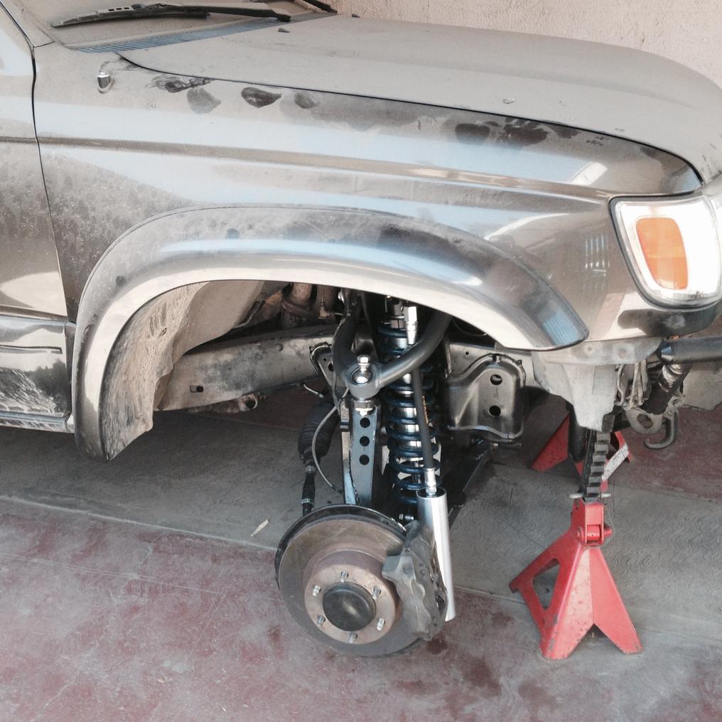

finished my installation friday with FOA shocks, only issue i see is that i ordered 8" travel shocks and the ones that i got are a tad over 9" they are a bit long for what i wanted..
Orbot, your setup looks incredible. I'm half tempted to drive to Chula Vista for a ride shotgun. Please, please keep us posted with your impressions of the Camburg setup.

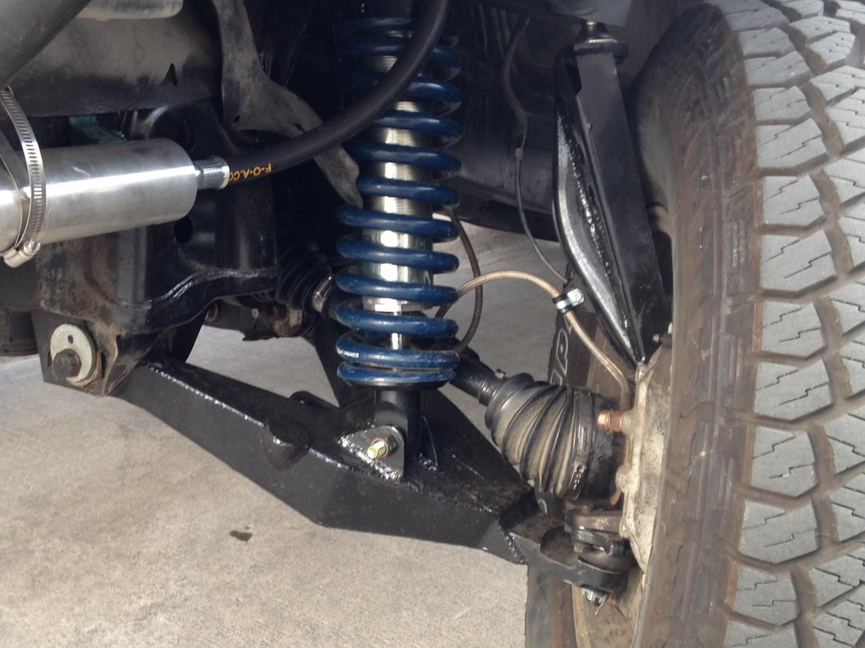

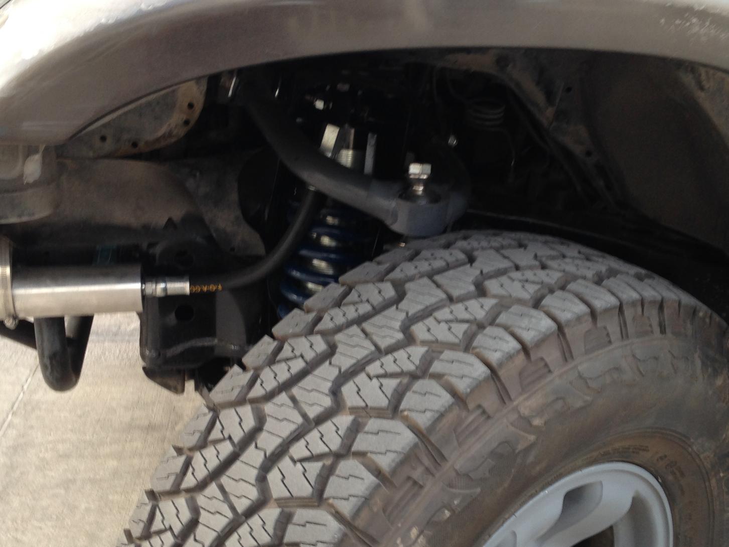

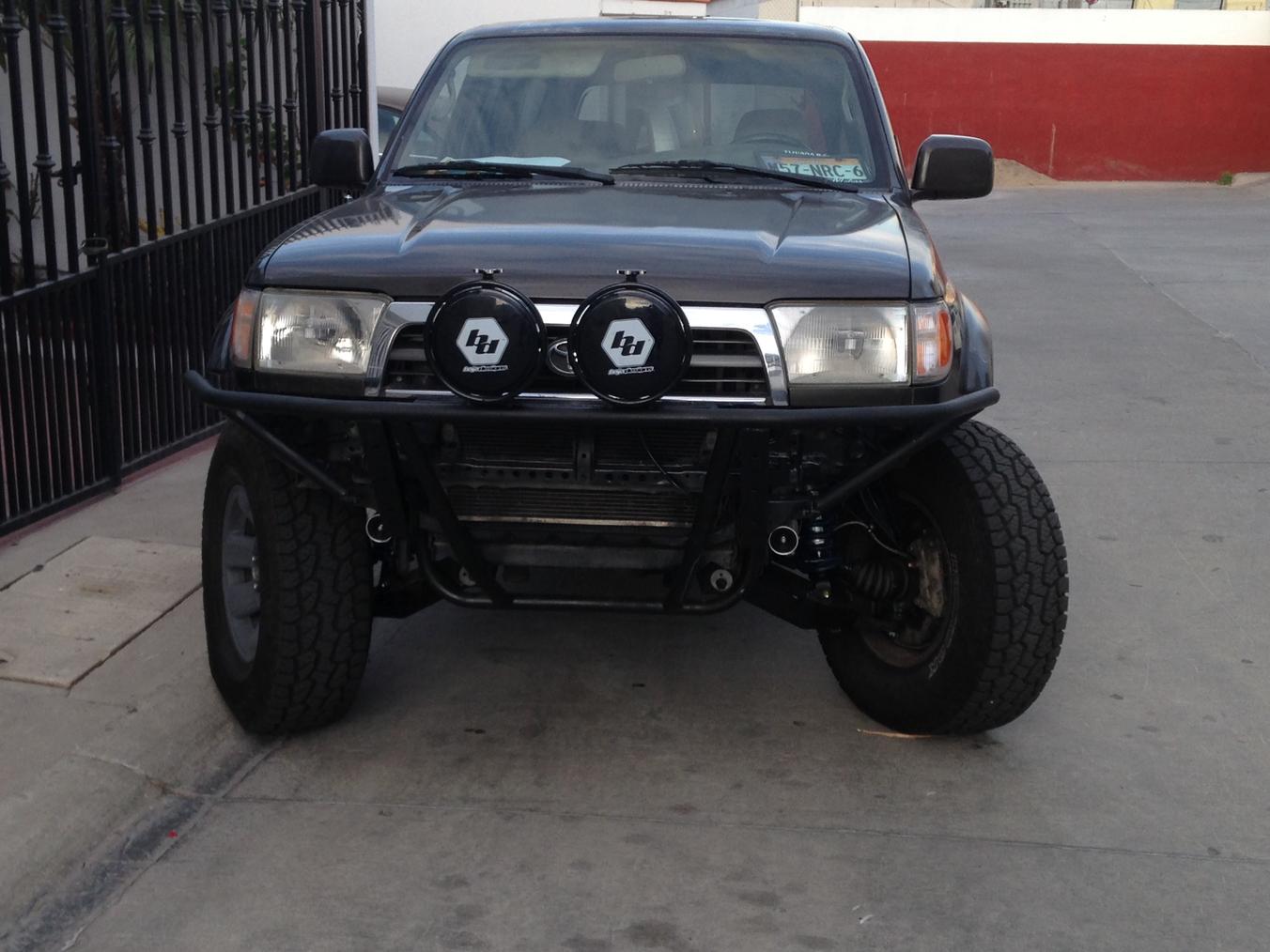

Here goes.
finally got the truck on the road...drove it a couple of days, did alignment
my main issues are:
shocks are a bit longer wich gave me hardly no travel, i had to crank the coils down to lift the truck in order to get travel, wich i dont ming truck looks nice.
now i have to fab a custom upper shock mount.. im thinking on getting the upper uniball bushing through the shock cup hole and fab a mount on top wich will give a couple more inches, so this plus the height and bump stops should be ok, i dont plan on racing this thing.
As for the ride it feels nice. im using 500 hypercoils i had from another set of shocks i bought.
Anyone got questions feel free ill do my best.

Don't be jumping your 4runner anytime soon. Your shocks and shock mounts will be used as a bump stop.
Did Camburg recommend a 8" travel shock? FOA shocks are taller than other brands.
i know, im afraid ill have to cut the bucket..
the kit is suppose to be brand specific either fox or race-runner
Both camburg and total chaos recommend 8" travel coilovers. Solo motorsports too for that matter.

UPDATE.
Finally got a chance to hit the dirt.. not a complicated trail, just an access road a few bumps and holes in the way, truck did good i really liked the suspension.
i have med compression and firm rebound with 500 Lbs hypercoils coils. 265/75/16 and custom front bumper. 180 Lbs of gas in them.
