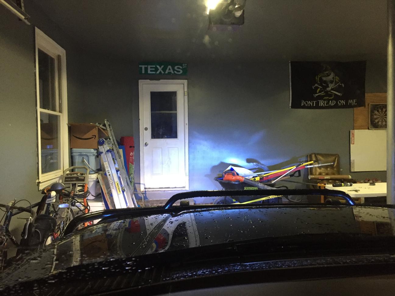

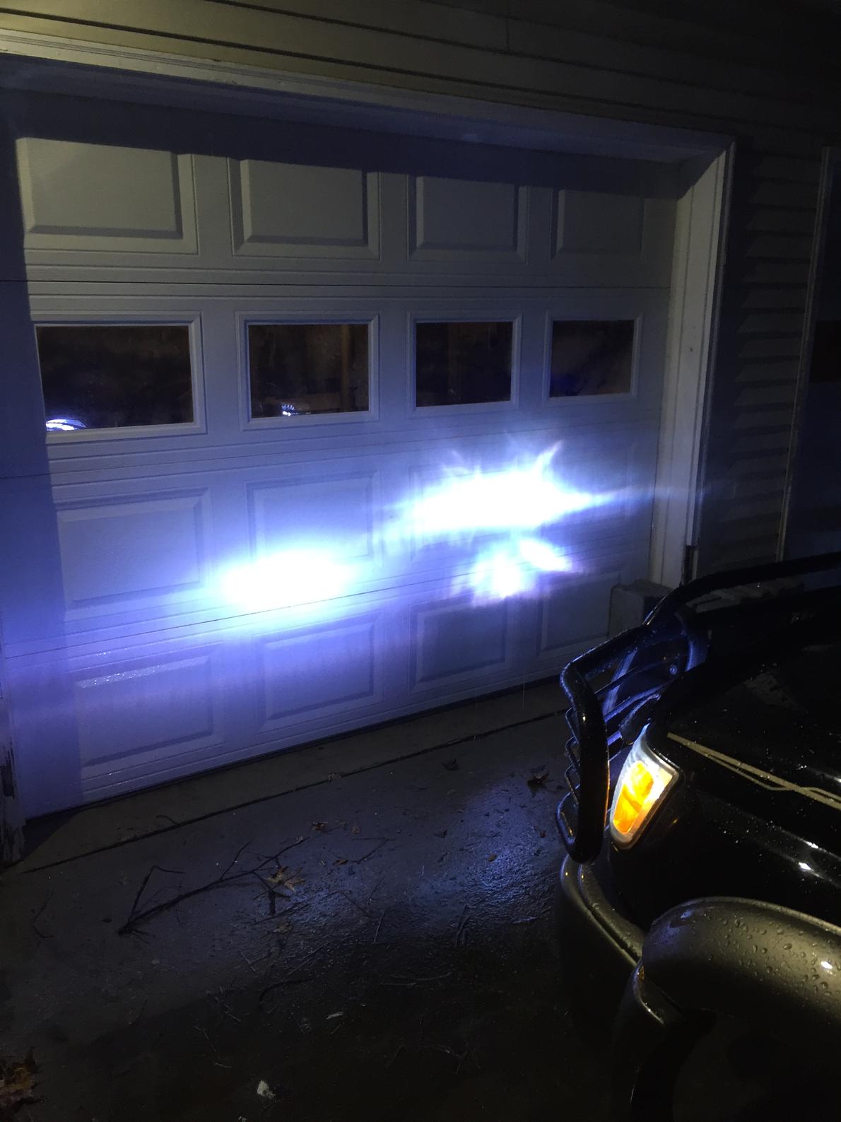

3rd gen. 4runner headlights use reflectors, I put a HID kit in my '99 4runner and I got some crazy reflections. In my picture you can see it. The high beam are halogens and they sucked. After 2 days I returned them and upgraded halogen bulbs.
