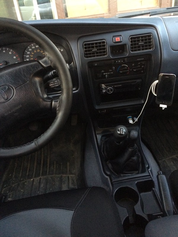

I use this. It's inexpensive, it's small, it works and you can get it on Amazon with Prime for $15. It holds up my Zte Zmax Pro without any problems — which is bigger and heavier than an iPhone 7 plus. It's never fallen off since I've had it.
I have a clear case on my phone so you can see the magnet on the inside back of the phone. Obviously this would not be visible on normal cases. I personally don't care if it's visible. I've since trimmed off that little plastic protective thingy that you can see on the side between the magnet and the phone. Looks clean now.
Scosche MAGDMB MagicMount Magnetic Dash Mount for Mobile Devices https://www.amazon.com/dp/B00I608BJ8/ref=cm_sw_r_cp_apa_Od8Lyb7YVTK7H
I have the same mount in the same place and it works great! I love it

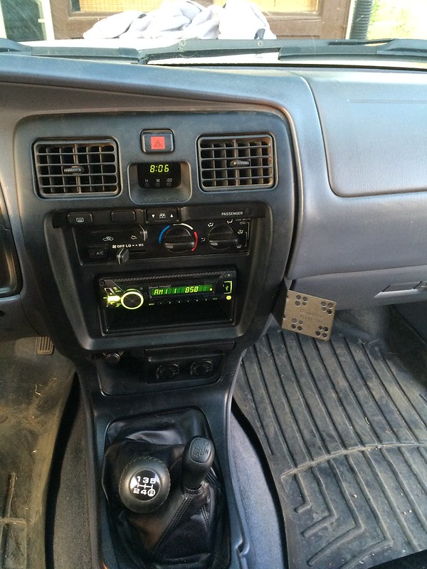

I used a Panavise dash mount combined with the Scosche magnet. The magnet is the same as the one that StreetCreeper used, held to the Panavise with a small nut/bolt. It provides a nice and sturdy mounting point with the convenience of easy removal with the magnet.

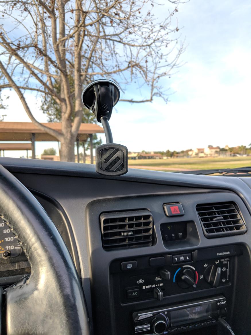

Scosche suction cup mount works best IMO, very strong magnet and its fully adjustable plus you can relocate it. Makes for an easy solution. No fiddling with clamps or clips of any sort.

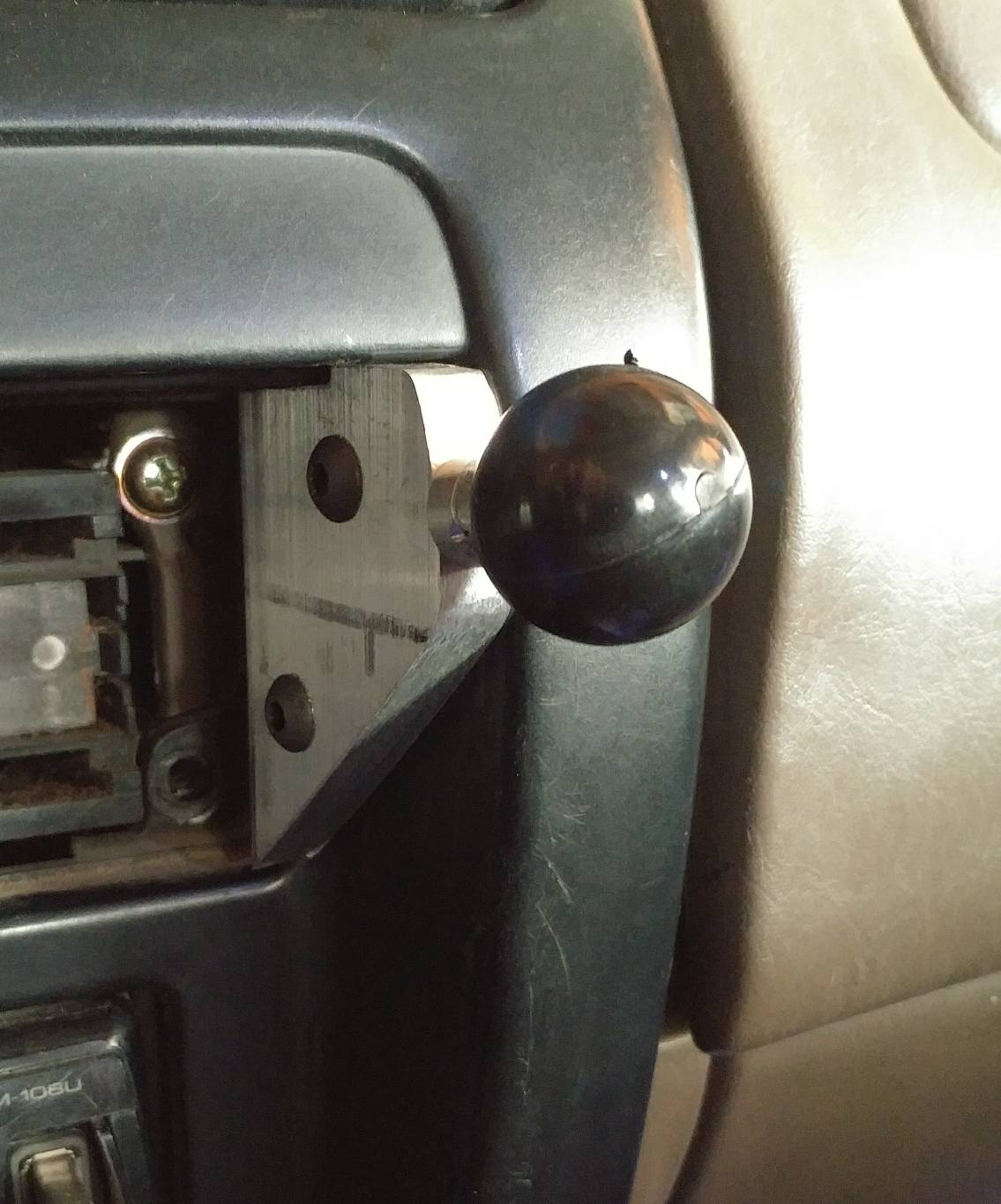

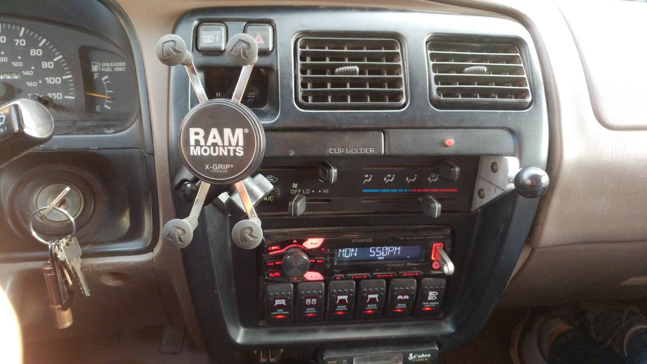

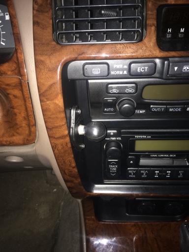

Just finished my very own Ram mount bases, I've been working on this for a little while. Its pretty solid so far. Obviously, I still need to do some painting/finishing...
Sent from my VS987 using Tapatalk
This is a very clean design, looks great! I am curious how it is supported. Any chance you have a pic or can you describe what you are screwing into?
So I made backing plates with threaded holes out of some aluminum flat stock (obviously with the same centers as the mount). One side has two sided tape, so when you drill the holes in the dash bezel, you line everything up and bolt it together from the outside, the backing plates stick to the back of the bezel, then the backing plates just stay stuck to the back of the bezel when/if you need to remove the mount. Basically the mount and backing plate sandwich the Dash Bezel between.
Ive been driving around for the last couple days using the mount with the large Xgrip and my fairly bulky phone every chance I get just to see if there are any problems or last minute changes to address, so far it seems pretty solid

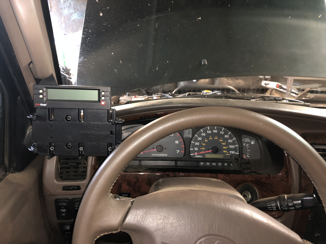

I kind of tried to replicate spikerengineering’s mount (it really is a great design!). I made mine super sturdy and it holds my scangauge + my phone. There is a square washer inside the handle that gives it additional support. I used a ram adjustable mount, holds my iPhone with an otter box case very sturdy.

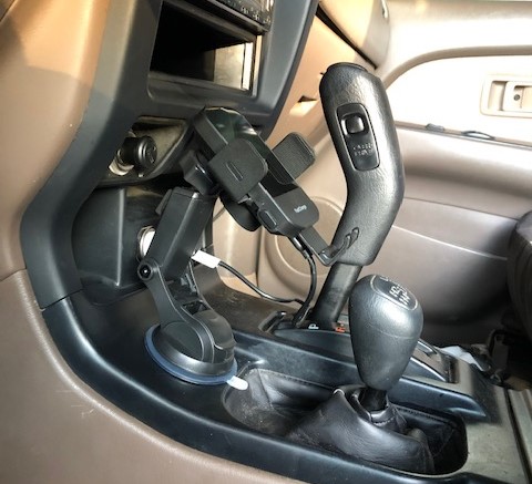

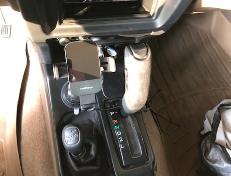

I picked up this little mount from Amazon on Black Friday. It wirelessly charges the phone which is pretty convenient and has a motor inside which contracts the arms to hold the phone securely in place. The only thing I'm not sure about it how the suction cup will perform once the truck is bouncing around off-road but after a couple of weeks of street driving, its still hanging in there so we'll see...
