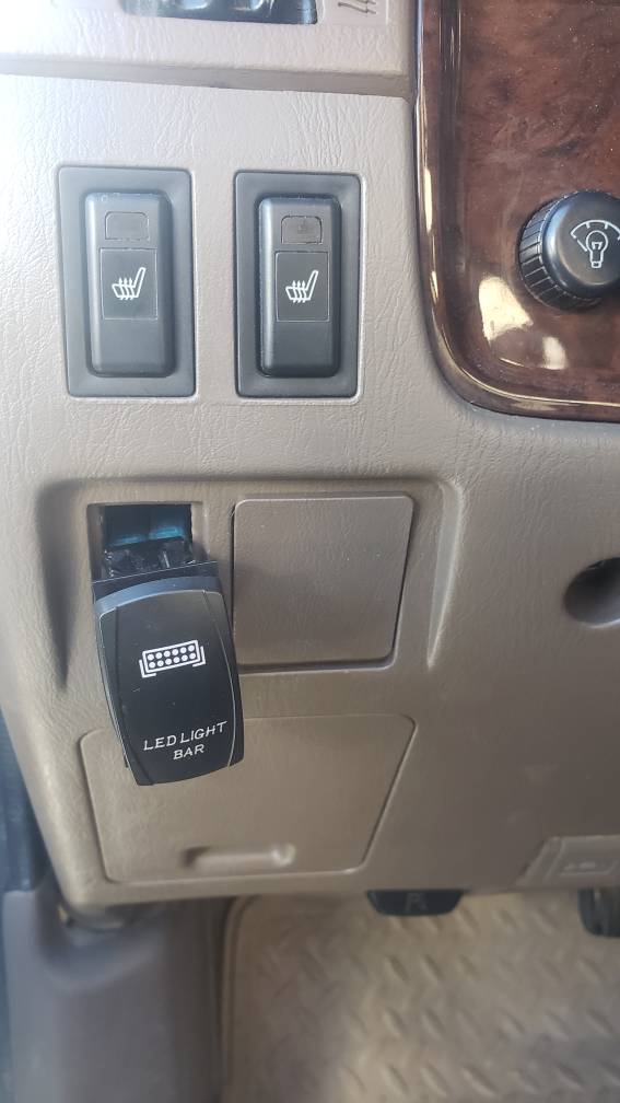

OP I buy these rocker switches all the time on Amazon and they fit fine. It's a tight fit but they DO fit, no cutting required. You need to insert the switch with the top first angled out towards you, then slide in the middle, then the bottom. Here are the switches I have purchased. Here is a image.
Amazon.com: SPOT LIGHTS - Green - STARK 5-PIN Laser Etched LED Rocker Switch Dual Light - 20A 12V ON/OFF : Automotive
Amazon.com: Nilight - NI-RS05 LED Light Bar Rocker Switch 5Pin Laser On/Off LED Light 20A/12V 10A/24V Switch Jumper Wires Set for Jeep Boat Trucks,2 Years Warranty : Automotive
Amazon.com: MicTuning LS081601 5 Pin Fog Light Rocker Switch (ON-OFF LED Light 20A 12V Green) : Automotive
