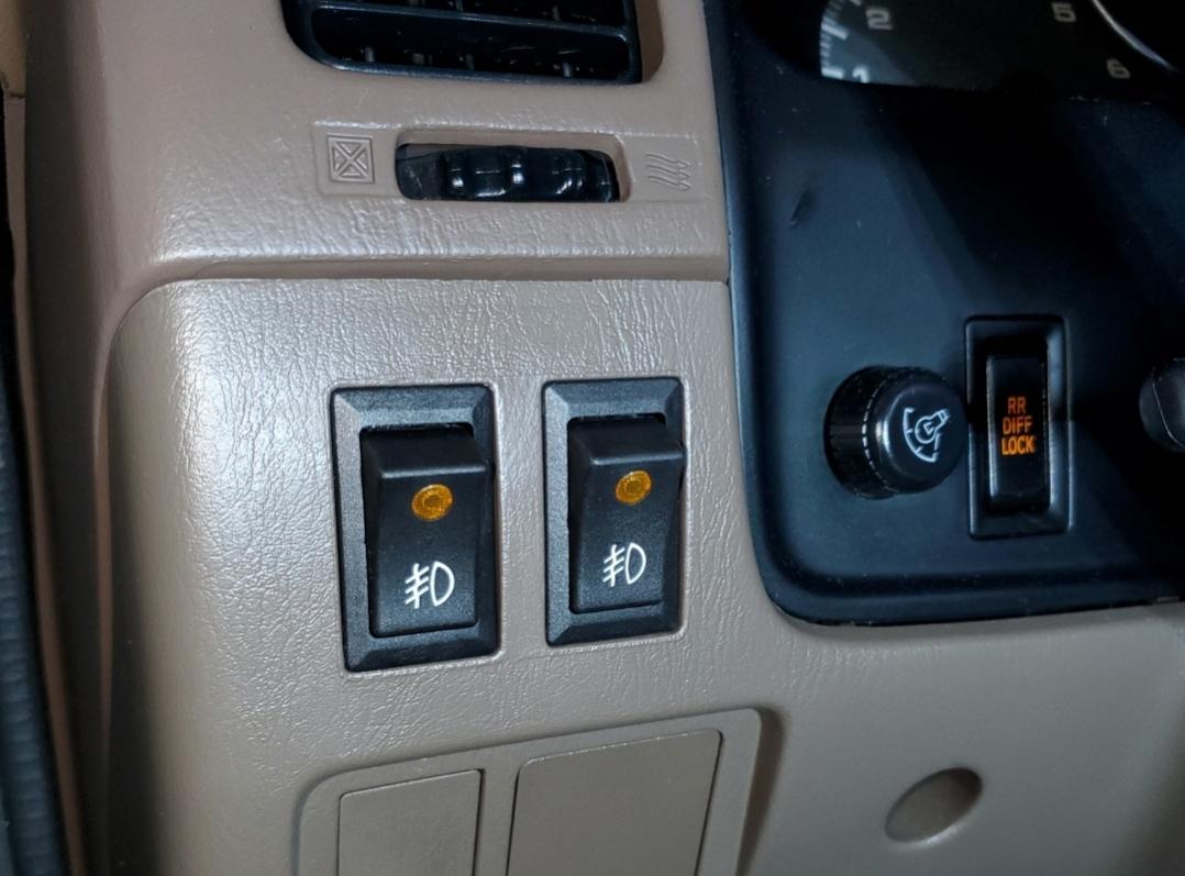

Hello everyone. I just installed an ARB twin compressor, works great. I just now took the ARB switch off and replaced it with a CH4x4 switch as it fits the factory cut out in my 4Runner. I have been researching the differences between the two switches (ARB & CH4x4). What I think I know is that the CH4x4 needs a separate relay and the ARB switch has one built in? The CH4x4 switch is rated at 3 amps and that's the need for the relay. Does anyone know about wiring in a relay to allow safe use of the CH4x4 switch. Some people say that they don't use a relay and it works fine, others say use a relay because the switch cannot handle the power and gets hot...eventually welding the switch together and then the compressor doesn't shut off, and or possible fire risk. CH4x4 says the switch must be run with a relay, but doesn't show what that looks like (other than Red wire 1 connects to the relay). Thoughts on how to use a 4pin spst relay in this set up? I would pay someone to do it for me, but I like to learn as much of this stuff as I can. I really appreciate anyones knowledge and time in advance.

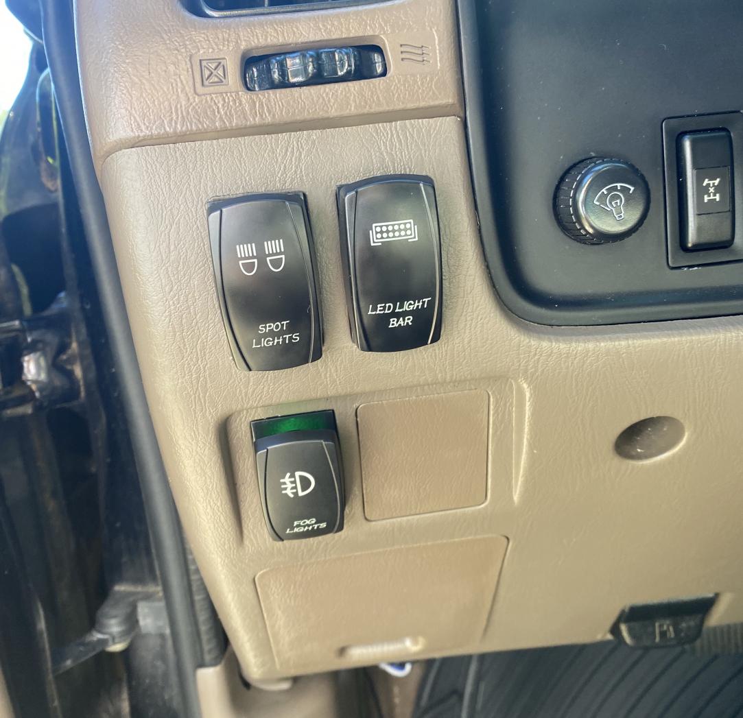

OP I buy these rocker switches all the time on Amazon and they fit fine. It's a tight fit but they DO fit, no cutting required. You need to insert the switch with the top first angled out towards you, then slide in the middle, then the bottom. Here are the switches I have purchased. Here is a image.
Amazon.com: SPOT LIGHTS - Green - STARK 5-PIN Laser Etched LED Rocker Switch Dual Light - 20A 12V ON/OFF : Automotive
Amazon.com: Nilight - NI-RS05 LED Light Bar Rocker Switch 5Pin Laser On/Off LED Light 20A/12V 10A/24V Switch Jumper Wires Set for Jeep Boat Trucks,2 Years Warranty : Automotive
Amazon.com: MicTuning LS081601 5 Pin Fog Light Rocker Switch (ON-OFF LED Light 20A 12V Green) : Automotive
