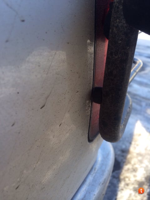

This is very true. The black horse ones look to be identical to OEM in what I consider the most important weakness of the guards, which is that they have no forward attachment point. They are held on by 2 bolts under the rear hatch, so they are basically cantilevered around the light, with just a rubber nub supporting the forward edge of the guard. If you are travelling forward (which we are all quite oft to do), branches and other crap can easily get caught, and when they pull on it, they will just fold the guard back and damage your rear door. I have them on my rig because I do think they look good, but also because I am not hitting any trails. If I were, I would take them off first.

Also yes they are only held in place by the 2 10 mm bolts that hold your tail light in. No forward attachment.
If you do get close to trees or branches ( bushes don't matter, just something that could put some good scratches in your paint). I would not have them.

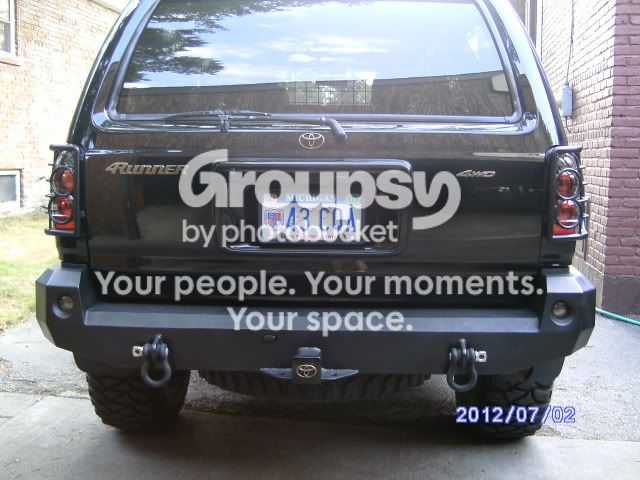

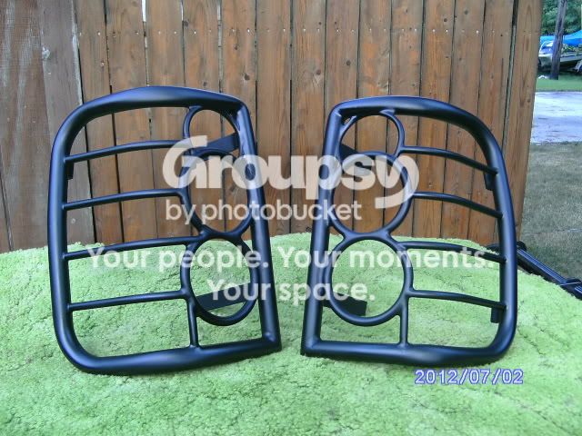

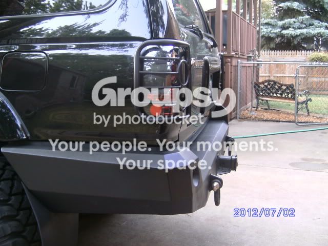

They look exactly like the ones I got from another member here.
this was my 1st post. from another member. it was easy to look over and get lost in my picture, i understand.

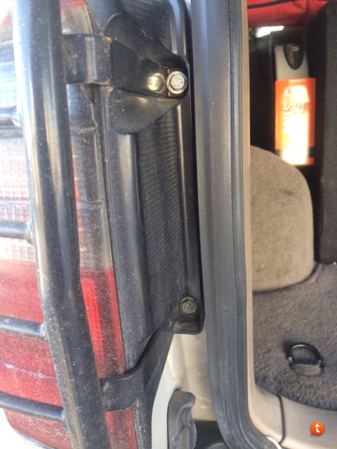

I bought a cheap pair of used ones from somebody on this forum. Then I modified them to match my aftermarket taillights. I didn't like how they only mounted with 2 screws either, so I also welded tabs onto the front-most tube for additional mounting points. I use 3M double sided automotive tape between the extra tabs and the rear quarter panel. They are VERY secure. I do not worry about tree branches ripping them off.
