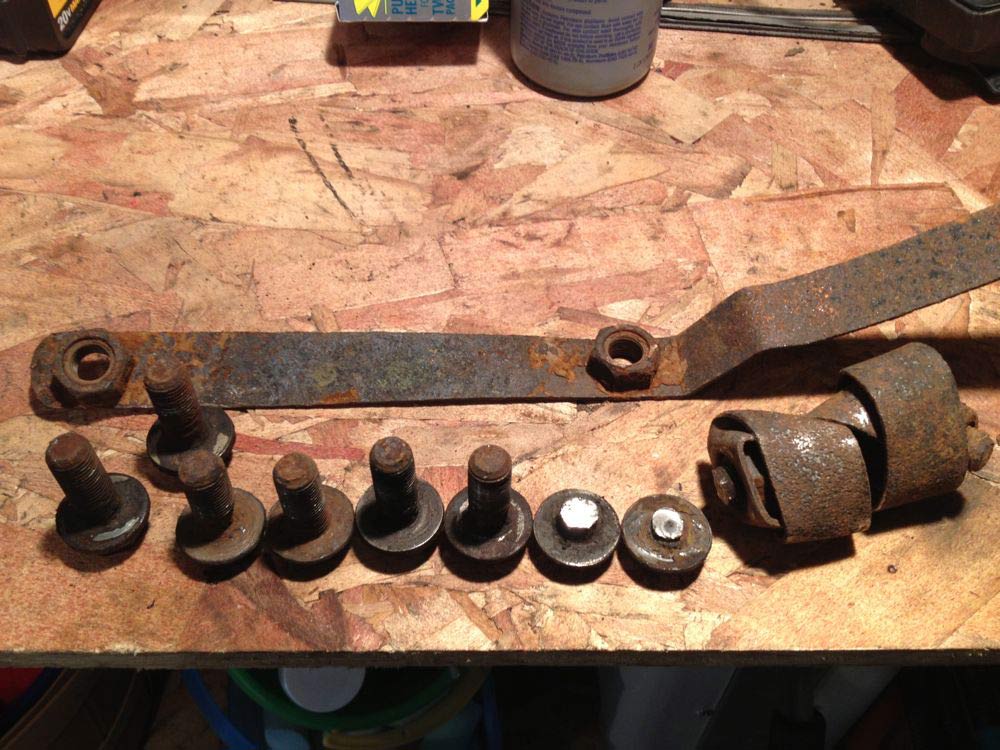

Update - I replaced my OEM hitch today. Mostly went well, but I came armed with an arsenal of tools. Big-time IR impact, PB blaster, MAPP gas, and SawzAll! Those bolts didn't stand a chance. Actually, all but 2 came out with little trouble. However, 2 others weren't so friendly. Lucky for me, they were the ones attached the the insert on the passenger side.
Check out what my impact gun did to the insert inside the frame rail! I love that thing. That's why I ended up having to cut that last bolt off. The twisted up insert was just rotating inside the frame rail when I turned the bolt.
Everything came off though, and the new Curt hitch is on. Looks much better!
