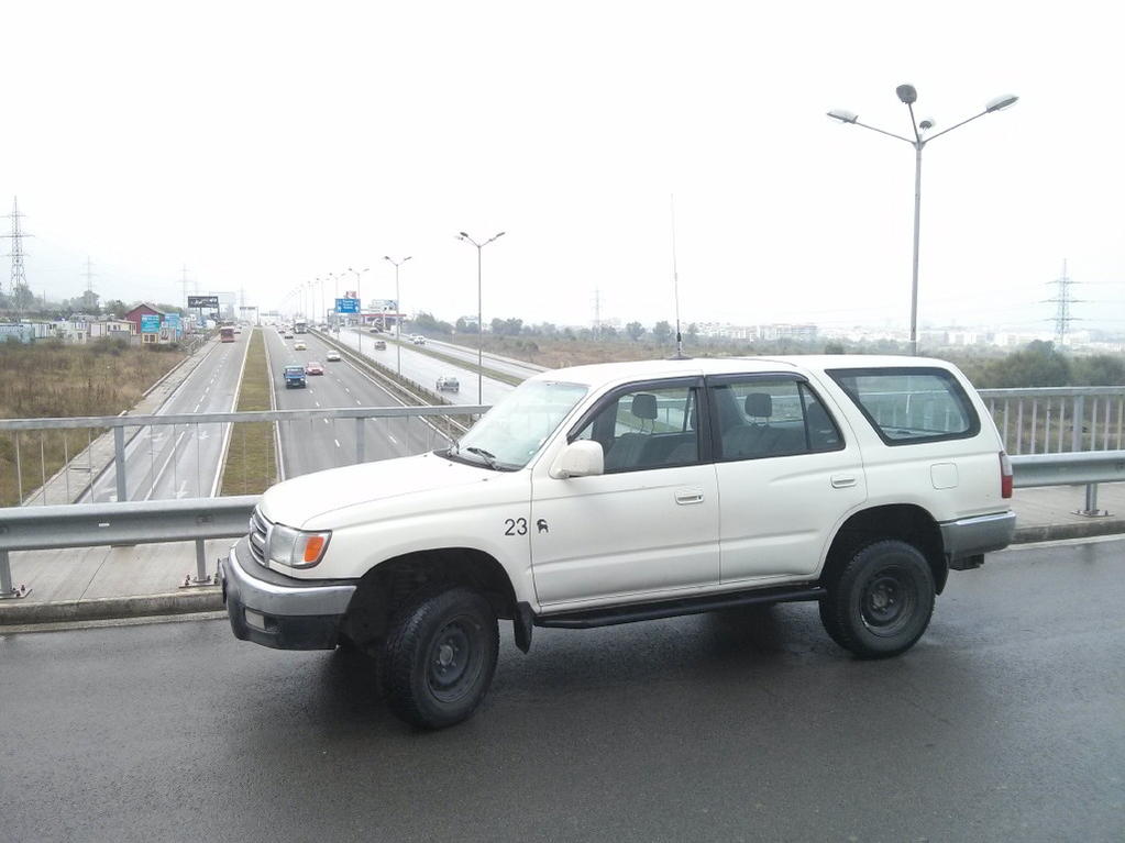

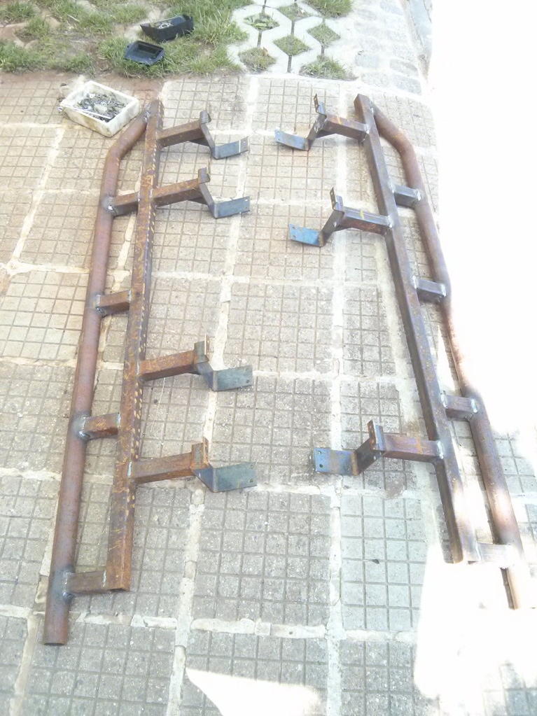

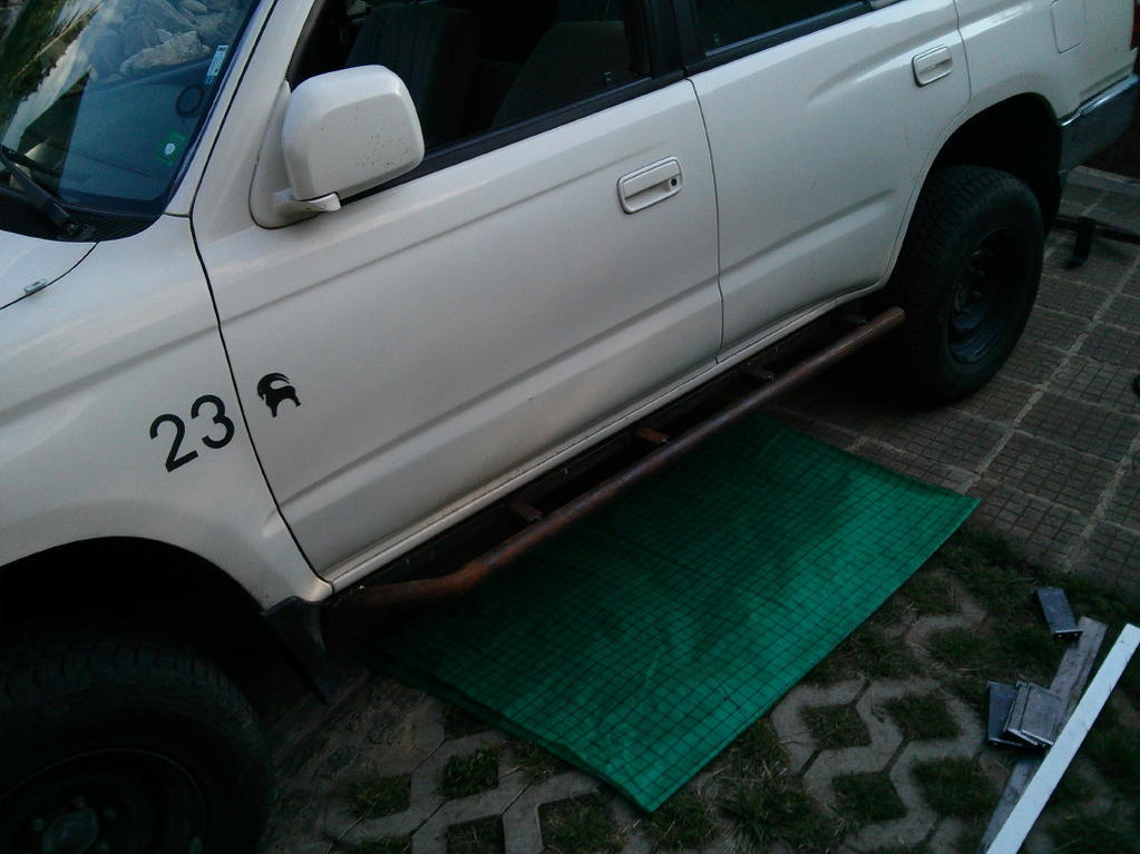

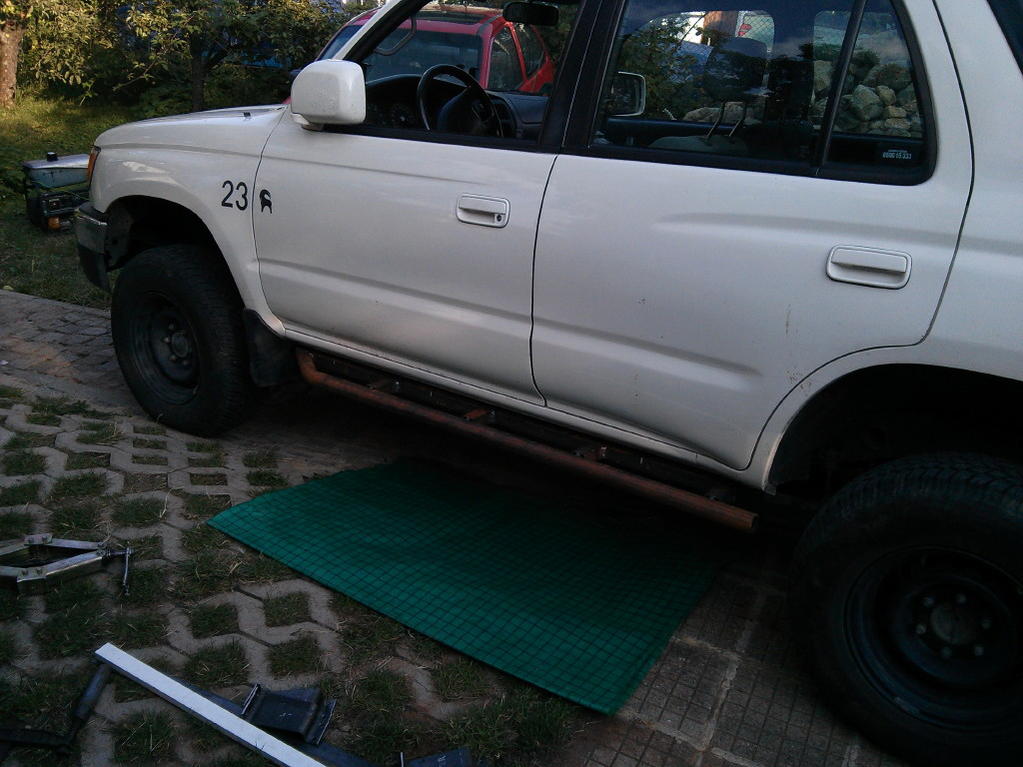

Here are a few pics of the sliders that I have. They are bolt-on without modifying the frame.
I have lifted the car with a hi lift jack and they hold very well.
Only problem is that they are slippery. They are due for a paint job...again, so I will weld a few dozen pimples on the top part, so I dont kill myself while standing on them.
in the first picture, the left slider is the right one, and vice versa!
