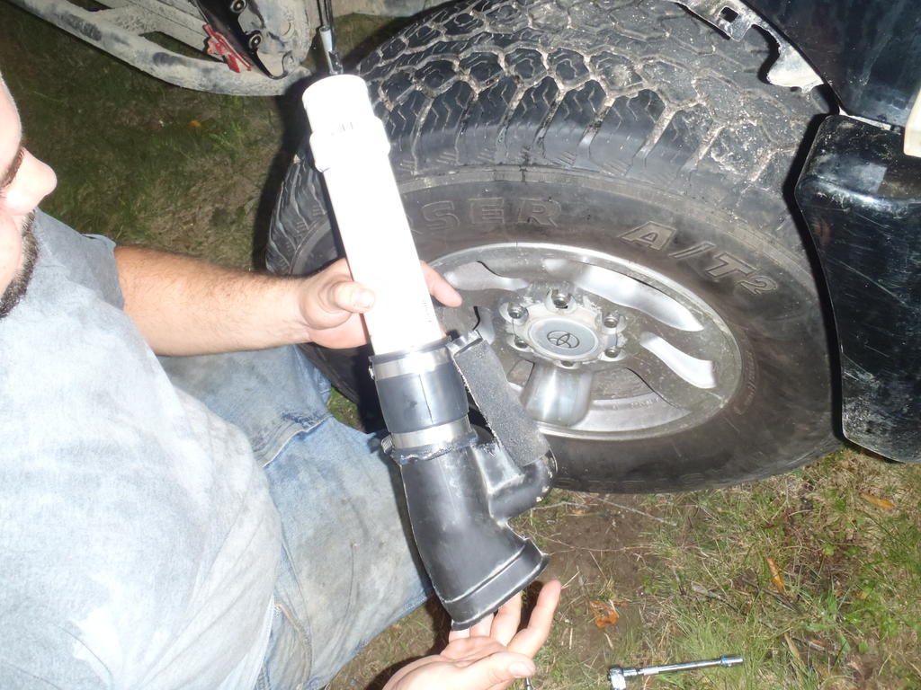

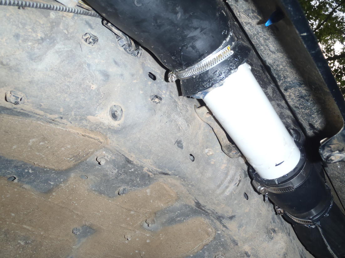

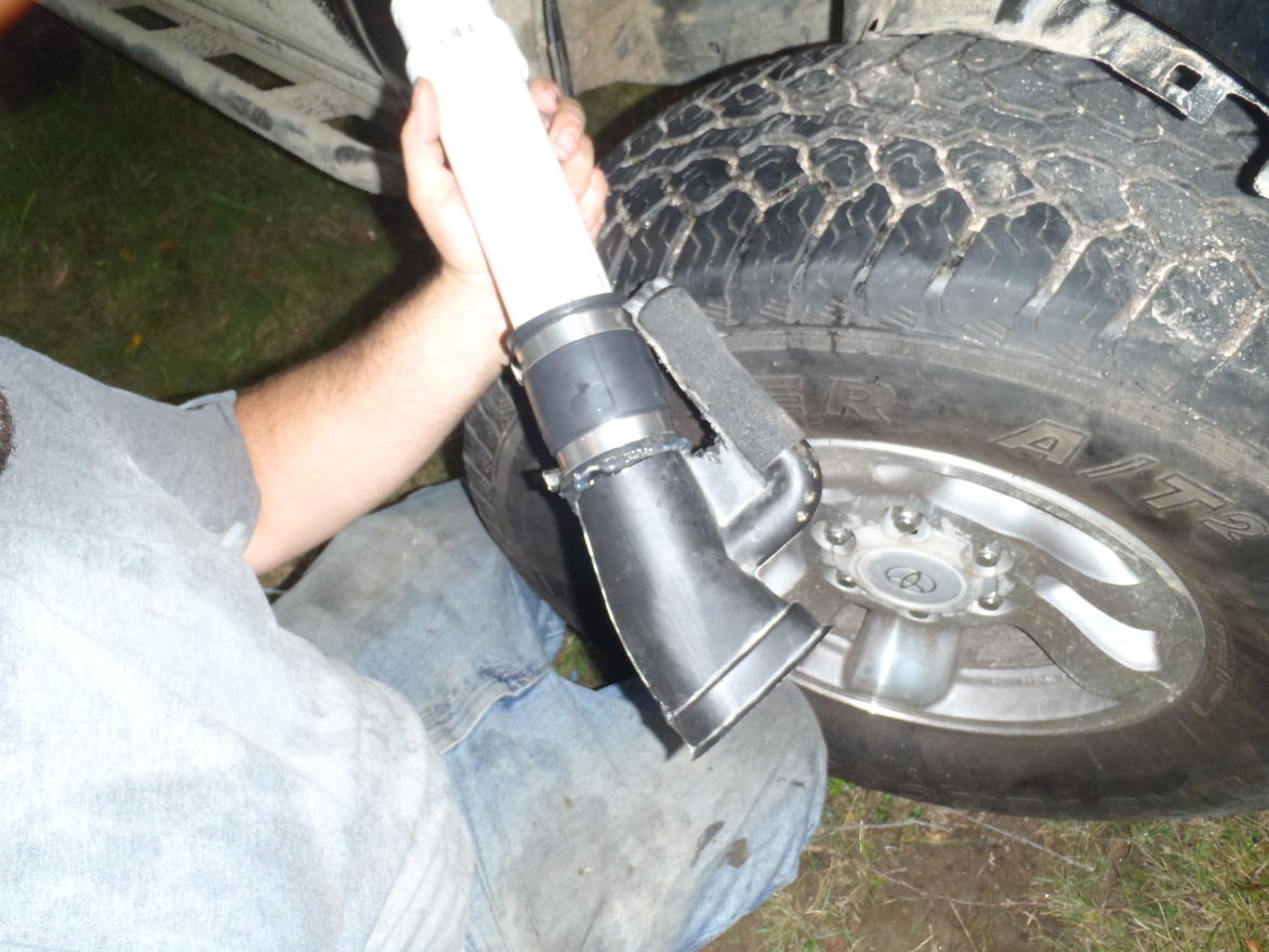

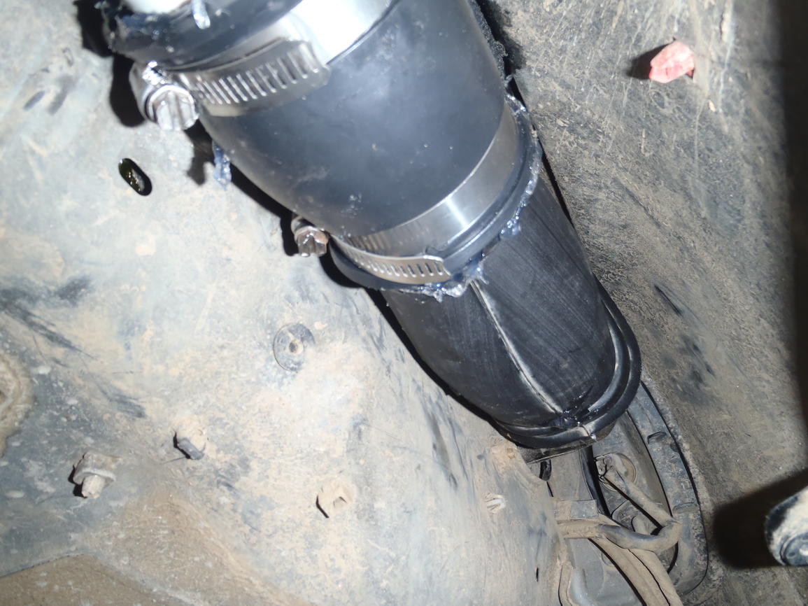

ok it was realtivbitly easy i used a 2" fernco fitting andf sawzawed my factory airintake down a few inches and uses 1.5"pvc to meet up with the safari fernco type elbow fitting and a 1.5'x2' pvc coupling and screw clamps all is buried in the fender and i sunk my truck 2 weeks after install and no vapor lock!!!!

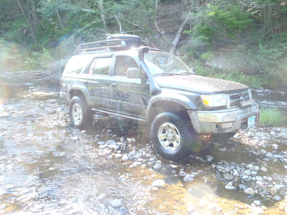

Finished product picture?

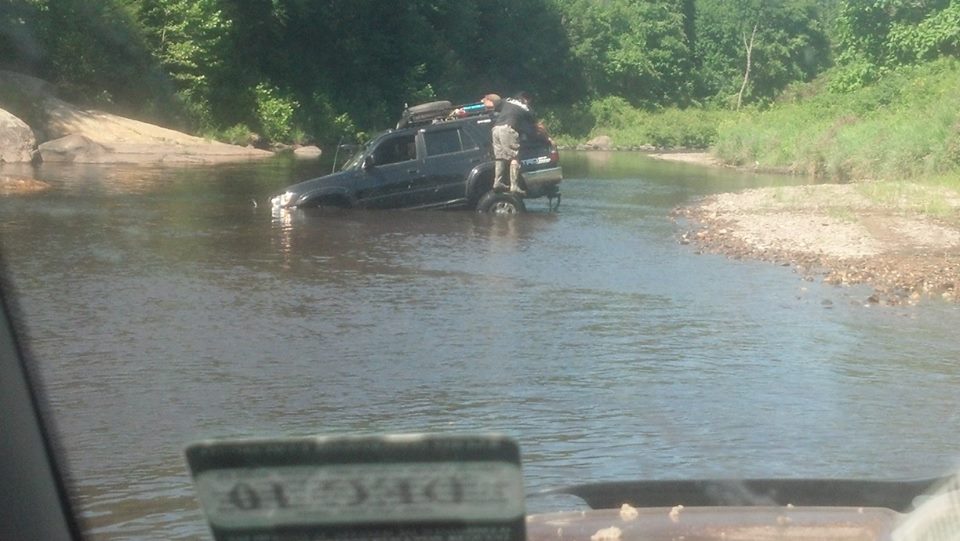

sunk

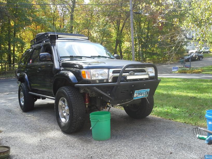

2 weeks after the snorkel install i went to turn around in the salmon river and I didnt see a deep hole, truck stayed running as i got stuck and called out to my buddy josh to come pull me out!!! he has a video opening my passenger door and tons of water pouring out safe to say the snorkel worked and no vapor lock so worth the investment!!!!!!

If you went deep enough to get water in your cabin then you may want to make sure water didn't get in any of your fluids.
