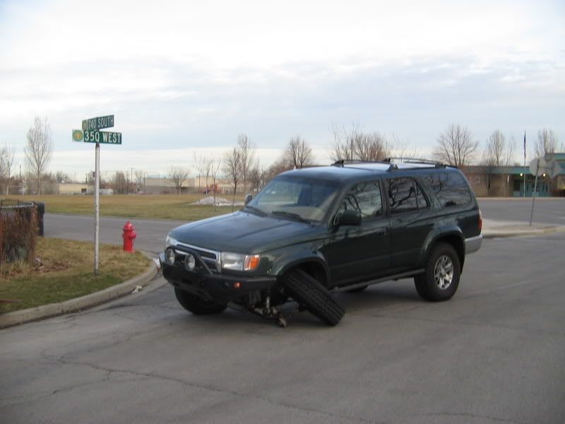

What do you mean by wobbling? Your front wheels? Please check your LBJ's. They can fail if not replaced when showing a little play. Hell they can fail without any play! I wouldn't even drive it until you can confirm the lower ball joint isn't coming apart. The wheel can fall right off your truck. Consensus on this forum is that LBJ's should be replaced with OEM ONLY no Moog or other cheap crap, every 100K miles.
http://www.toyota-4runner.org/3rd-gen-t4rs/149467-official-lower-ball-joint-write-up-thread.html
If wobbling is not the correct term then we can talk about other parts that need to be addressed.

Scramble, by wobbling I mean the entire body will start to sway side to side like rocking motion if you were sitting on a large exercise ball in the gym. I'll check the LBJ's. My guess is they have never been changed. Do you have to replace the entire LCA on these or just the BJ? Bolt in or rivet in?

Please change them. Just the LBJ, it's 4 bolts - no chiseling off the rivit's like the old days. LOL see the link I provided above.

Oh yes, that's definitely rear LCA bushings. That sway can get very violent. Check the current LBJ condition. If you see grease built up around the boot then it's likely in need of replacing. I wouldn't call it urgent since the sway is from something else.
Wow...thanks for the input guys and the parts link too. I had been buying some parts from toyotapartsdeal or something like that. BTW, that earlier pic is scary. Ill be checking over everything this weekend for sure now...

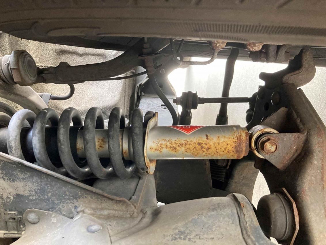

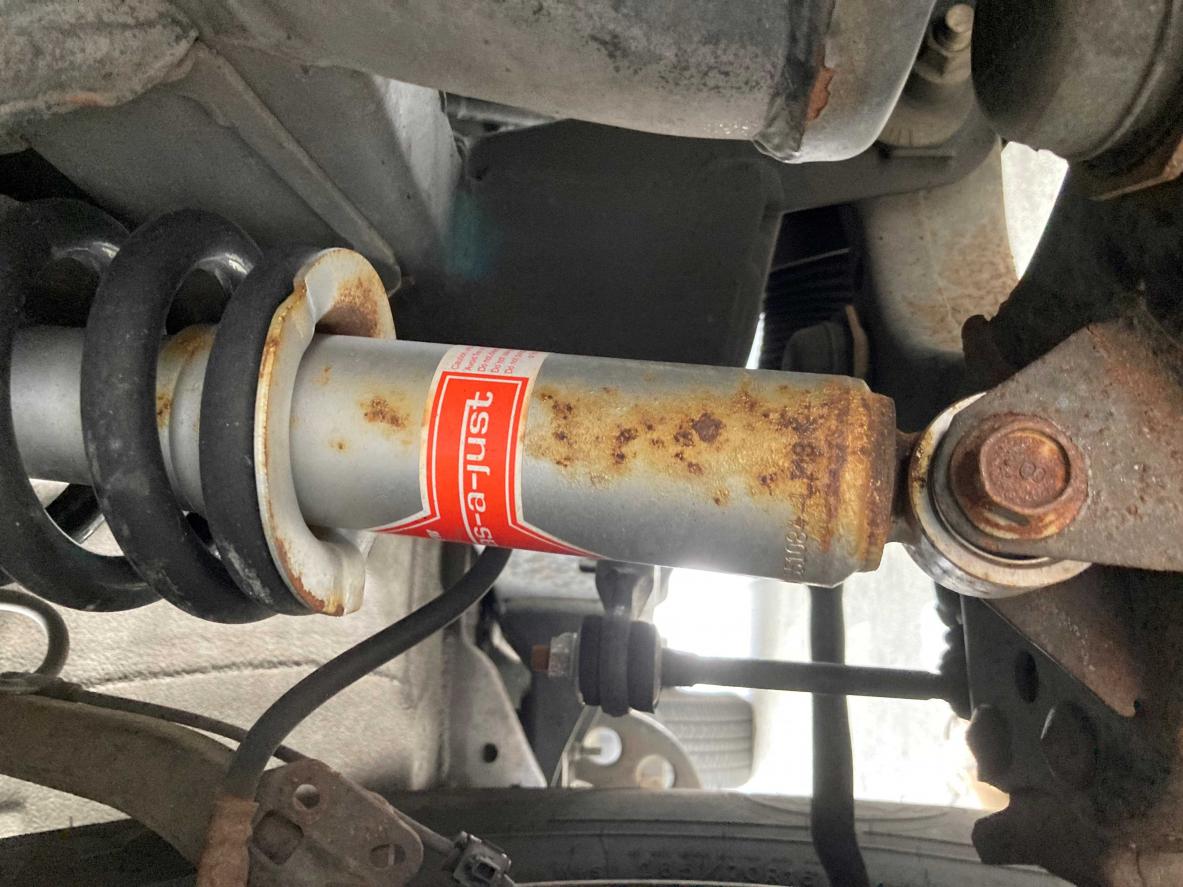

I replaced all 4 corners last April 2022 on my 2002 SR5 RWD with KYB.
Model KG9025 front 565002 rear. The ride is about the same as previous, I'm now sure what was replaced, I think OEM w/190K miles.
Anyway my concern is that the housings on the new parts are starting to rust. Pics are from Jan 2023 after about 9 months in Southern California, no snow/salt or even much rain. Is this normal?
The ones I replaced were leaking fluid but not rusty.

Looks like surface rust to me but I wouldn't worry too terribly much. It's probably just a cheaper metal to produce. If it gets bad then I'd start to get really concerned. It does seem a tad bit strange though.

I had the same rust with KYB's in sunny southern CA after only about 6 months. It was just surface rust, but looked terrible, so I sold them on Ebay and bought some Dobinsons. KYB must use the world's cheapest paint, I can't imagine how they look after a few months in the rust belt.
