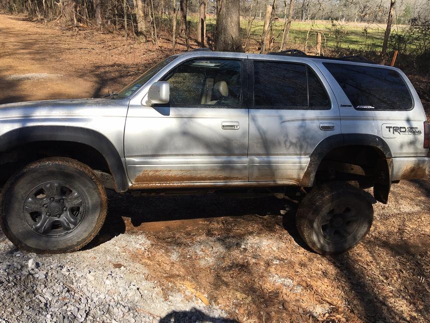

Whooops sorry about that. Well $50 was great $40 is even better. Either way you got a smokin' deal. I think the last time you saw my rig I had the 891s in the rear and there was no rake. I have a massive rake now. It's ridiculous lol. I think I'd like to go back down an inch for the rear but I'm going to run with it a while to see how it works. Moab will be a good test if we make it out there this weekend.
Ok, I get you now. Yeah, those springs give a CRAZY rake. But the way you and I run our trucks, it will only help with rear clearance. I think I will have a hole in my tank soon from all the extra flex LOL!. Gonna have to do that tank conversion for sure. So are you still running the Bilstiens on the rear? I tried to put the OME extendeds on there. They were already fully extended, so I went with the LC's.
Let me know what happens with your rear tires. I wasn't quite planning on running the 305's, but right now my 265's rub the rear of the fender well pretty hard in certain flexes.. It's had me a little wary about the 285's without a little help from my sawz-all.
If we can get this setup perfected, we may just start a fad on this site. LOL! Have fun in Moab, I'm so jealous!

Yep, I'm running the Bilstein 5100s in the rear. It's about an inch longer than the 5125s. They are 24" shocks. It doesn't let the coil fall out and I think they would be good for a 4 inch lift in the rear. I wanted the 5 to clear the lower rear control arm mounts but I'm talking to Toytec and we're in the plans to see how expensive it will be to have a custom coil made off the 891 platform that will be a 4inch lift. Based on the little wheeling I've done with the 851s I think the extended 891s will be a perfect match.

Well, it wasn't my intention to blaze a trail by modifying, but I am glad it worked out this way. I got these springs by mistake from a wrecking yard. The owner and I didn't realize what they really were. The LC was laying on the ground with no rims, a victim of fire.
I have no build thread, but am glad to help. Before you do this, let me warn you of some things:
1. Your drive shaft will rub the gas tank and it's skid plate SEVERELY! I highly recommend you remove the grease fitting and replace it with a flat plug. I broke mine off on the very first flex. I will be doing the Isuzu gas tank relocation mod soon.
2. You will need to get the extended brake line. I currently have my extended one connected to my factory flex line. (At least until I can do some measurements at full flex. At this point I will probably have a custom one made.)
3. I had to remove the E Brake cable bracket located mid gas tank. After lifting, my cable was tight and caused the rear brakes to drag.
4. Extended rear swaybar links will be a MUST! Stock ones will max out your rear swaybar. I currently have no rear swaybar. I will be manufacturing my own swaybar links.
Are you planning on doing this on the ground, or at a shop? Let me know and I will give you more instruction.
I got the WABFAB ones, just make sure when you install them do not follow my lead. I figured with my relocation bracket 1" higher and the 4.5 lift I have, would be to set them at 3.5 longer then stock (thought this was most logical). This let the sway bar sit nice and level, but also only a half inch above the lower link arm. First dip I went through I left a slight mark from contact and was very happy I didnt bend my new End link.
You will need to put one wheel at full stuff then set your end link length from that allowing just enough clearance that it doesnt hit the lower link arm. Problem with this is doing this in a stable enough manner you can safely get under the vehicle. Also reaching from the nuts to adjust properly is a major PITA.

All the Co4Lo guys I have met say that the tank rub is normal. However, this much lift will make it worse. I'm told they have spoken nicely with their mallets, still rubs.
I'm told an Isuzu gas tank will fit where the spare tire used to go. With only about a 1 gallon loss in capacity. I plan on doing this and adding armor.
You will have it easy doing this in a garage. I used a hi-lift jack, a floor jack, jackstands, and several large blocks of wood. I would only lift the rear. You will need to disconnect the E brake bracket, rear swaybar, and rear shocks. Make sure you install the extended brake line first! This should give you enough drop to pop the new springs in. If you can flex it enough on one side (with the vehicle in the air) with the floor jack, you shouldn't need a spring compressor. I had hell positioning the compressor just right to be able to install AND remove it. I have done several spring swaps, but the 4Runner design is the least compressor friendly design so far.

I to have the gas tank issue with the superflex coils. The drive shaft is digging into the gas tank skid plate. Even going into a driveway at angle. Could also have to do with my one side sway bar link being broken!
