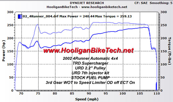

From some info ive read on speedys blog Project SportRunner he had his dyno'd with 7th injector and 2.2 pulley. He put down 240rwhp and 260rwtq. Assuming 20% drivetrain loss that's 288hp and 312tq at the crank.

any dyno charts showing those numbers?
it would be interesting to see where that power is, compared to the v8.
The numbers for the supercharged 7th injector and 2.2 pulley came from speedy's blog. There is a link to the website above and their is a dyno graph posted. I have not seen a dyno graph for any stock 4th gen V8's but if I dig around maybe ill find one.
I too would like compare the graphs to get a much better idea of where the power is and how the curve is shaped. It gives a much more realistic representation of performance than just comparing basic numbers.
Project SportRunner
