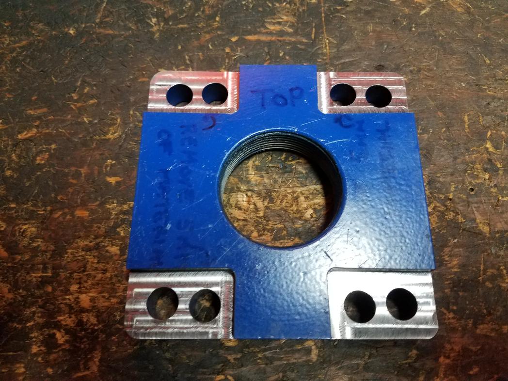

Another special tool you'll need is an axle tool like Durasolid makes.
https://www.durasolid.com/product/axle-bearing-puller-toyota/
This tool is well-built but it also has it's issues. The tool plates are really beefy, 3/4" thick, which is nice because they will probably never bend or break. But, when you put the plate down over the bolts on the back of the brakes, the studs barely stick out the other side. So, you're only able to capture a few threads. This was fine for the first 3 axles I did press work on. The 4th was a disaster because the force needed to press the axle through the bearing was more than the threads could handle on the studs and they stripped out and the assembly came crashing to the ground. I figured out two possible fixes for this. You either pound out the OEM studs and do the press work with longer M10 bolts so you can capture way more threads with the nuts or you can take the plate to a machine shop and have them alter the plate for you so you can capture more threads. I had a shop take 5mm of material around the bolt holes in each corner so the press will work with the OEM studs.
You'll also need a bearing splitter unless you plan on cutting off the ABS gear and inner retainer. I bought this kit, but there are probably more affordable options or maybe you can rent one of these at an auto parts store.
https://www.amazon.com/gp/product/B0002SR47M/ref=oh_aui_detailpage_o08_s00?ie=UTF8&psc=1
We also used press sleeves at different parts of the press work but you could most likely replace those with a piece of pipe or whatever else you can think of. I've learned there's lots of different ways to accomplish the same task when doing press work.
If you can wait a 1-2 more weeks for the videos, Sean will probably have them edited and ready to load onto our channel. I cover the issue with the Durasolid tool and how I addressed it.
This is how I altered the Durasolid plate to make it work much better with the OEM studs.
