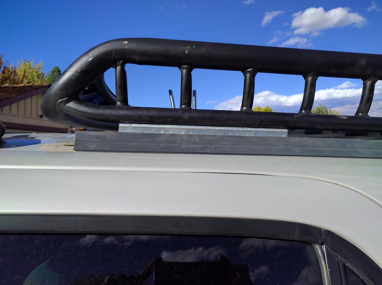

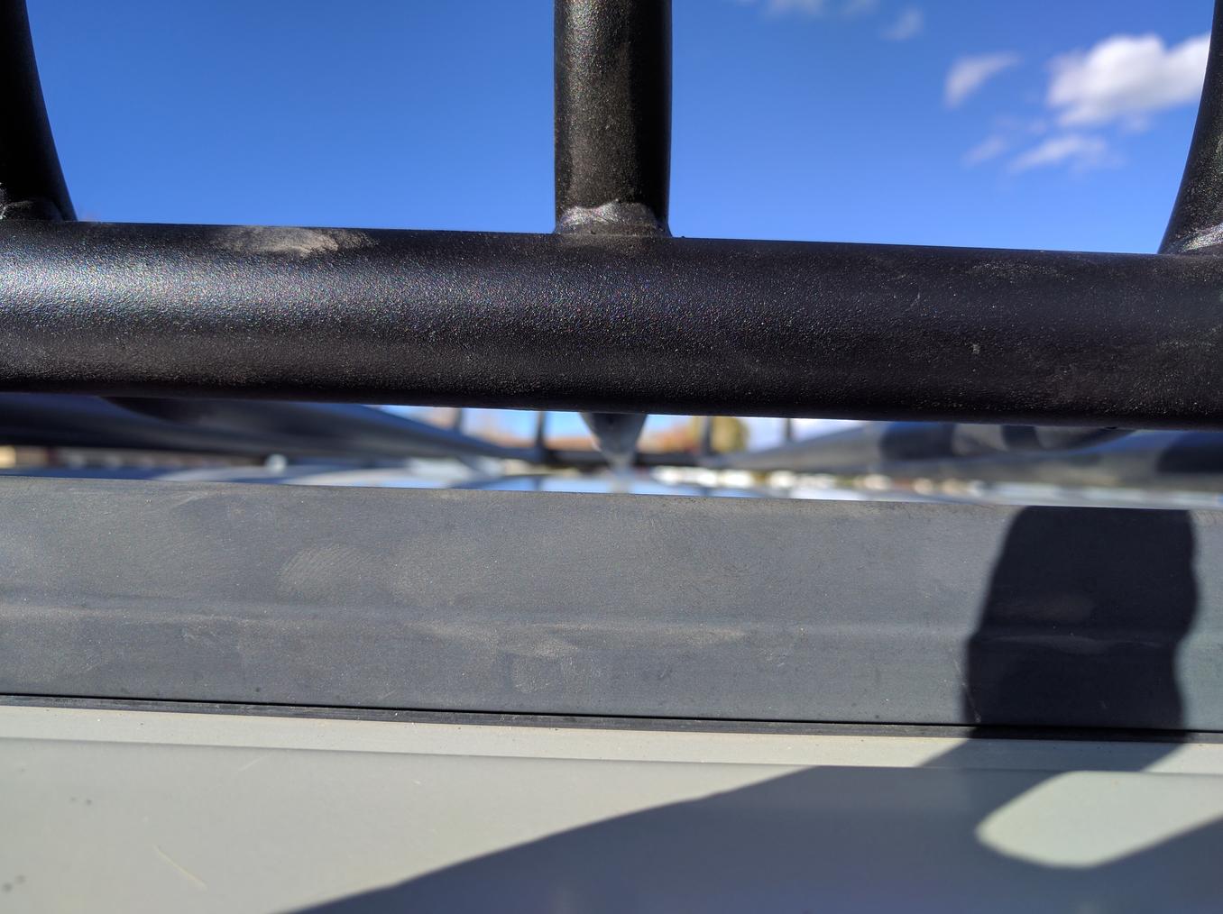

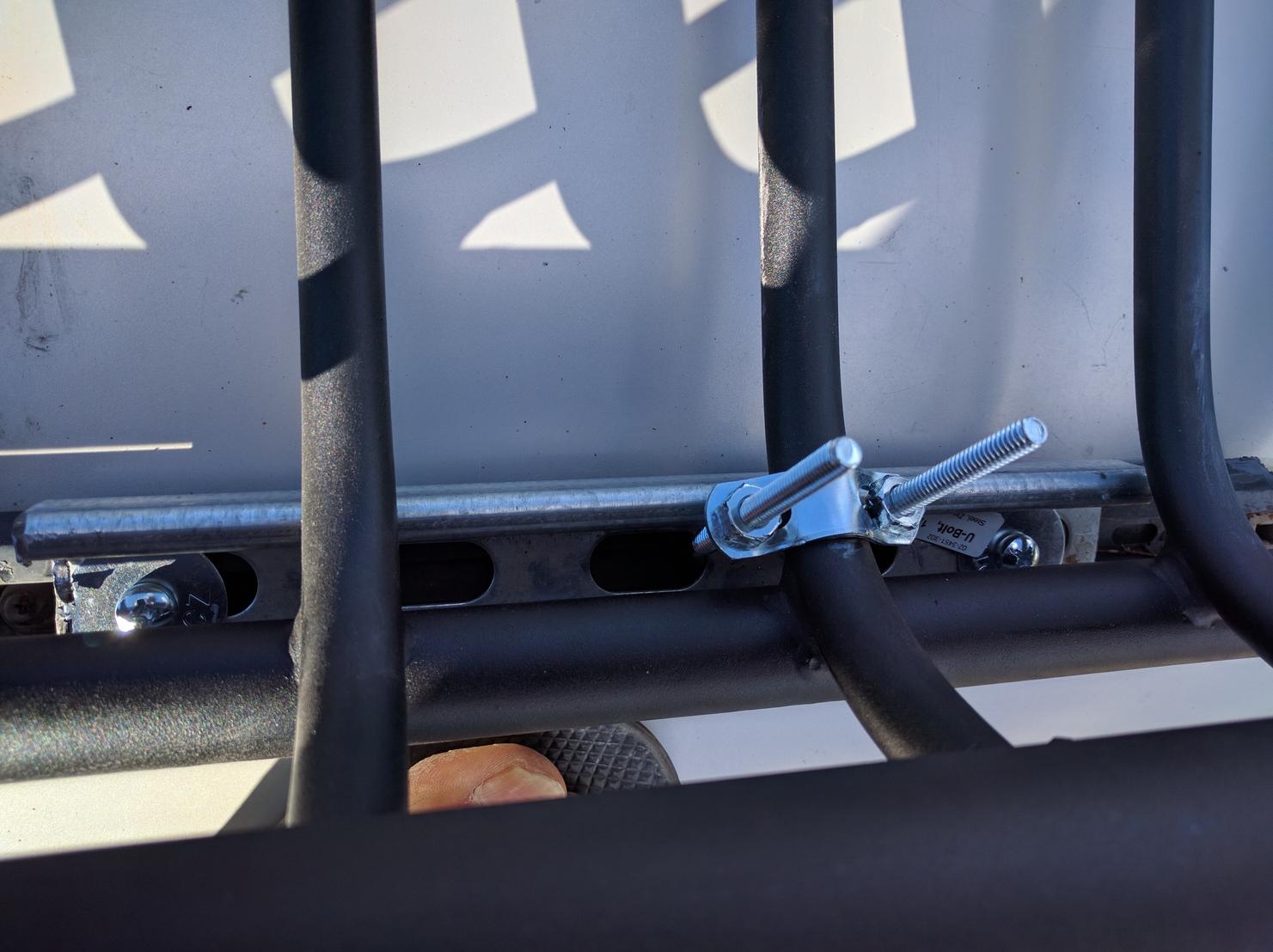

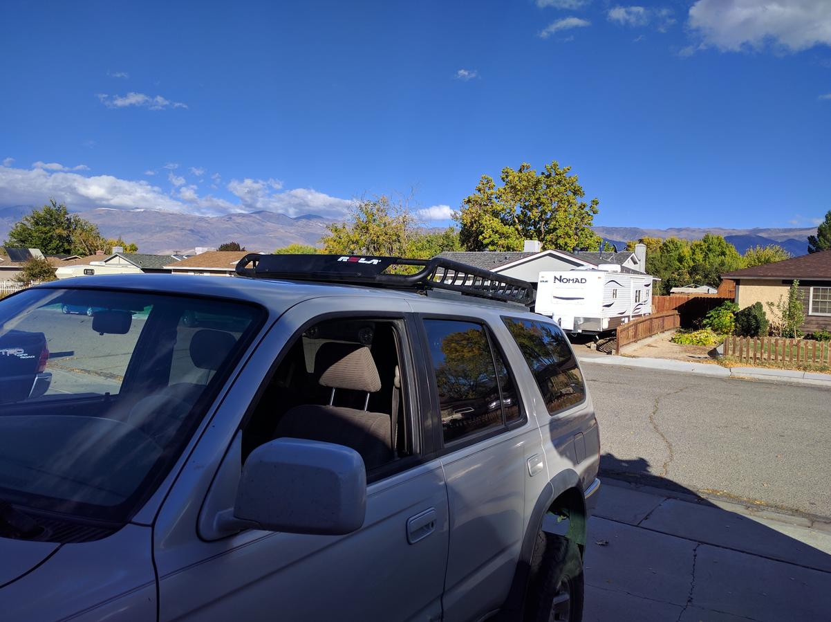

Low pro Rola mounts can now be crossed off the list. Not bad for an hour of my time and 10 bucks in parts. There's about 3/8" clearance from the basket to the roof doing this way. I don't think you can get much lower. I stood in it and shook the vehicle. It's still attached so I'd say the mount points are bomber.
