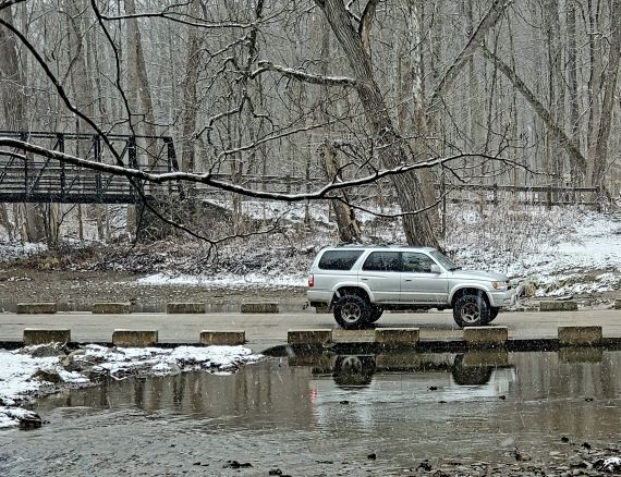

Ohio, Cuyahoga Metro Parks New Lift for Christmas FN wheels and Tires

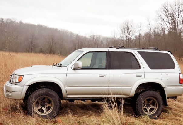

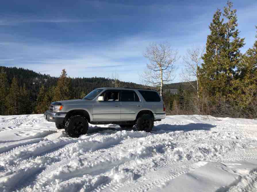

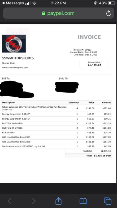

Pics and buils sheet
Here are a few more pics and my build sheet... I share this so you have the exact part numbers and parts installed on my 2001 SR5. Everything worked and fit great, took longer than expected... unlike Timmy's video's which are great btw., we dealt with rusted frozen broken bolts and replaced a bit more of the suspension parts in the process of doing the job... Things broke... be patient it's not that difficult. I used a lift so that was the great part.
For anyone who critiques the parts list or prices, I don't care... THis guy who built a similar rig and has an emerging parts co. was great... just a phone call away even face time. Well worth the time with him and to buy the parts from him... Especially when puzzled with the coils in the compressor, we were way over compressed... a time bomb on the bench.
The FN wheels were purchased direct from FN

Thanks for sharing [MENTION=352108]gmjr99[/MENTION]. Great info and it looks fantastic. Good to know about the coils. Checked out the sswmotorsports page and I think I see what you mean by "emerging!"

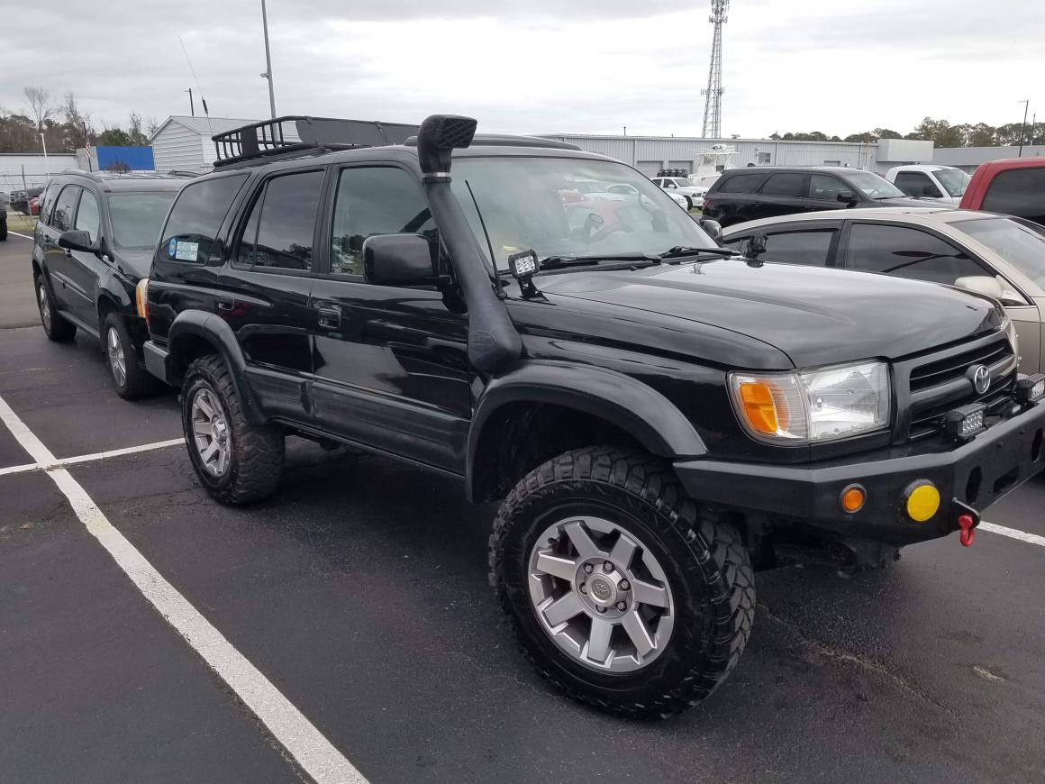

OME 891 in rear and their coil overs in the front. Sonoran steel panhard. 265/75/16. Locked rear.
Excellent thanks for the quick reply!
No problem...that's what you get when work is slow! Also all sorts of other small goodies like bushings, extended rear SS brake line, wheels off a 4th gen Tacoma (I believe) powder coated. Nothing outrageous but she definitely gets me where ever it is I need to go.
Hopefully you're using the time to plan your next adventure. She looks great and it sounds like a nice set of upgrades. Cheers.

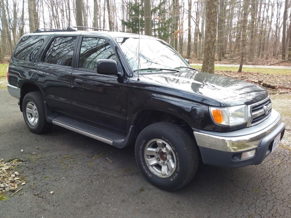

Just picked up this '99 over the weekend from a friend. So far i'm loving it! It's in good shape and has been well maintained. Looking to trade for some 5 star limited wheels if anyone is interested!
