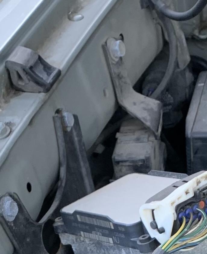

The dealer used the Service tool which uses a different sequence. But moving the levers might help. I think you do have to move the door switch twice instead of the 10 or so times. You would have though the Tech would know that. :-(
I have been reading a couple of threads and it looks like I have the keyless entry as I have the wireless buzzer in the engine compartment.
I will keep bashing away.
