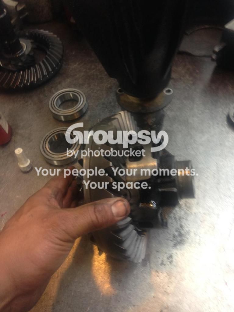

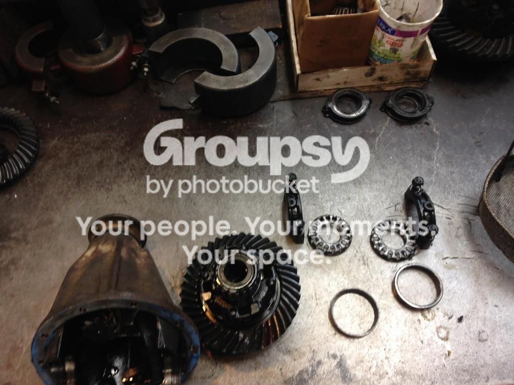

I've rebuilt my own diff and have done diff repair for some customers before.
IMG_20150618_174909_zpsjuuhjd5x.jpeg~original
5.29 install...
IMG_20150618_175033_zpsk5ttecjd.jpeg~original
