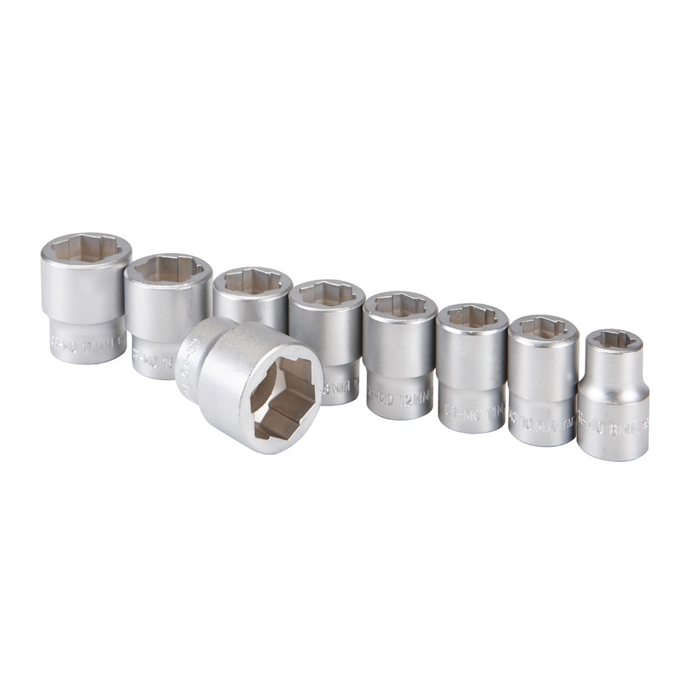

You should have PB blasted everything a month ago when you planned this project. I usually spray WD40 the week before & then the night before I start on something. 6pt deep impact sockets work well for me. I also bought this bolt/nut extractor set over the summer for one nut I destroyed on my oil filter housing. Worked on the first shot.
9 Pc 3/8 in. Drive Metric Bolt Extractor Socket Set

The sad part is I did soak them with PB blaster about the time I started this thread. A couple of times as it was just sitting there. I think in this case I am asking a little much of PB blaster as the nuts are in very poor shape due to rust. One of them is actually hard to distinguish as a nut there is so much rust.
Thanks for the tip on the extractors. I think I was actually looking at this exact set online at HF last night. We have a local store and I think I have a coupon.
