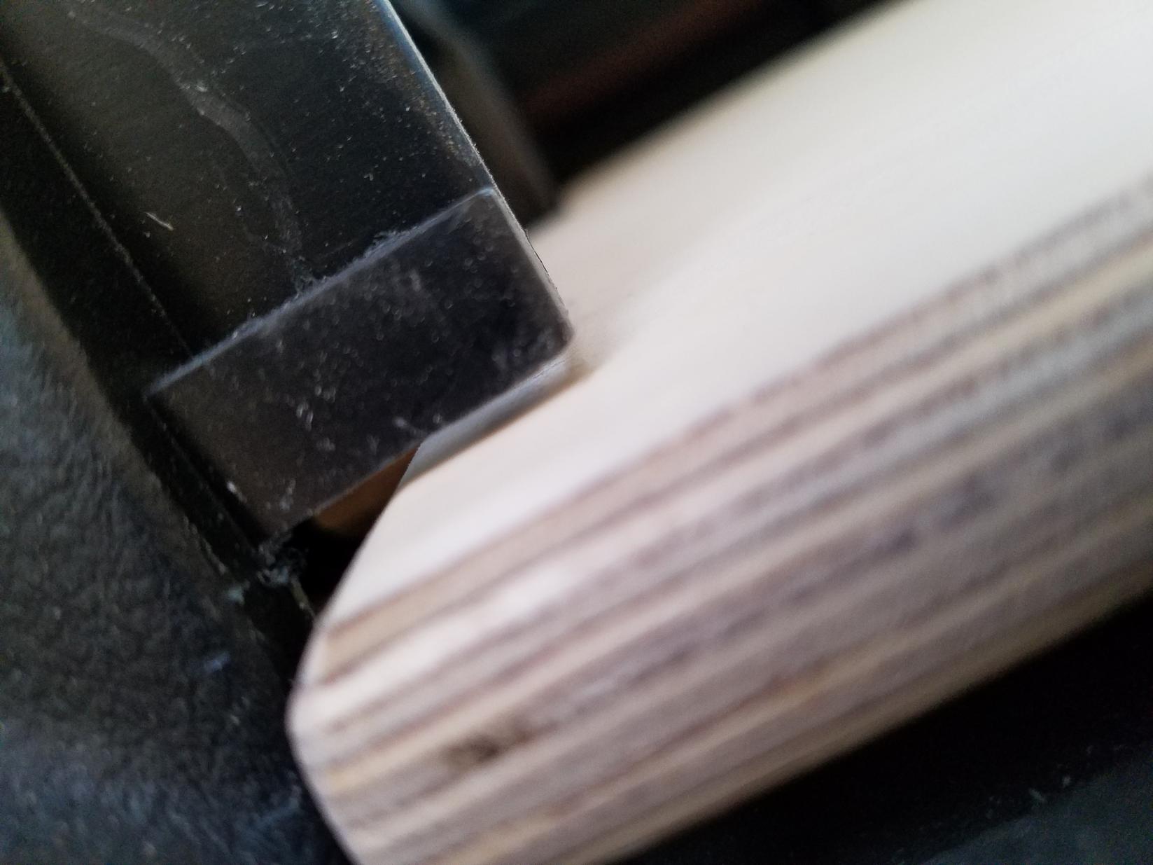

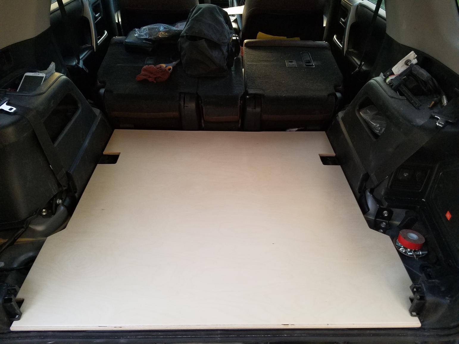

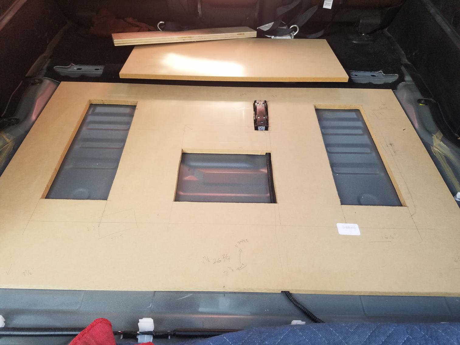

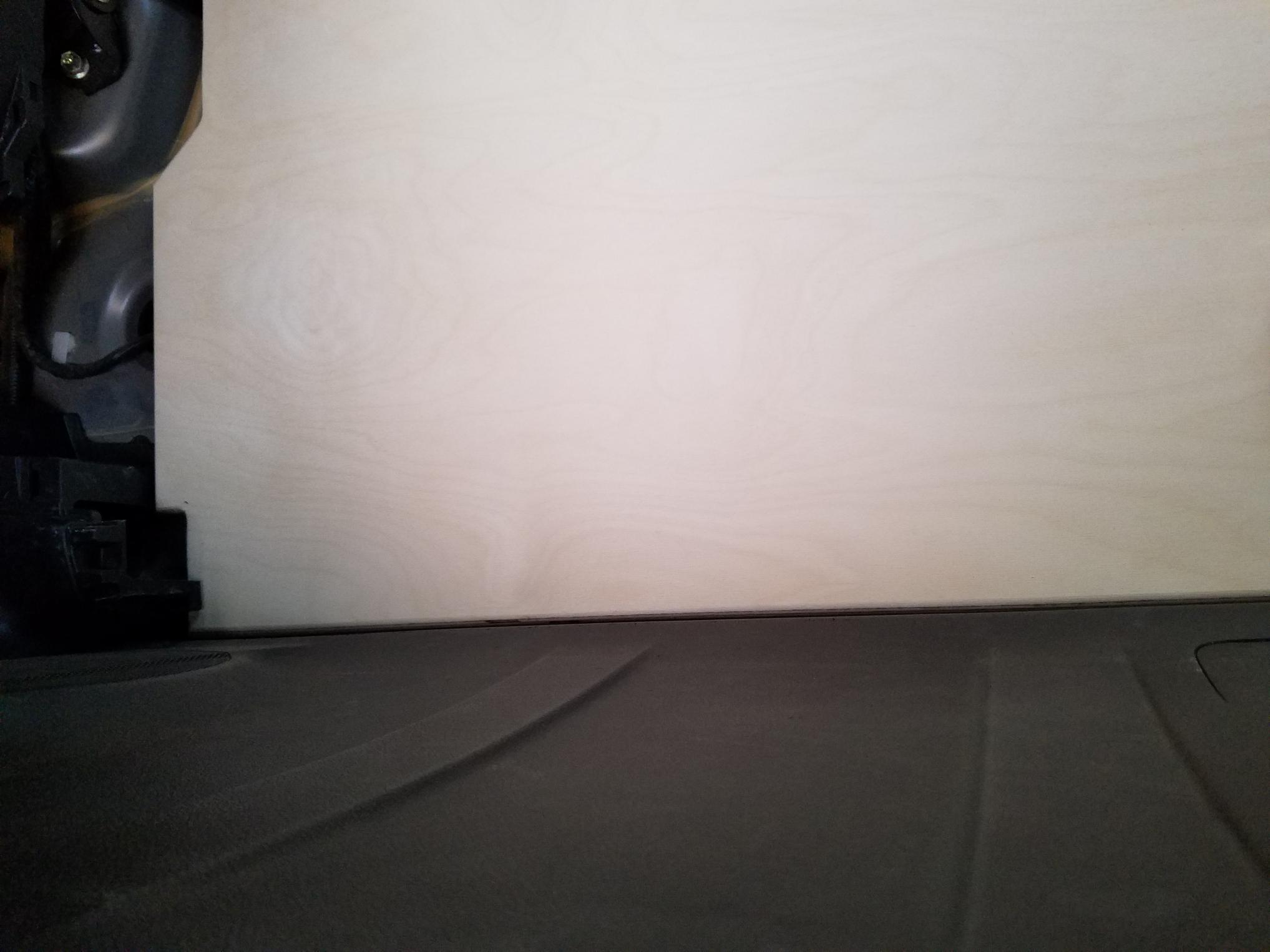

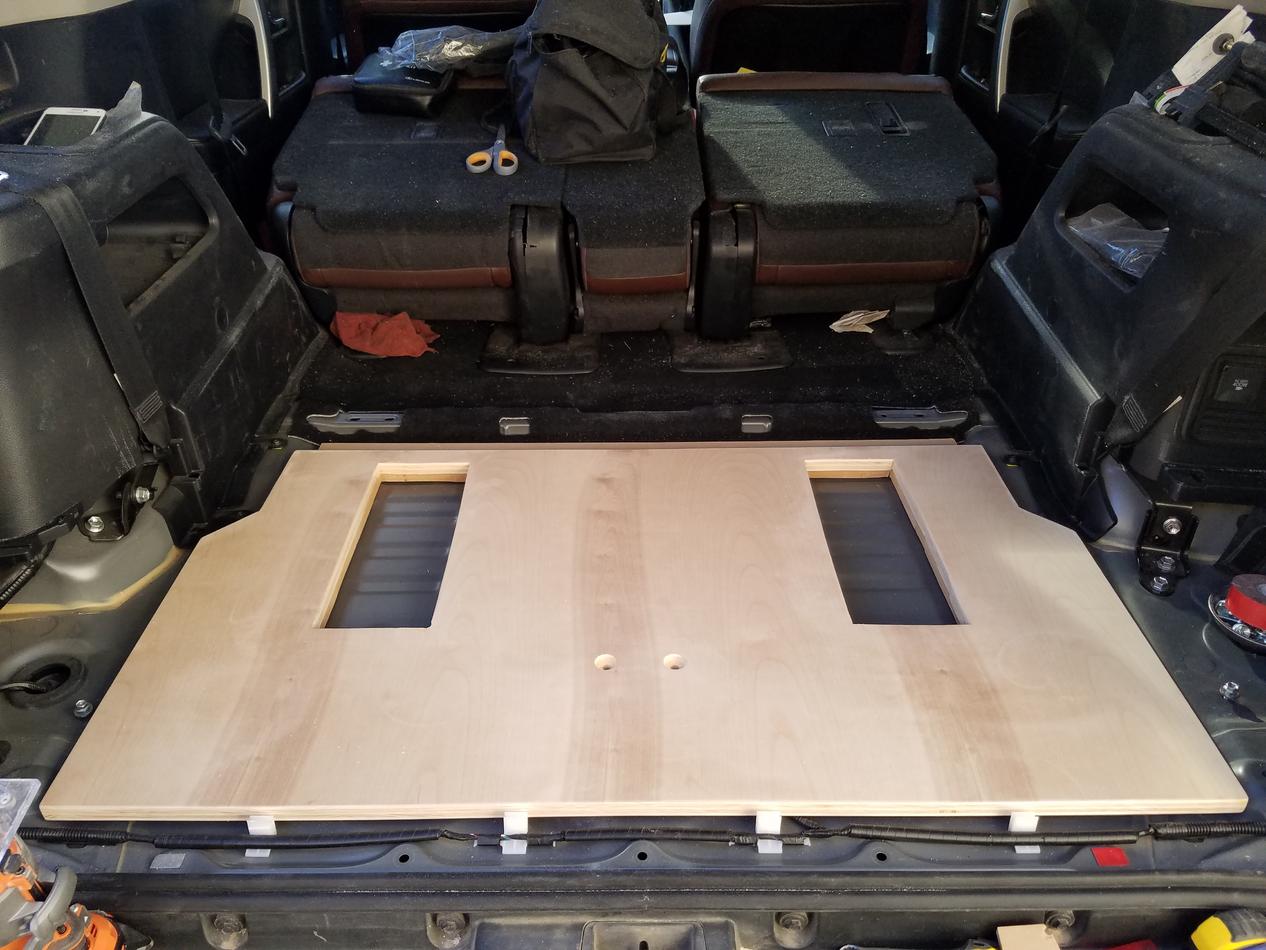

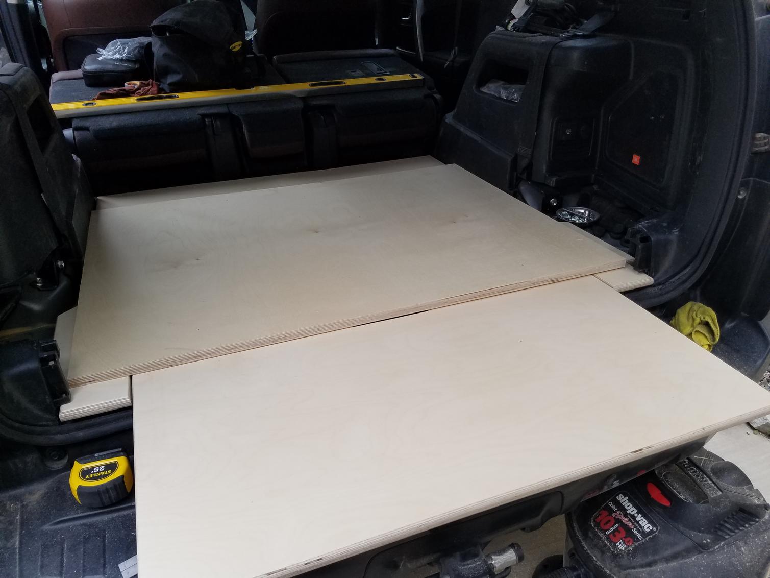

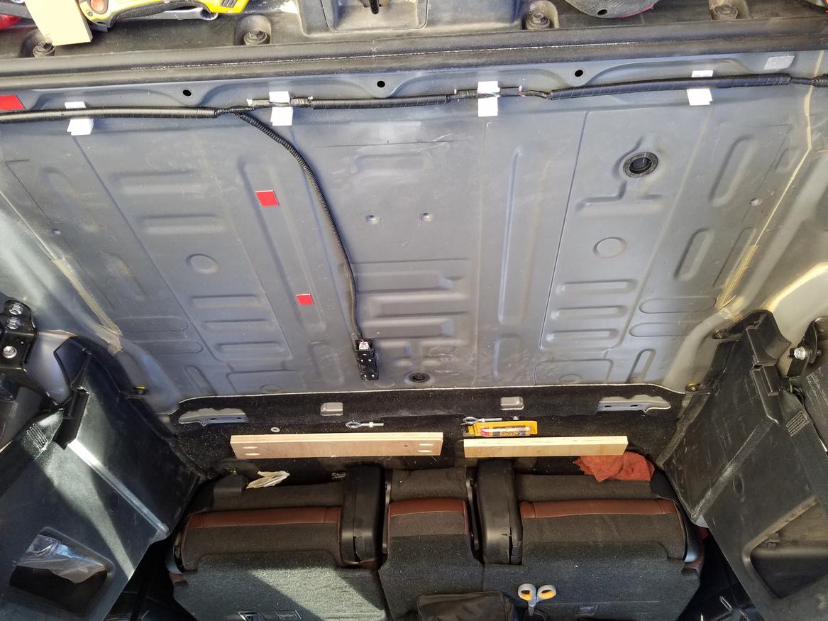

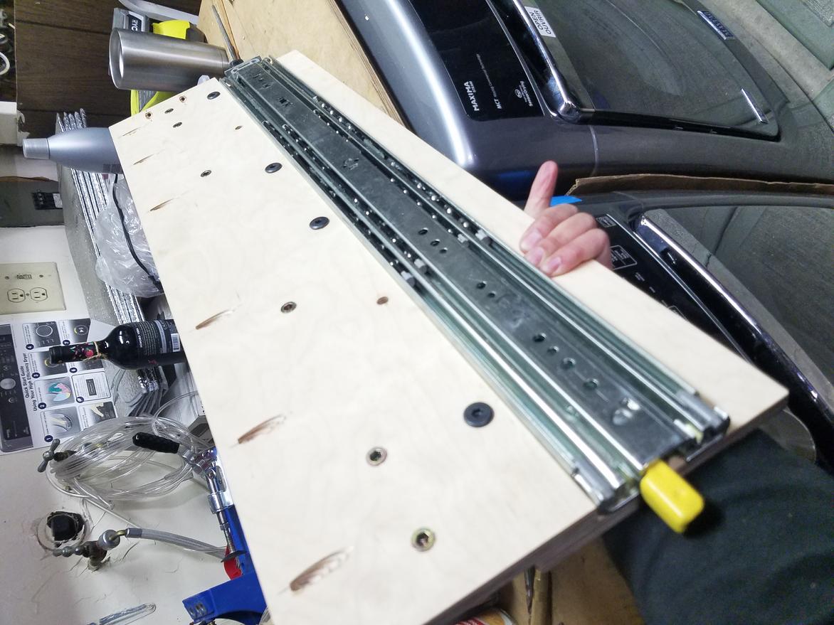

Decided to ditch the 3rd row seats. So now, time to build a new drawers system. This time, using 18mm Baltic Birch plywood with Accuride 600lbs lockin lockout slides. Today's progress: removed 3rd row and fitted plate system for the drawers. They will be don't down to the factory floor bolt.....

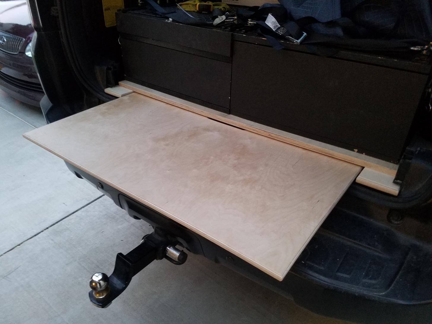

Decided to add a slide out table while I'm at it.
