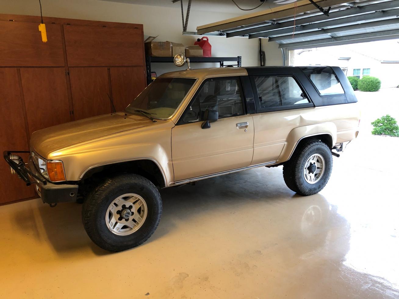

I just purchased an '88 Gen1 that already has a 3.0 3VZ engine installed in it from a '95. The PO said it never ran well after the swap due to electrical problems so he messed with the engine harness and now it's looks like spaghetti under the hood. I did notice that the engine harness and ECU are still the original ('88). I am planning to replace the engine harness and ECU with ones from a '95 but wanted to know if I can reuse the original '88 main cabin harness. Any help or guidance would be greatly appreciated. Thanks.
