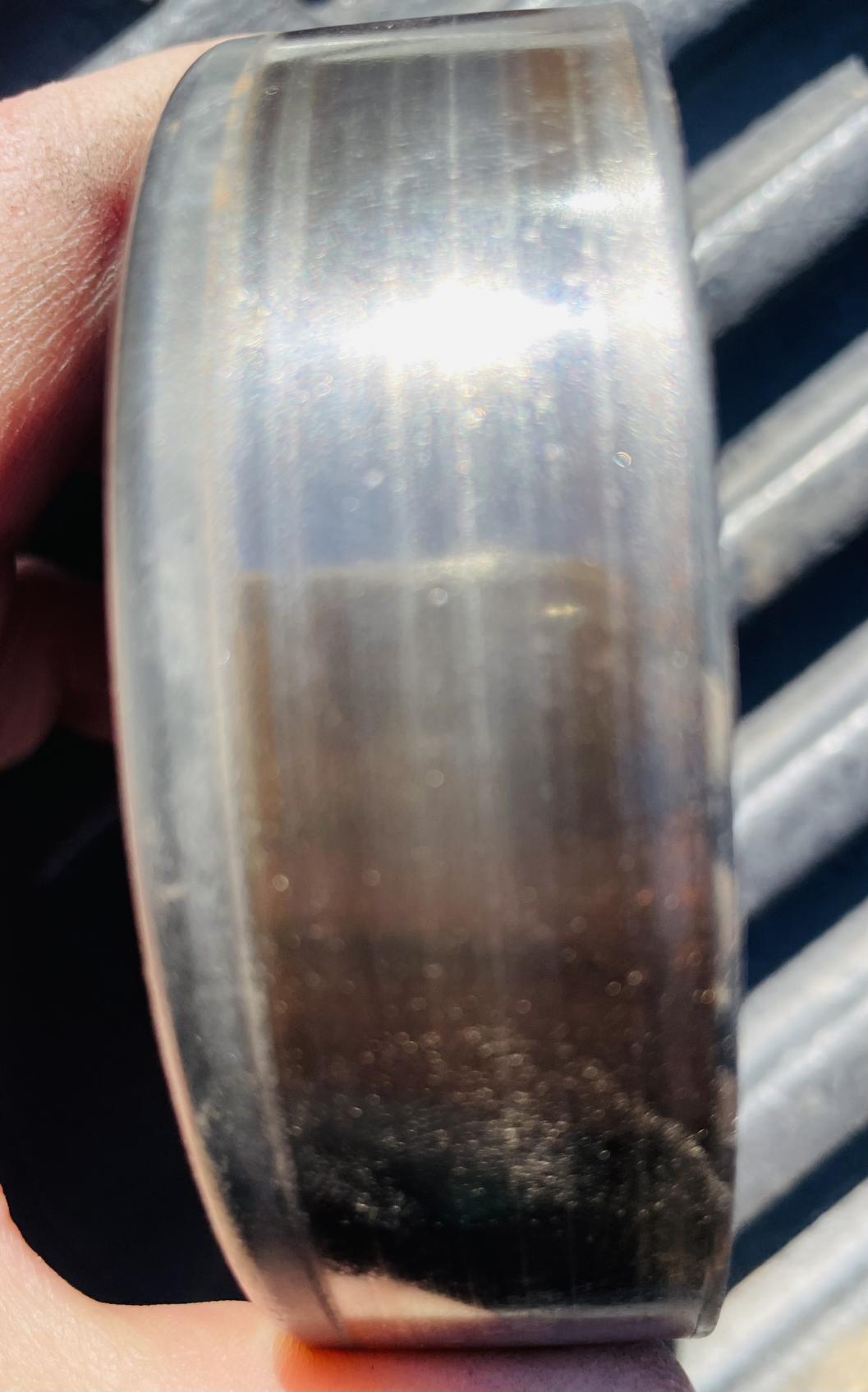

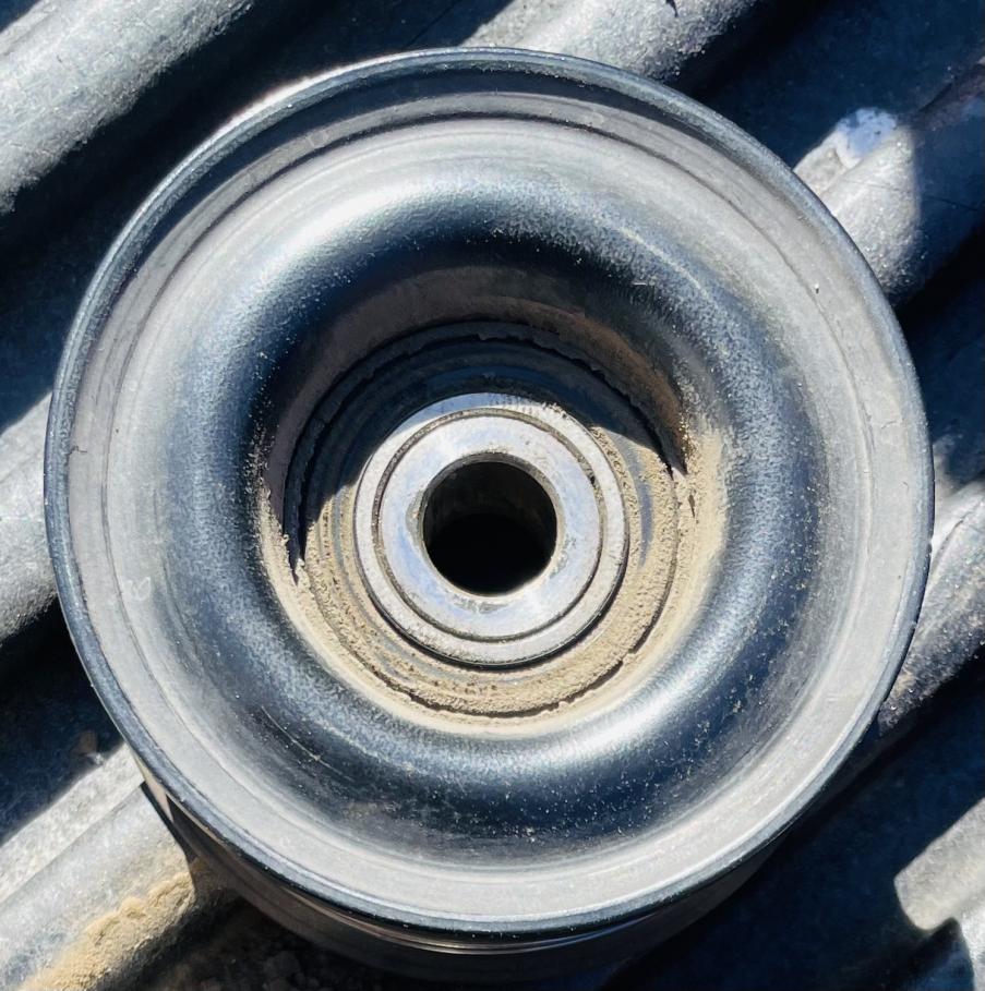

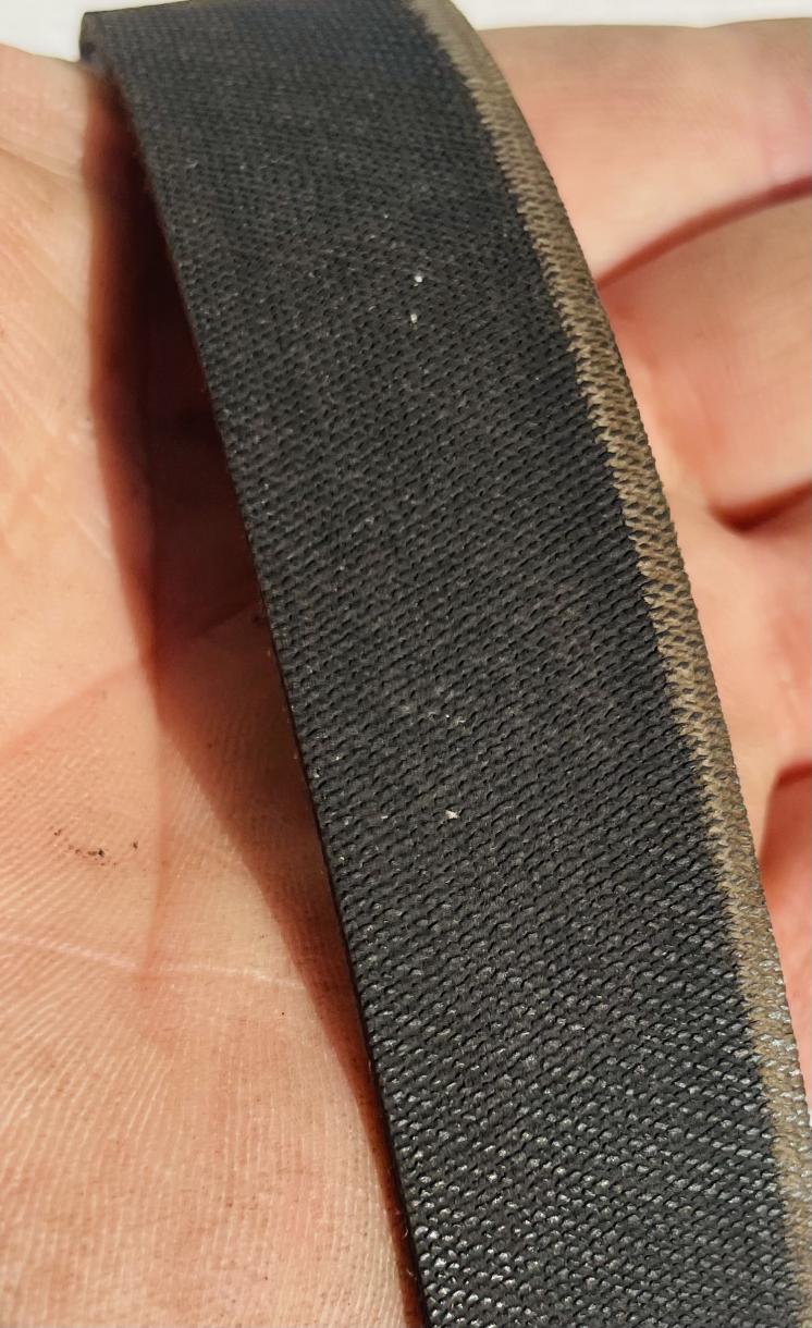

I took the belt off, started it up no noise coming from the front of the engine. I'm going to replace the belt tensioner pulley and the idler pulley. I hope that does the trick for everything. Thanks a lot guys. I appreciate the help something I didn't even think about. Belt has some interesting wear on the outside

It a good thing you're replacing the serpentine belt from the looks of it, a few members here have had theirs totally disintegrate and some of the pieces got in behind the harmonic balancer and destroyed the front crank oil seal which had to be replaced, a lot of work caused by a simple belt breaking!

Belt tensioner pulley is definitely the problem for sure. It's grinding when you spin. I don't hear a lot of noise from the idler pulley, but I'm replacing it anyway with the mileage

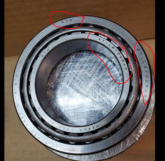

So, take a look at the example I've attached. This is for the rear diff so it's really large but you'll get the idea. The brand name is NTN, and the p/n is AT-LM102910. This is for the race. The "cone", or the actual bearing p/n is 4T-LM102949. This bearing is made in USA.
I've used KOYO, NTN, NSK, NACHI and Timken bearings in my lifetime.

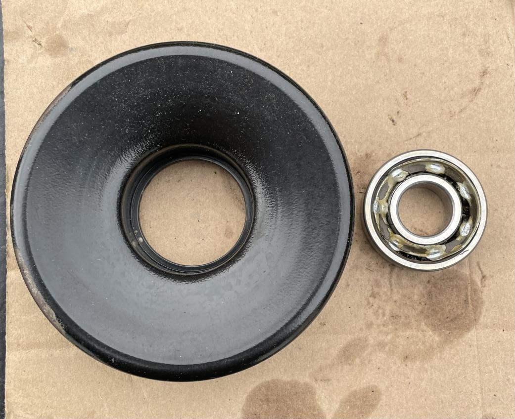

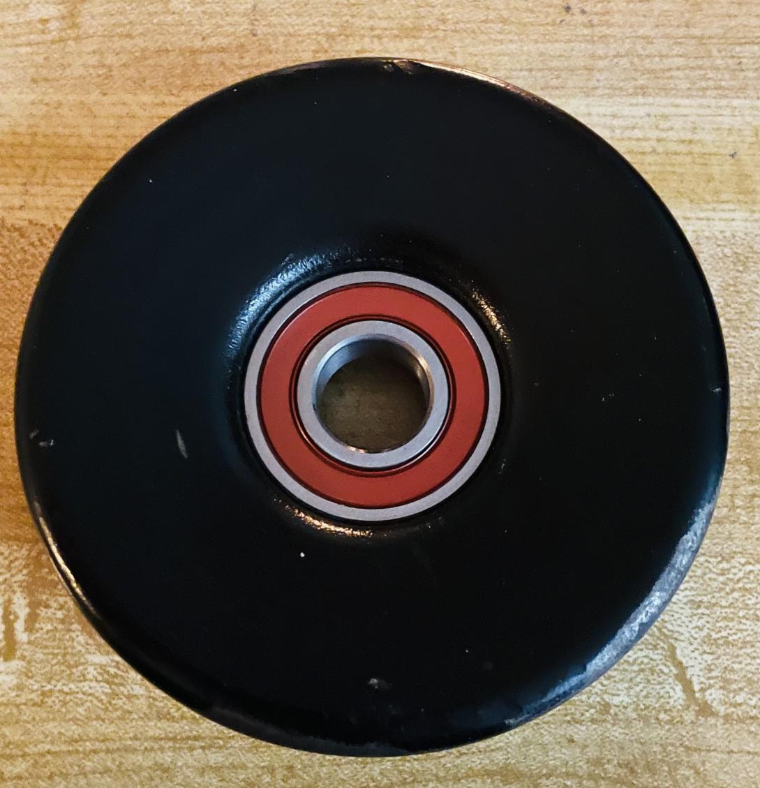

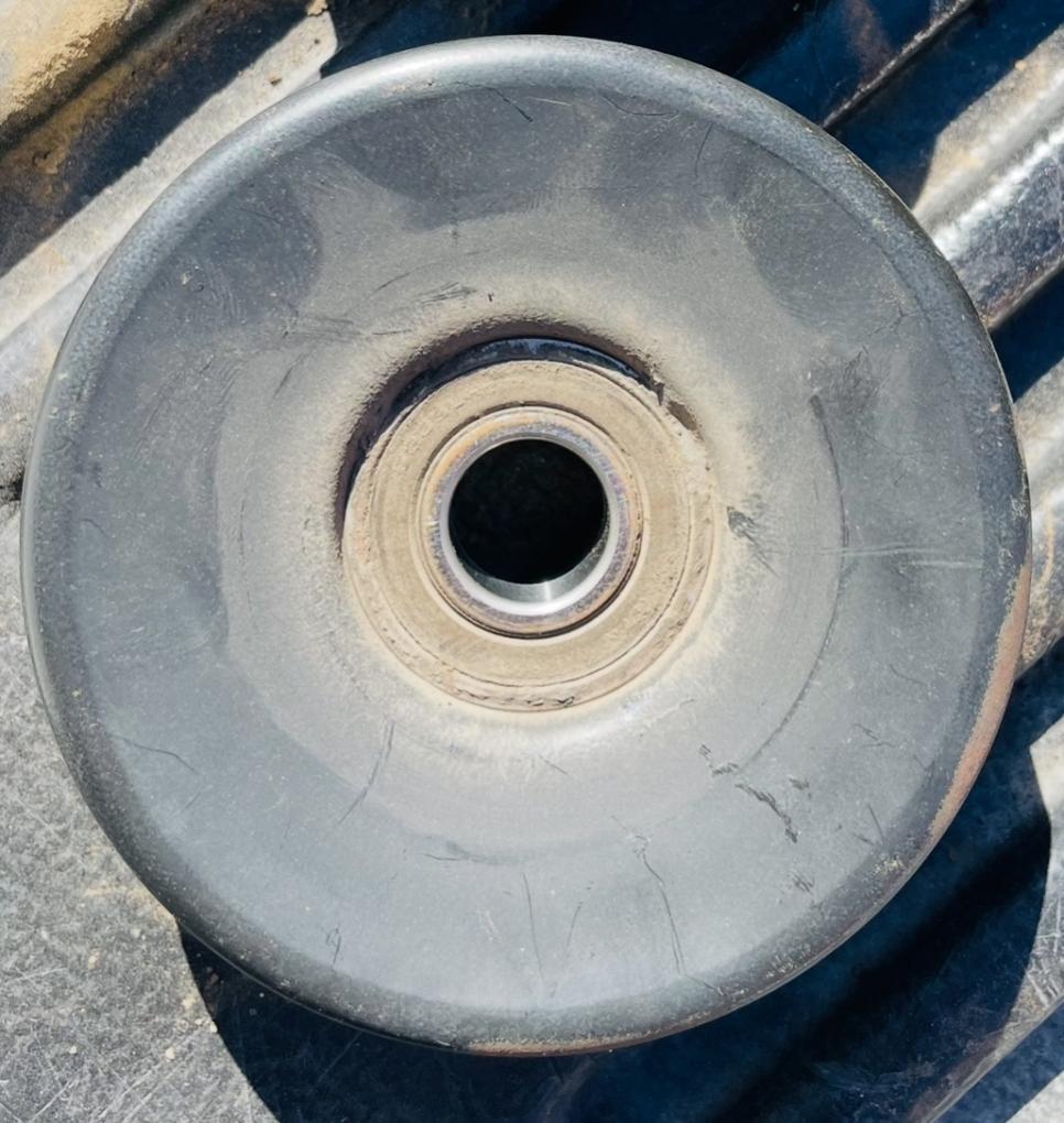

Job is done. Old Bearing came out with some PB Blaster a 24mm socket and a hammer. Came out pretty easy. I put the Pulley in the Oven for about 30 minutes and the Bearing in the freezer for a few hours. Took the pulley out of the oven, took the bearing out of the freezer put the bearing in the pulley. It went about 2/3 of the way in.. then I took the old bearing, put it on top of the new one and tapped it the rest of the way in with a hammer slid right in no problem. Pulley is on the truck with a brand new belt.
