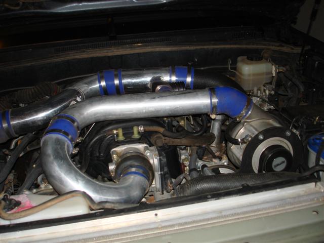

Hey Guys,
I keep meaning to post pics, videos, and specs but I always seem to get side tracked.
Here are some basic details of what im running.
5-6 psi on a Rotrex Supercharger.
Fuel is being added via a 9th injector.
Timing and Fuel settings are being controlled via MAP-ECU2
Timing and Fuel Tuning are done by me ;).
Ive had this setup since July for about 8k miles now with no problems.
Check back often as I will update this thread.
Pics finally!

I have yet to get the truck dynoed as I am having a hard time find a reputable dyno shop that has an awd dyno. I am estimating that the kit has increased hp output by 100 rwhp mark brining my truck upto the 325+ awhp mark.
Originally the kit was intended to be a one of a kind kit. I had a friend, Rob Welsh, send me a custom s/c bracket he had made for the tundra and modified it to fit the 4runner. He did most of the fabrication, while I did the eletronics for timing and fuel.

PICS
PIC
Does any know how to insert multiple pics per post? :(

hmm... I'll be honest: I'm a little disappointed to see a non-intercooled centrifugal supercharger... But at least it's a step in the right direction.
-Rob
good stuff.
how does the butt dyno feel?
I see a possible TMIC being fitted in there, which would then make our hood scoop functional for cooling afterall.

The truck pulls really hard. I'll be uploading some videos shortly that show a side by side comparison of a supercharged 3.4 liter 2003 Tacoma with full fuel mods versus my truck (these tests were done on a closed road :biggrin2: ).
I had previously thought about adding a TMIC, but ruled it out as an option after measuring under hood temps.
