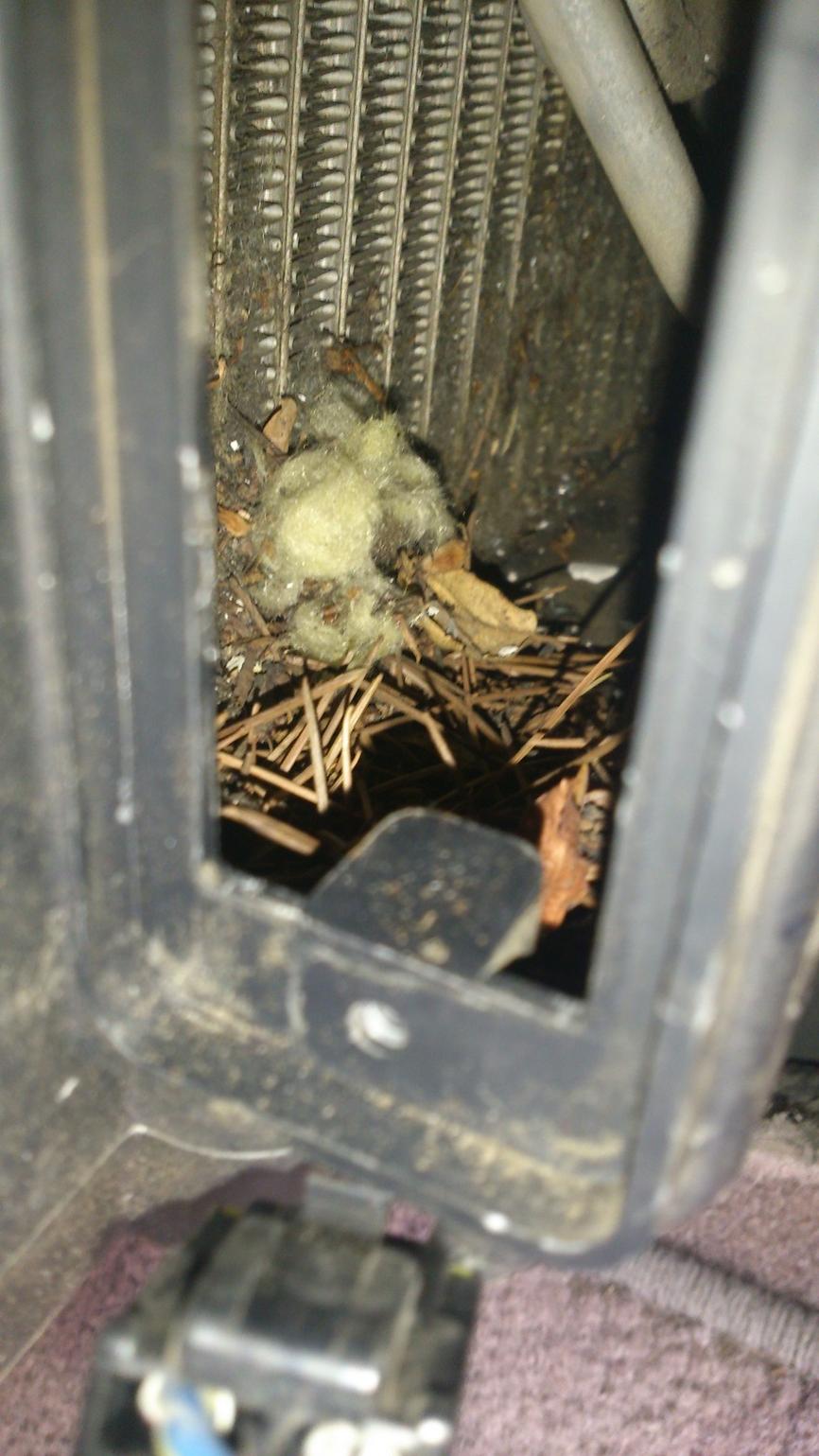

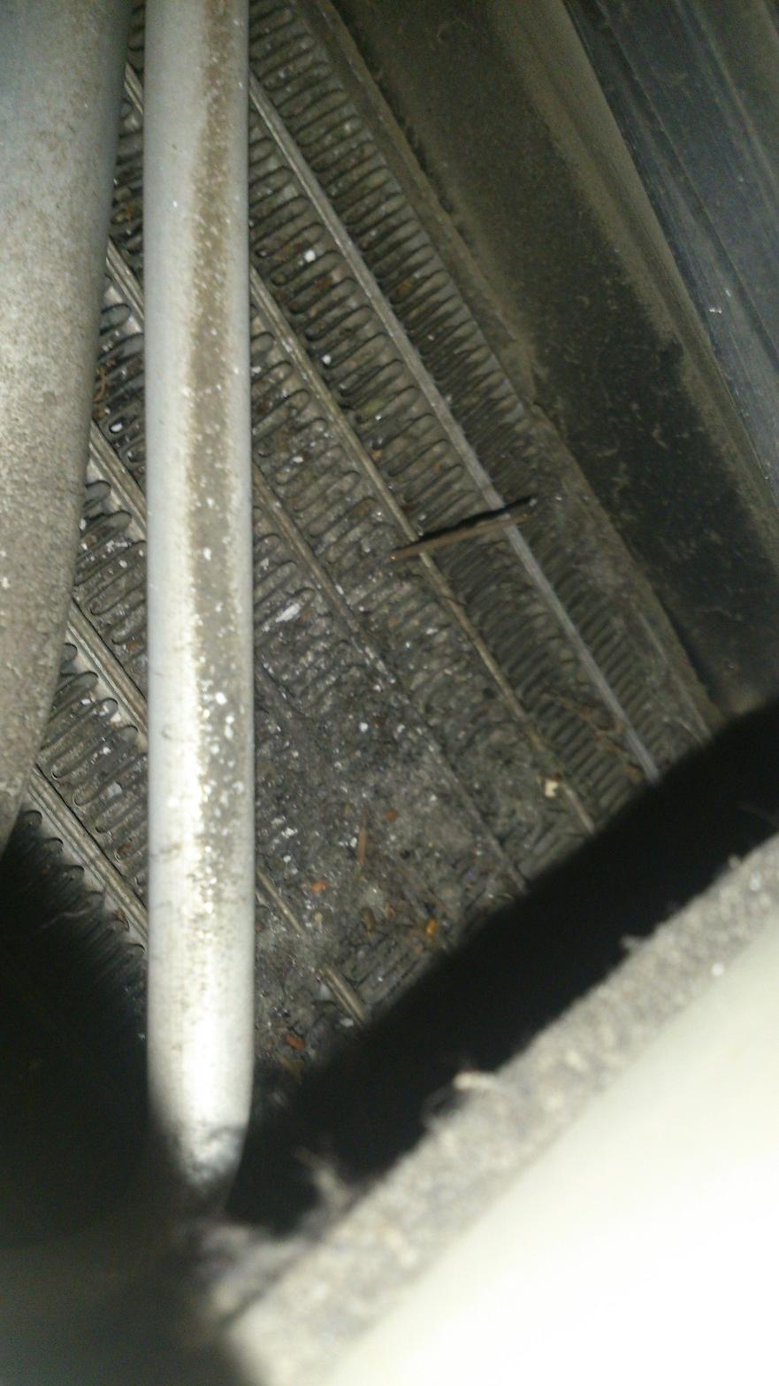

If your A/C not that good make sure your A/C radiator/condenser is clean + your evaporator is as well.
Mine was super dirty as per photo.. cleaned it as best as i could reach.
