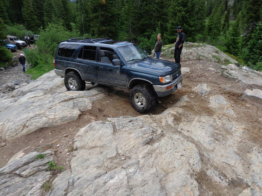

For what it's worth mine has 312,000 miles on it and it spends at least 6 hours in low 4x4 every weekend and just keeps on ticking!
