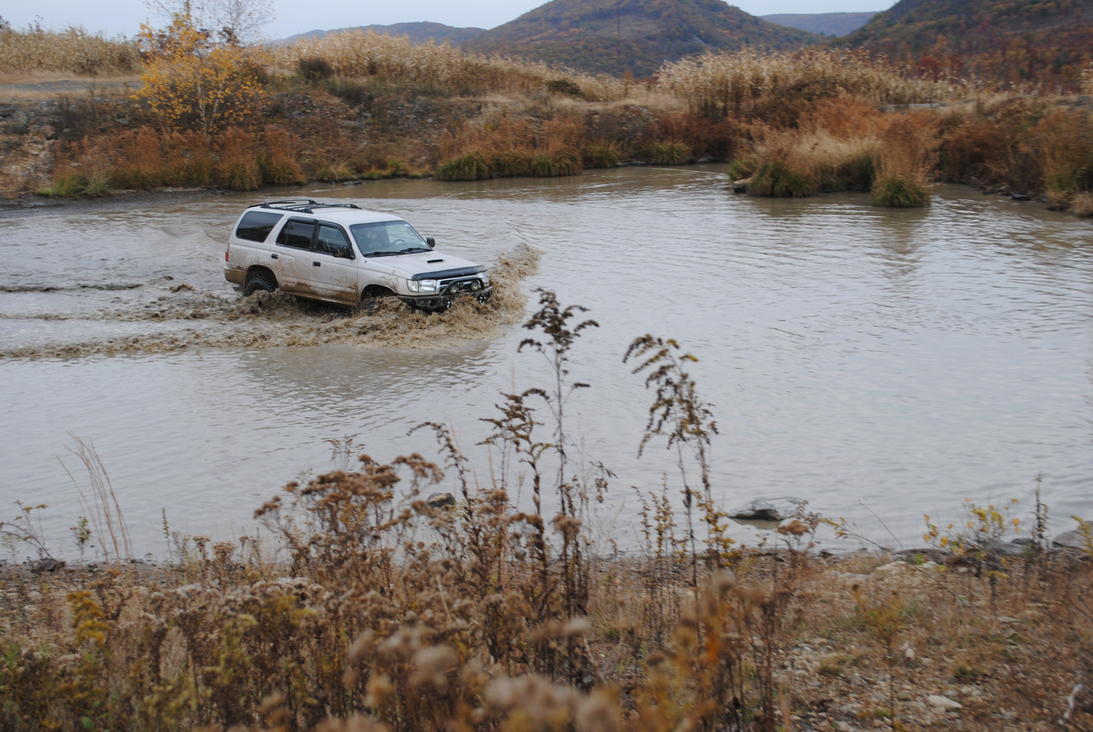

Agreed, I was in 4 lo, 1st gear crossing a pond & the resistance of the water was slowing me down. My rpms were getting too high & the torque would have just started spinning the tires in the mud so I had to slap the manual into second & power out of there.
