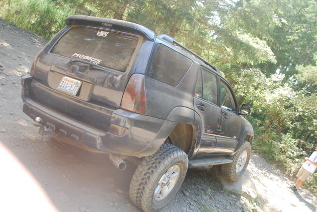

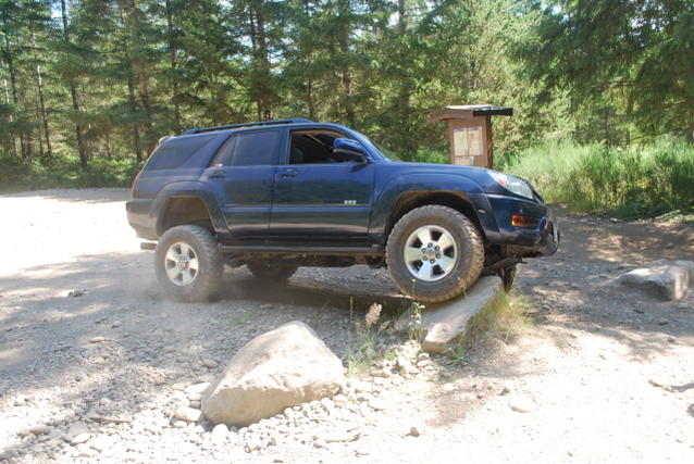

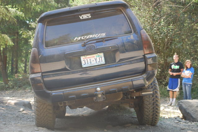

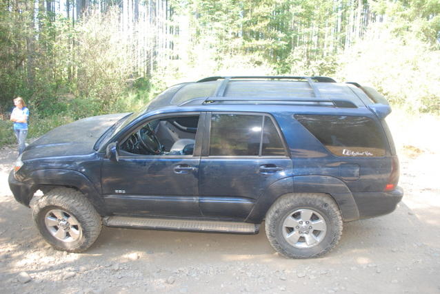

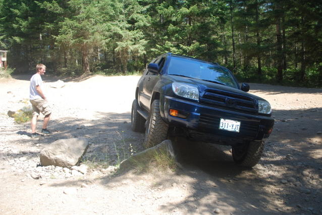

these are some pictures i took of what i think is some amazing flex out of my runner that i havnt been able to get before

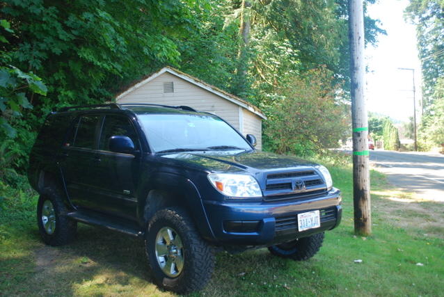

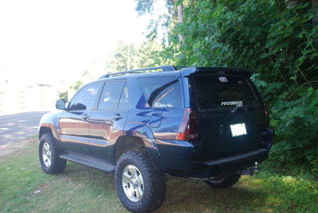

i also posted some pictures of the stance of my runner, i origionally had coil spacers all around and realised that you could never get the right stance back with the lifted look,i hate the sagging back, i like the back to be a tad higher than the front so i played around with it and wasted alot of $ and my time on the internet looking at pictures of runners(especially the thread on here) and realised that what ever amount you lift the front you should get close to the same lift in the back the same thats why i lifted it it 3.5" up front and 3" in the back (a 2" 1" kit is gunna give you major back sagg, even a 3"2" kit) i hope this helps anyone deciding the right way to lift a runner!
i included 2 pictures of just regular stance the rest is flex

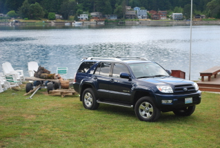

and a stock photo of what she looked like before!
my runners fitted with
FRONT- bilstien c475 adjustables up front and OME coils = 3.5" lift
REAR- toytec superflex coils and 1" coil spacer with bilstein 5125 shock = 3"lift
TIRES- 285/70/17 cooper discoverer STT's approx 33" tires with spidertrax wheel spacers
INTERIOR- 100wtt PA system, 2 12"jbl subs, alpine deck, blue LED's all over, power inverter,
ENGINE- K&N CAI, Throtal body spacer, Flowmaster catback exhaust
EXTERIOR - 8k H.I.D's and 6k fog lights, blacked out tail and front lights, 20% tint all the way around, red brake calipers from bhear
and much more!
