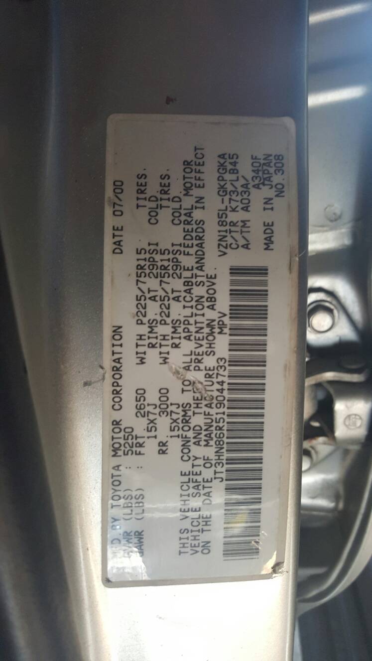

Here is my axle tag what do you guys think?4.10 or 3.909?
Sent from my SAMSUNG-SM-G920A using Tapatalk
The VIN tag is not an accurate predictor of the gear ratio for 2000s. More than one gear ratio can be found for several axle codes.
Paint codes on the nose of the pinion, if it's still visible, tooth counts, or counting pinion rotations with two tire rotations are the ways to tell what the ratio is.

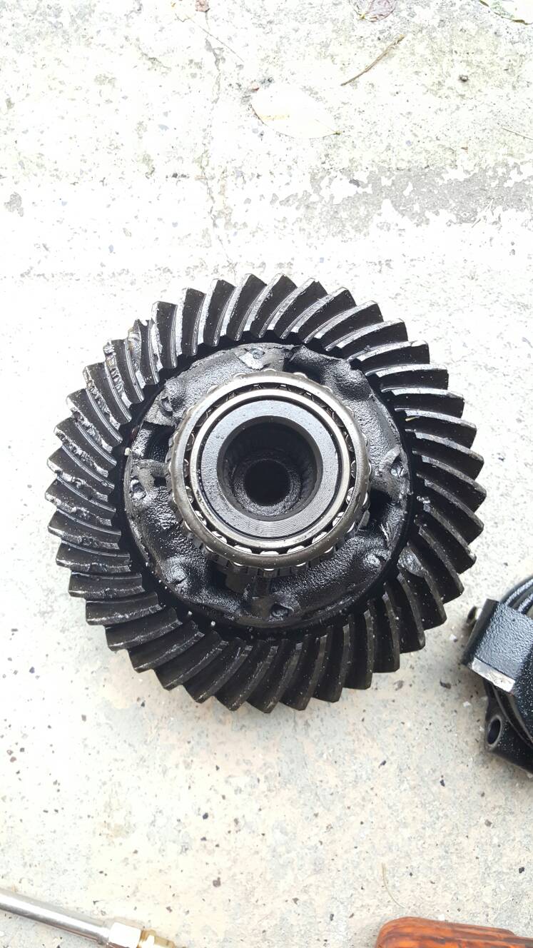

This morning took apart my torn up old rear differential. Counted 41 teeth, with this in mind I decided to give the 4wd another try but keep the wheels straight and slow.

Complementary pic of my 4.10 gear chewed up for all the help.
