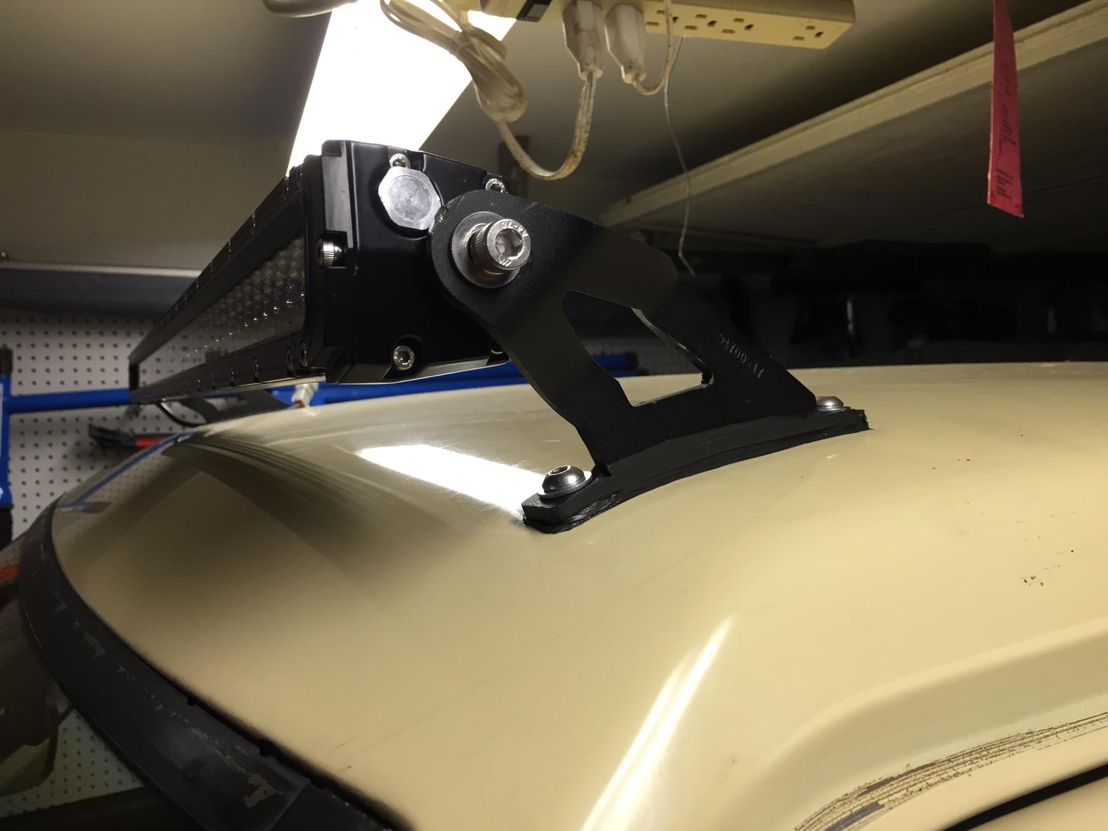

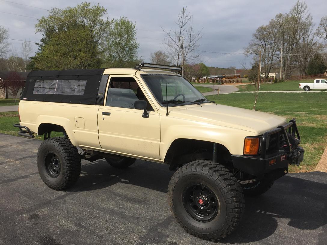

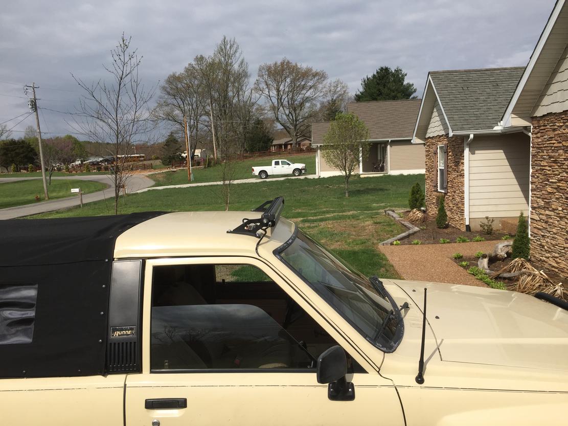

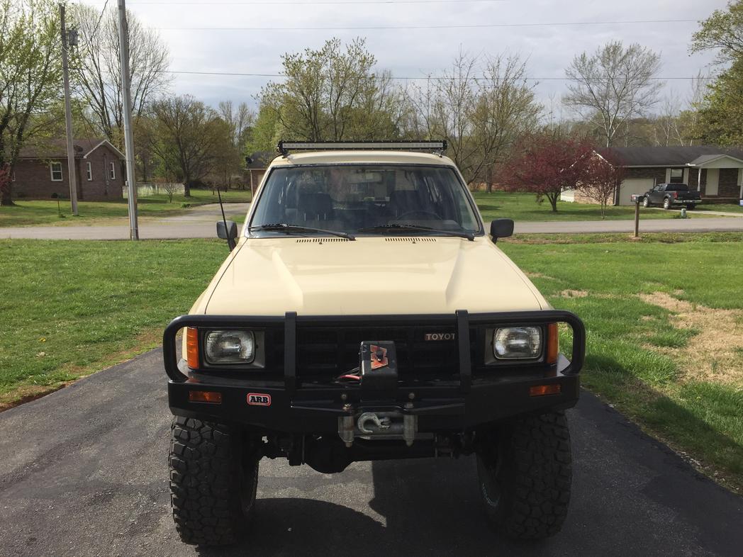

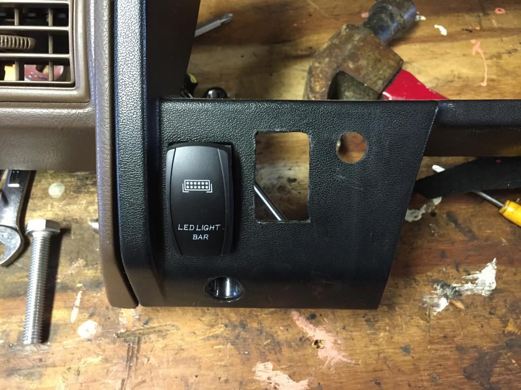

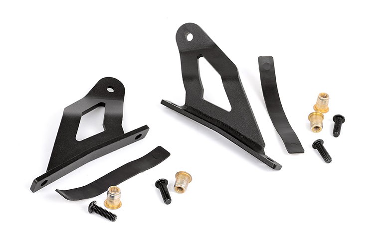

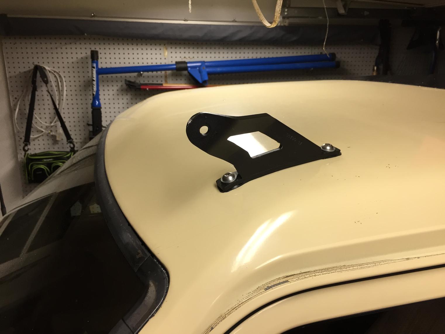

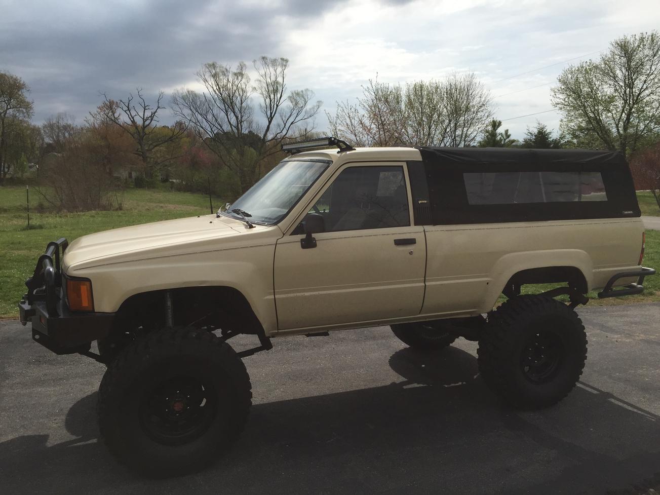

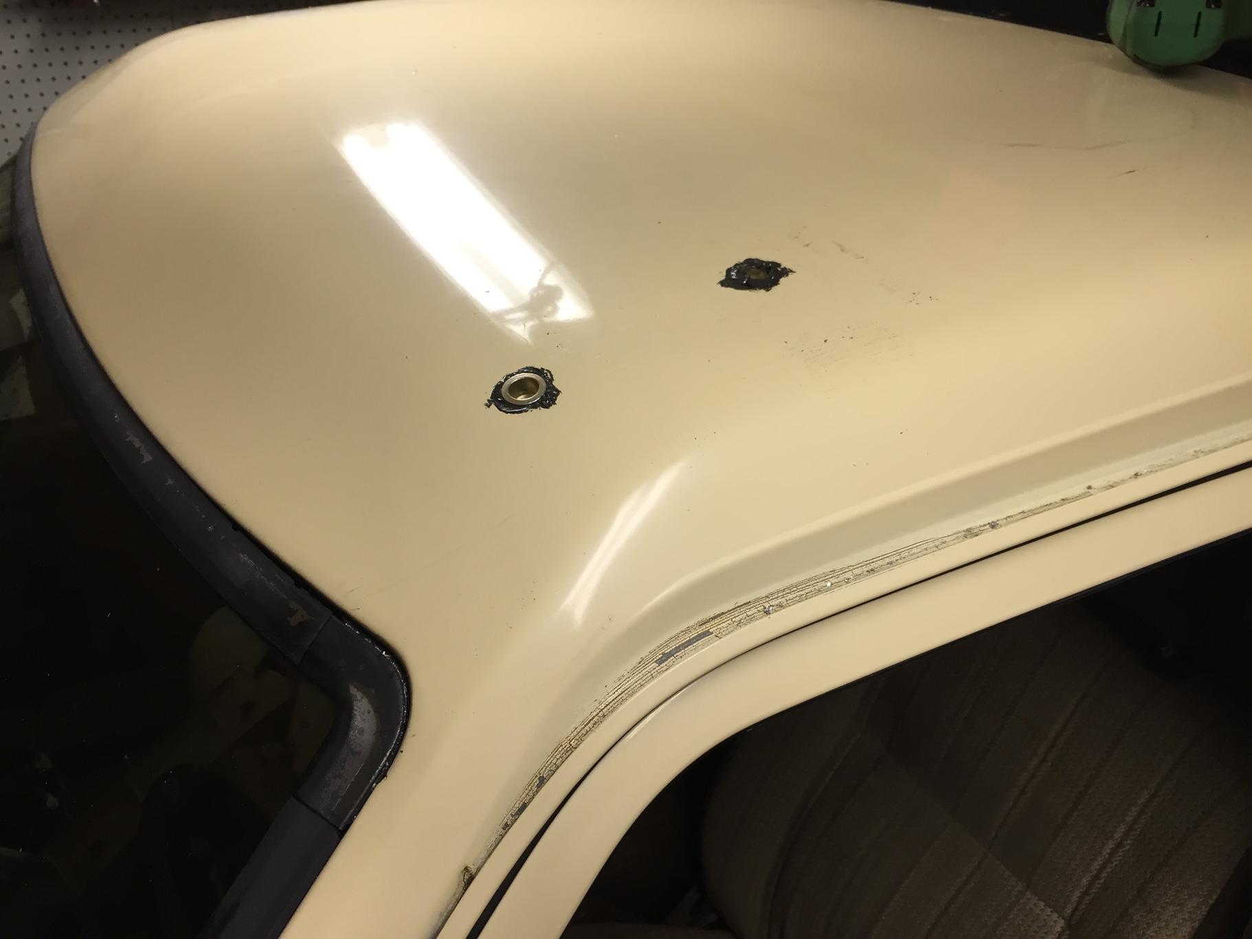

So i decided to install a light bar on my new 4runner, heres how it went. As we all know there is no one that makes a kit for classic toyotas so i had to think outside the box. I started just searching for brackets to see what was out there and i happened to find rough country brackets that are made for a nissan titan that had a nice design and looked they would work on a 4runner roof with some modification. I decided to get the ones for a curved light bar since they had a bend outward. So i ordered them as well as a light bar, harness, and switch from superbrightleds. I had to bend them some and get them to lay nice and flat on the roof took about an hour to get them right. They came with the inserts which worked well, i figured worst case i could always pull the headliner and just put a nut and washer. The brackets also came with a rubber gasket that i used but i also rtv'd everything(fingers crossed for no leaks) Anyways i thought i'd share how it turned out.
