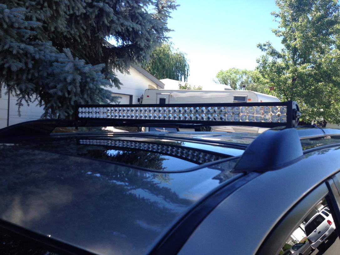

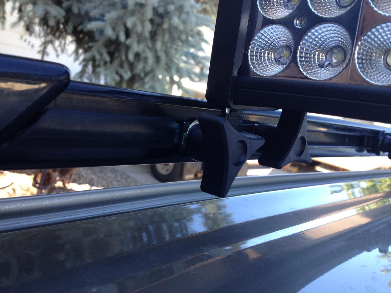

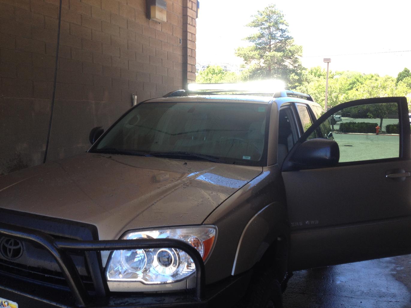

mounted on the roof like a similar user just different bracket(t for side mount led) . just thought id share a lil info. ran wires up winshied grommet and switch through fire wall. used draw boly for roof racks and knobs from lowes ( can get part numbers if needed).

Hey there, this is the only double row I've seen mounted between the roof racks.
Can you please post details on which light bar, mount, and part numbers from Lowe's that you used?
TIA.
Are you not getting any win noise? I mounted mine nearly identical to yours, but I can hardly stand driving over 50 mph. The wind rattles the lightbar and roof rack to no end.
Can you tell me how you ran the wires through the windshield gasket? I might try your technique.
I wired mine down the side of the windshield. I tucked it under the weather stripping, then ran some black latex to seal it and keep it from coming out.
