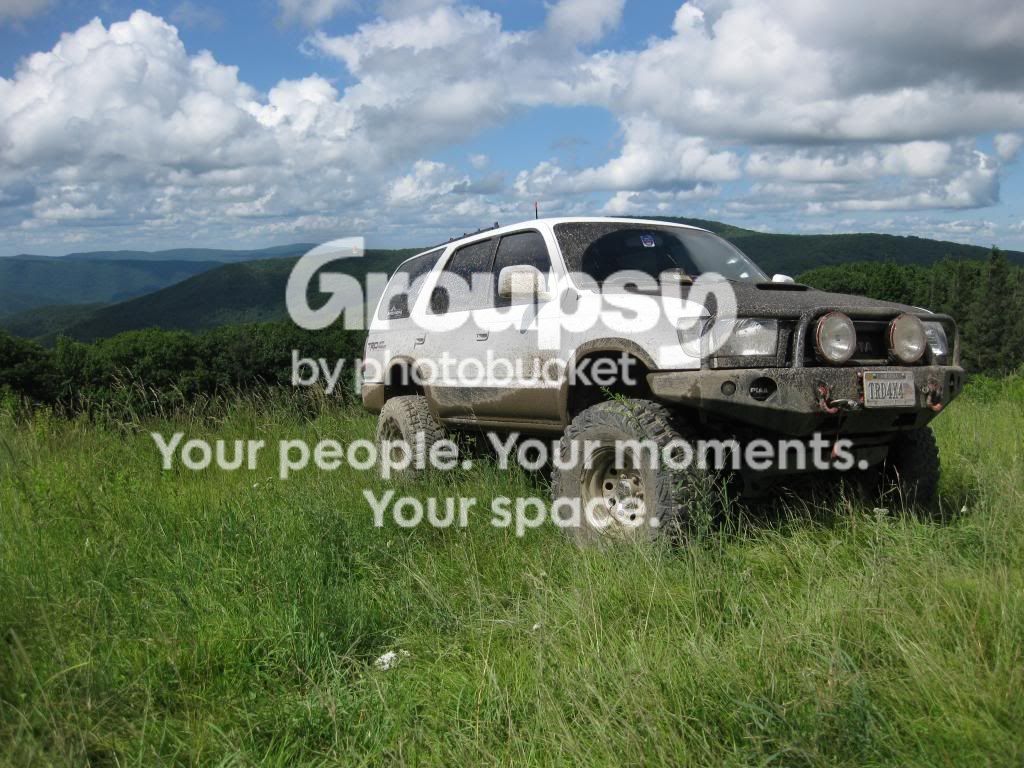

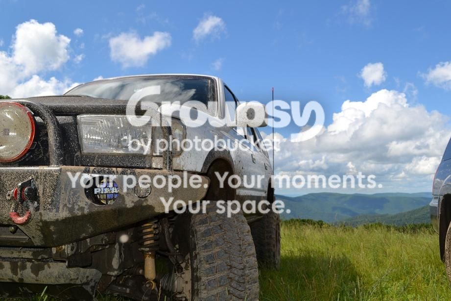

Here is how she sits today - 7/6/13 at Meadow Knob (George Washington National Forest)

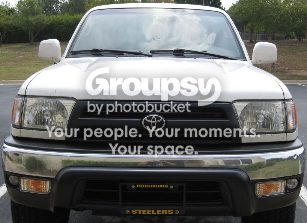

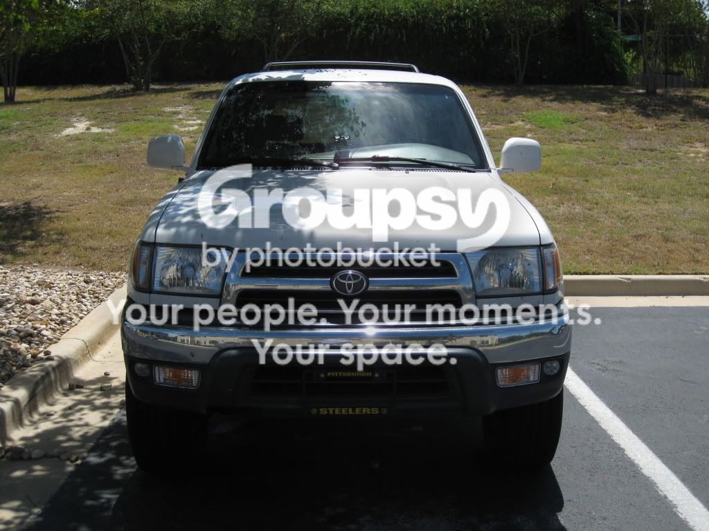

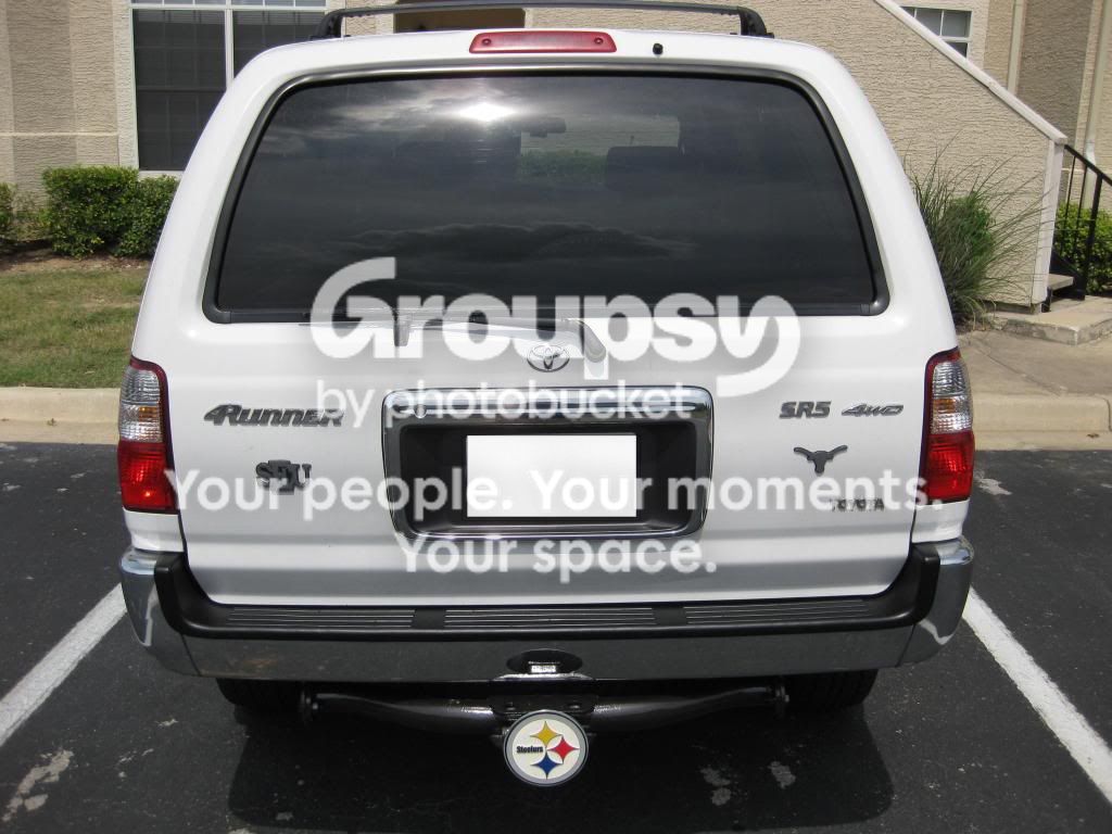

Here are some pics from the first couple weeks I had it.

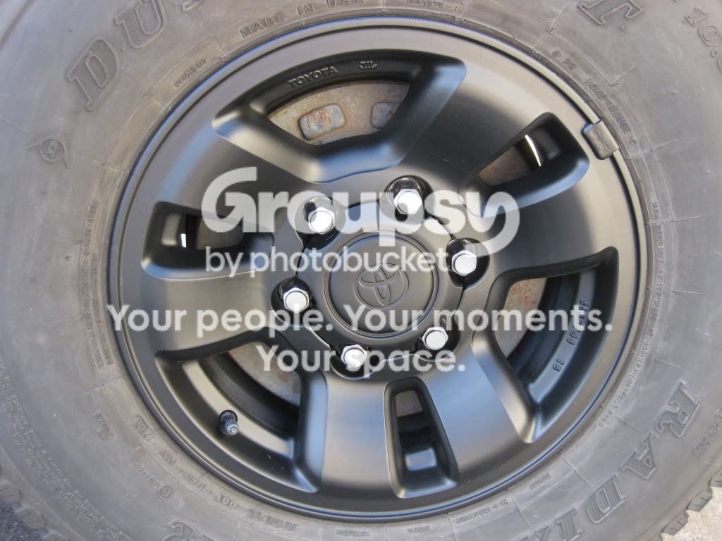

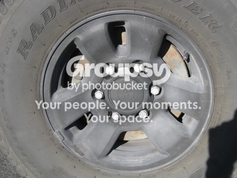

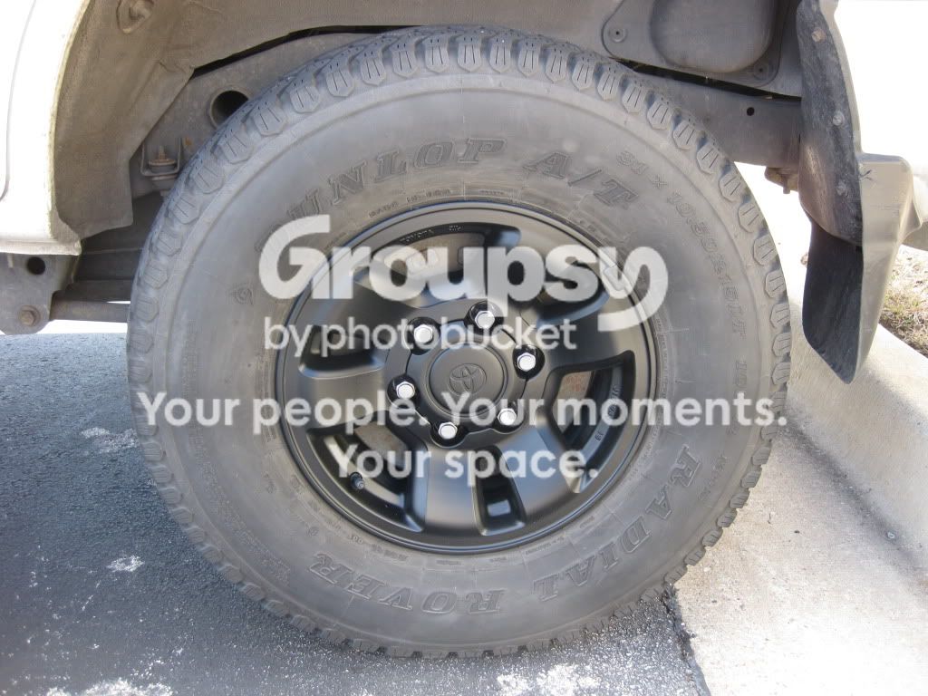

The previous owner tried to paint the wheels black. I think it is safe to say that the guy didn't know what he was doing because this is what they looked like.
IMG_0405.jpg~original
Needless to say, the crappy paint job had to go. So I talked to Christian at Rimpainter.com and he put together a semi-gloss black kit for me to repaint the wheels the right way. I think they came out great!!
IMG_0425.jpg~original
IMG_0424.jpg~original
IMG_0437.jpg~original

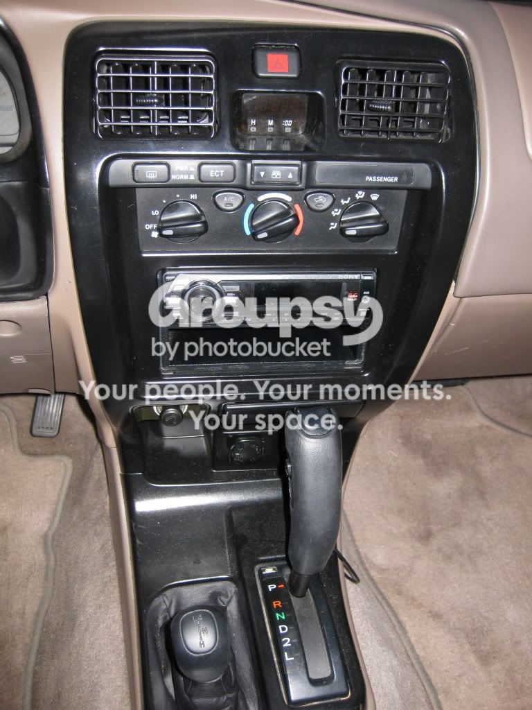

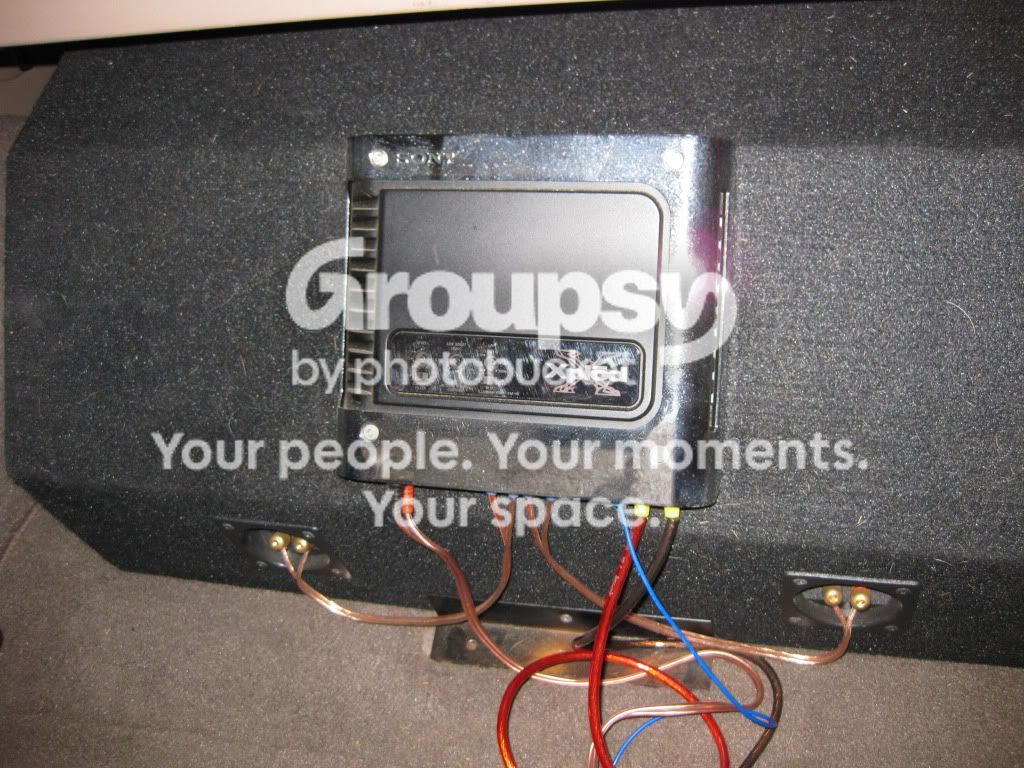

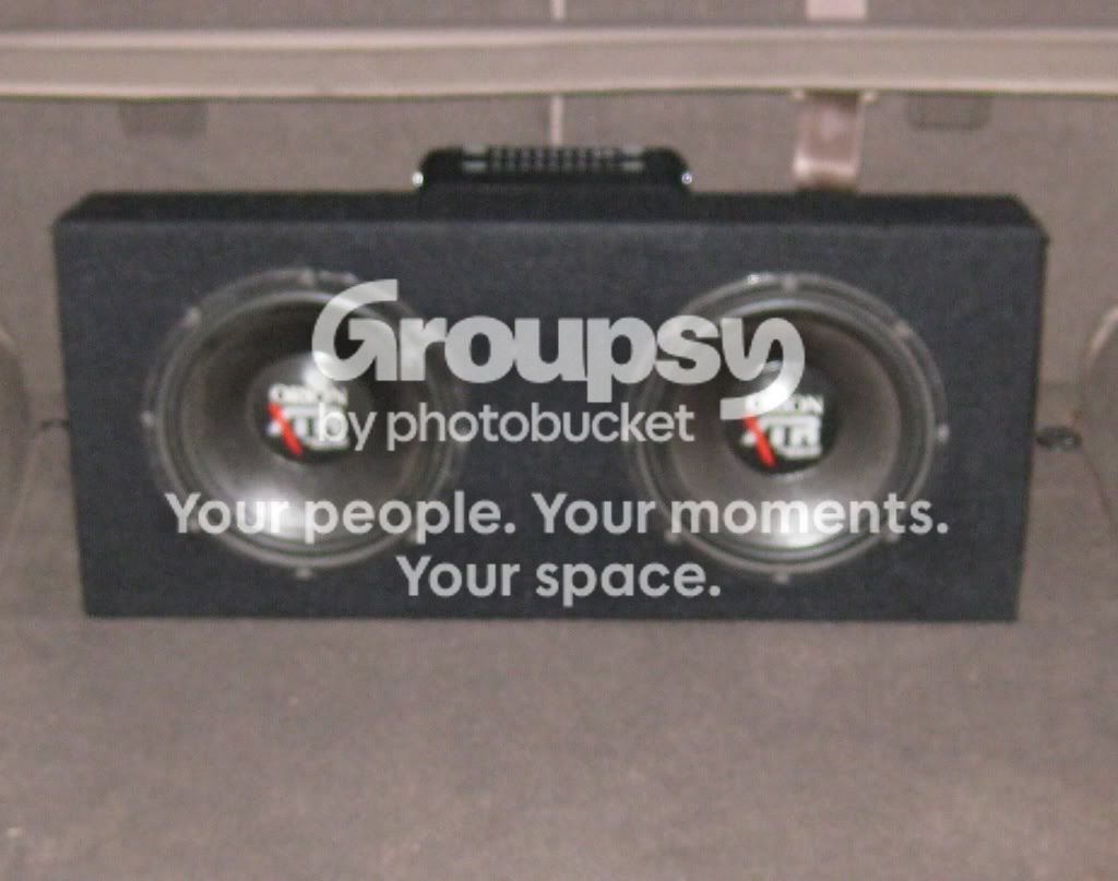

Shortly after I bought the truck my friend gave me 2 Orion 800 watt subs that he took out of his car that he totaled. Since I got the subs for free and I wanted to put them to good use, so I bought a sub box, amp, and a new deck. The install wasn't bad at all and I was able to do just pretty much all of it myself. The only thing I needed help with was wiring the actual subs to get the proper resistance. I went with a Sony Xplod 1000 watt class D amp and a Sony Xplod head unit with a build in Ipod cable and Ipod controls.
IMG_0593.jpg~original
IMG_0601.jpg~original
IMG_0608.jpg~original

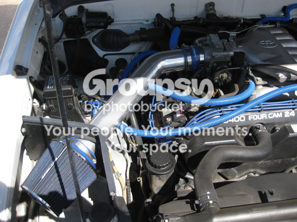

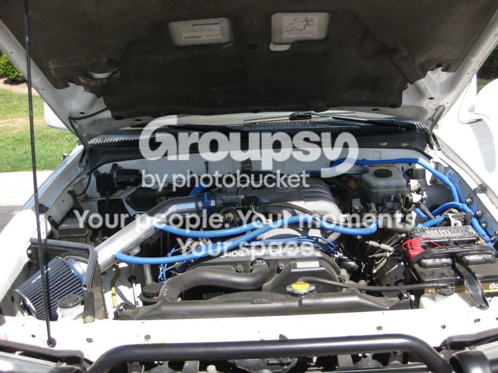

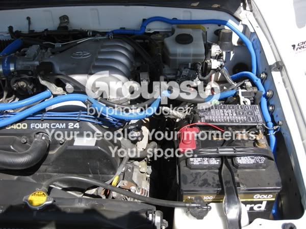

While browsing eBay I found a cold air intake for $100 so I pulled the trigger. I just couldn't justify paying 2-3 times more than that for a brand name like AEM or K&N. The filter it came with was pretty crappy so I bought a Spectre filter and matching connector from my local auto parts store. I also ordered up matching wire coverings to add a few accents and tie everything together. While I was at it I also replaced the spark plugs with E3 plugs and installed new NGK spark plug wires. Replacing the spark plugs is 10X easier once the stock airbox and other intake parts are removed.
IMG_0455.jpg~original
IMG_0456.jpg~original
IMG_04571.jpg~original

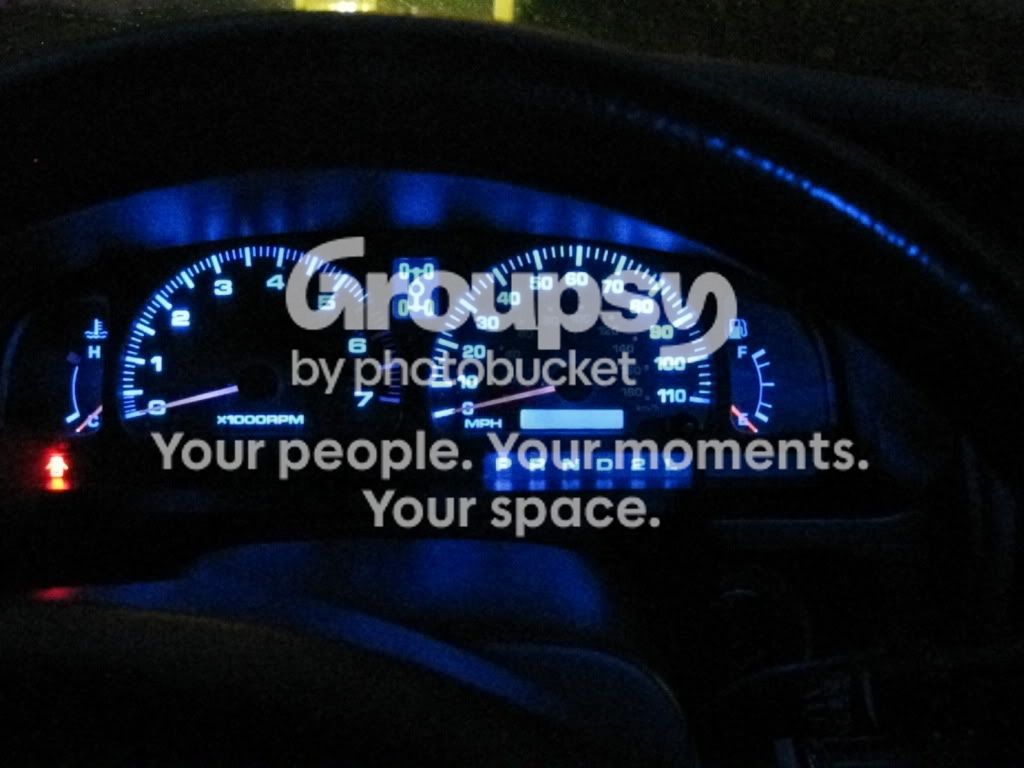

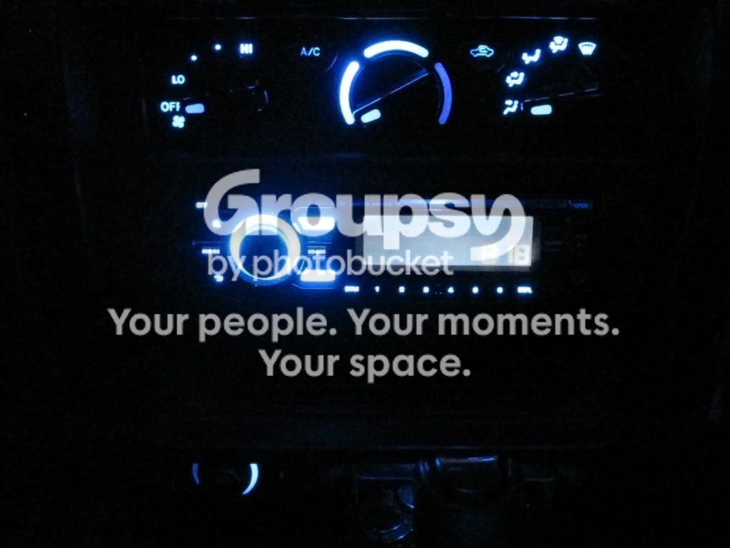

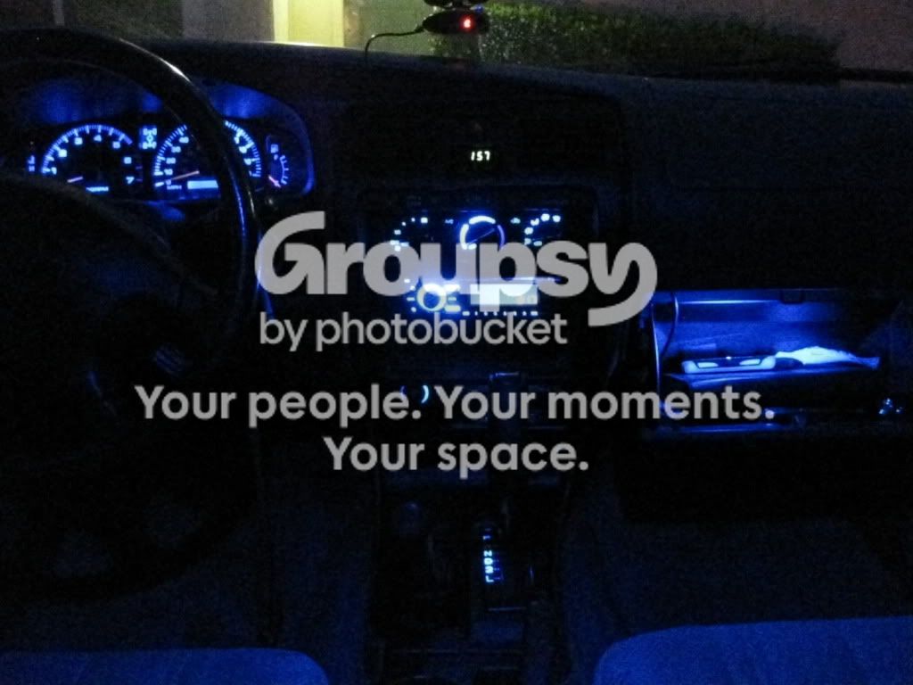

I was looking for other mods on the internet and that's when I stumbled across YotaTech. Needless to say my list of mods got a whole lot longer...I found a thread about replacing the lights behind the gauges with LED's and I knew that had to be my next mod. I chose blue LED's because they matched my Sony head unit.
Here is how mine came out
IMG_0204.jpg~original
IMG_0203.jpg~original
IMG_0202.jpg~original

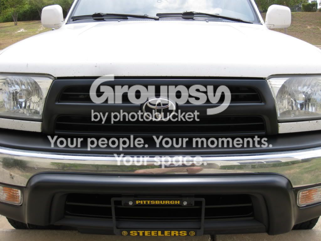

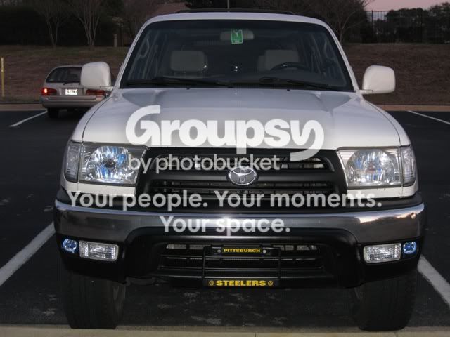

After I painted the plastic pieces, I went a little eBay crazy. I bought clear corner lights, clear bumper lights, and some new Xenon headlights. I love the really clean look!!
IMG_0430.jpg~original

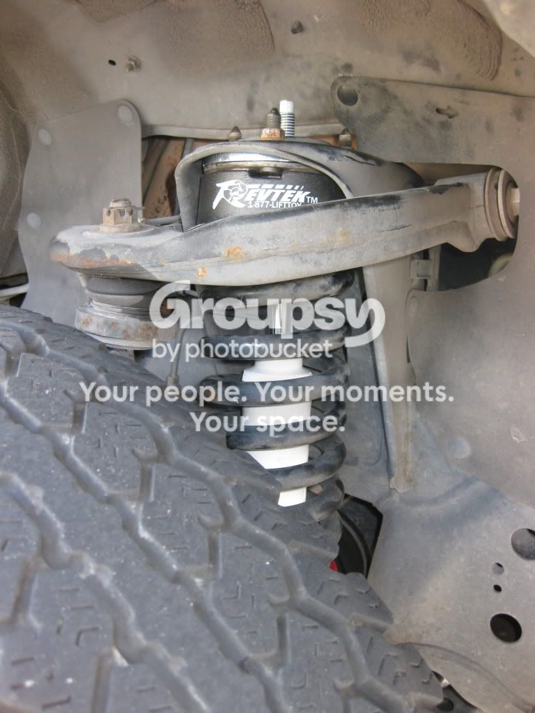

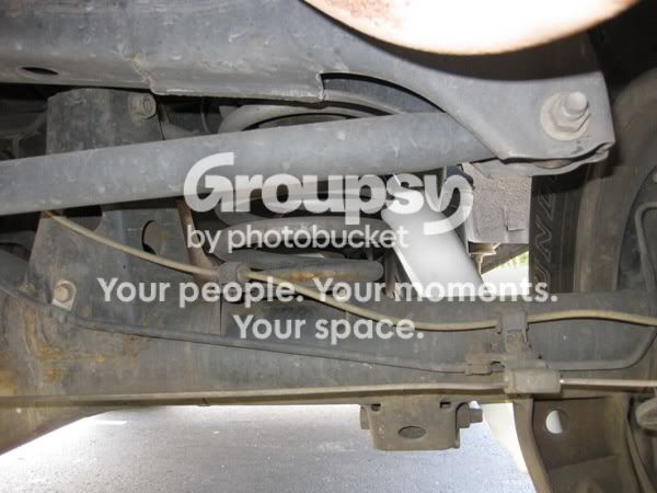

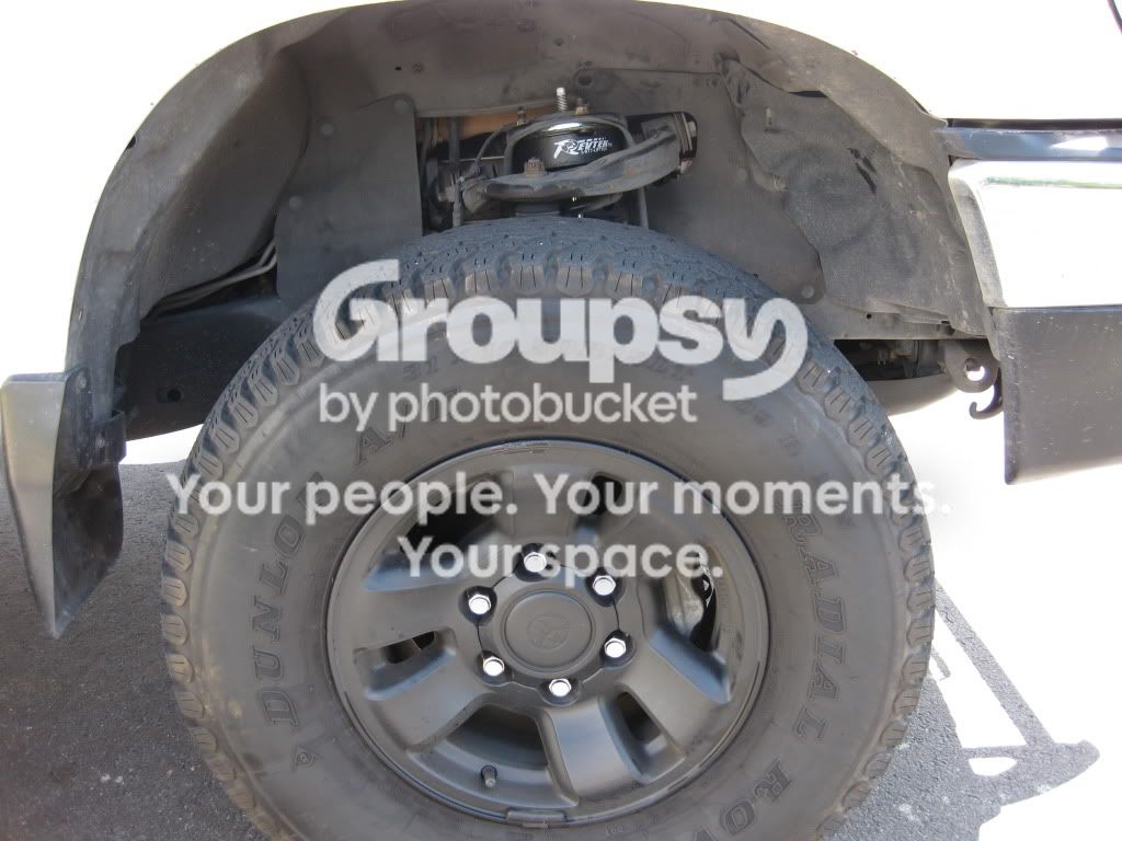

Then it was time for a lift! I found a guy on YotaTech selling his old lift so I picked it up for a pretty good deal. The lift is a Revtek 3" spacer lift up front and OME 890 springs in the back. I also replaced the shock and struts with Pro Comp ES3000's when I installed the lift. EDIT: In hind sight, I definitely should have saved up and gotten a higher quality lift, but at the time the lift was more for looks rather than functionality...When I upgrade to aftermarket bumpers, I am going to swap out the spacers for coils or coilovers.
Front:
IMG_0460.jpg~original
IMG_0459.jpg~original
Rear:
IMG_04611.jpg~original

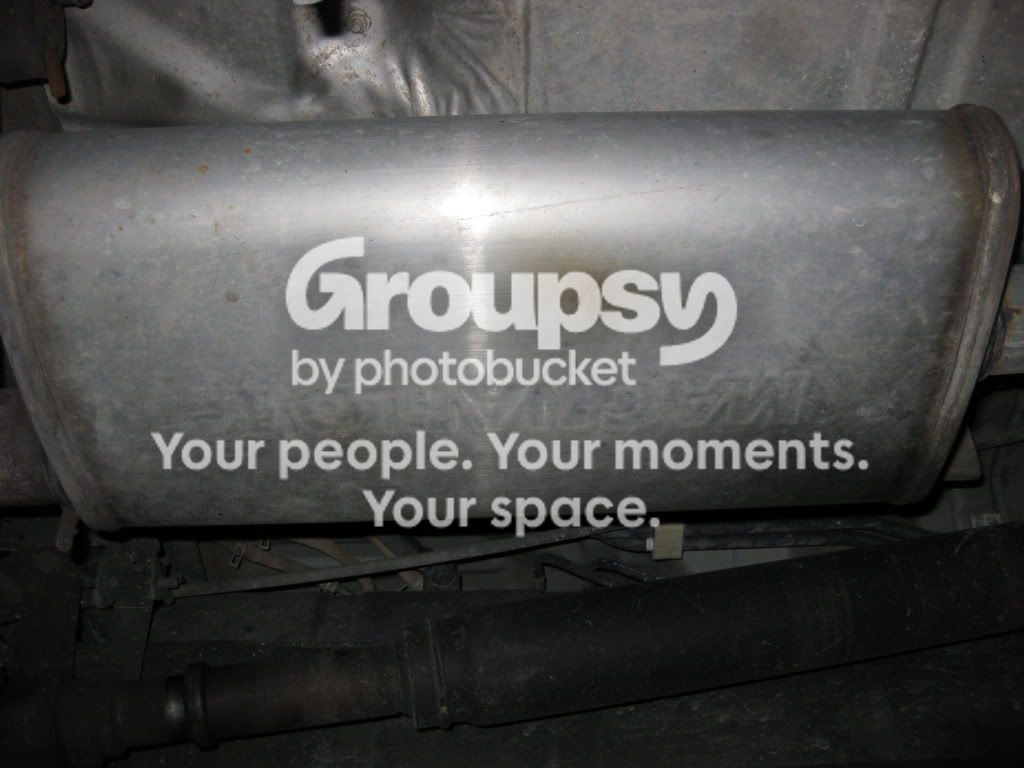

I also wanted my 4Runner to sound more like a truck so I had an 18" Magnaflow muffler installed. I am really happy with the way it sounds! It has a nice deep throaty sound and is not ricey at all. I don't have any pics of when I first installed it but here are some recent pics.
IMG_0613.jpg~original
IMG_0609.jpg~original

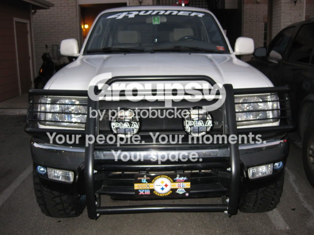

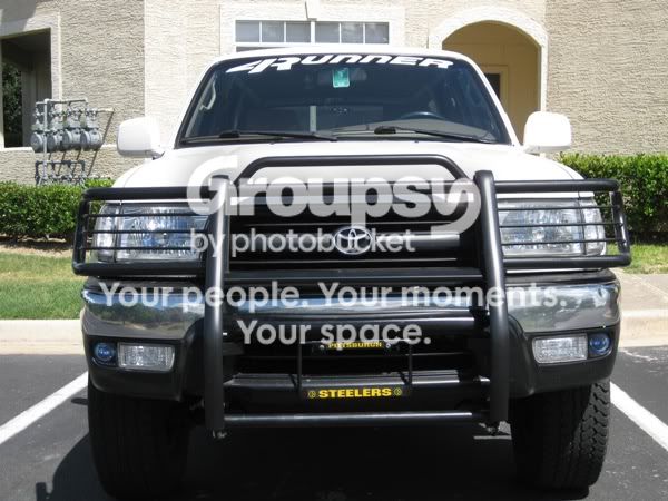

I installed a grill guard (that I found on eBay for about $300) and a window banner "4Runner" decal.

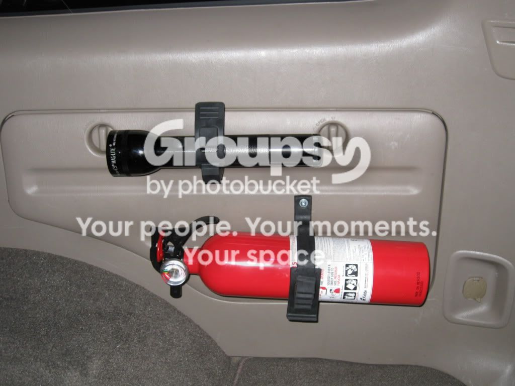

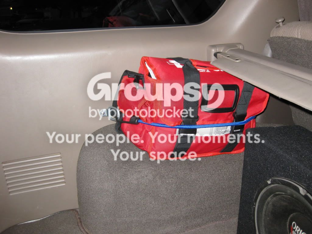

Mounted a Maglight, fire extinguisher, and first response first aid kit in the cargo area for emergencies. I used Quickfist clamps to mount the flashlight and fire extinguisher and they are awersome!

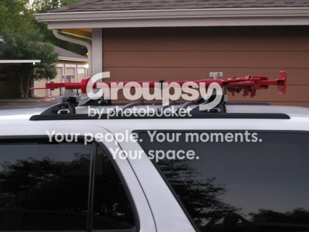

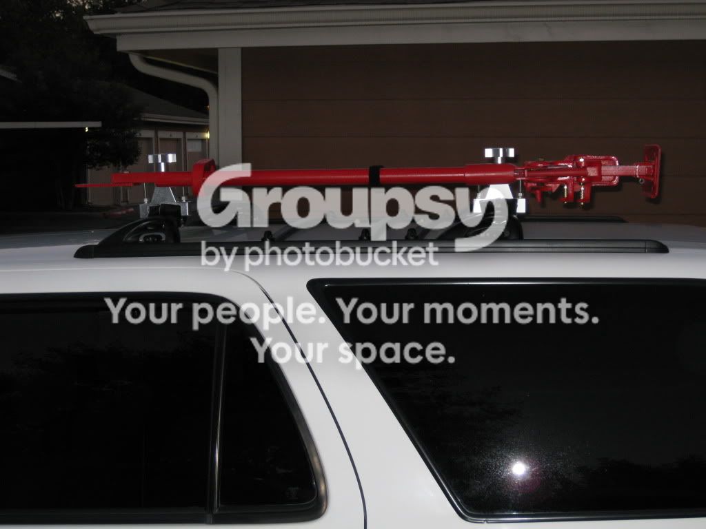

Mounted a Hi-Lift jack on the factory roof rails with some modified round tube mounts
IMG_0596.jpg~original
IMG_0595.jpg~original

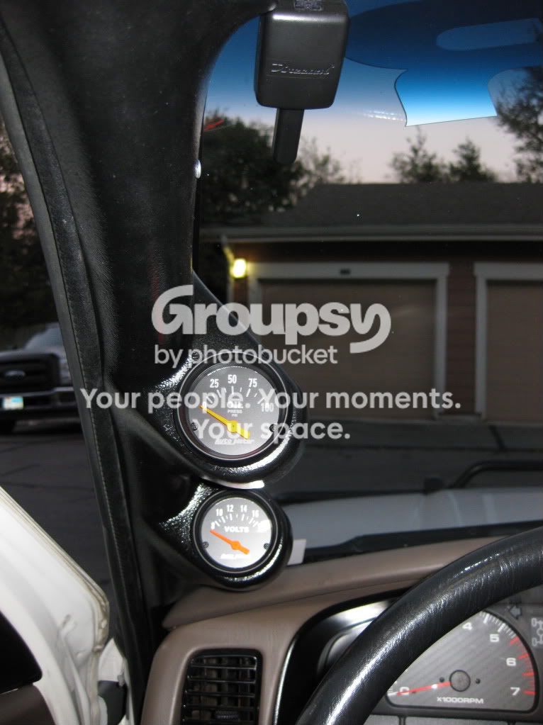

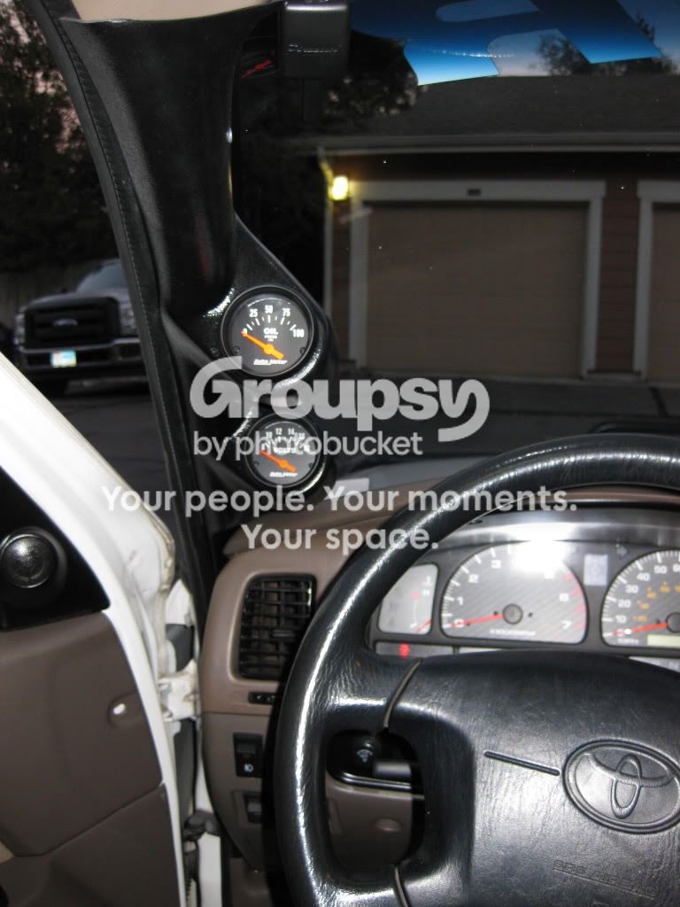

Installed a gauge pod with an oil pressure gauge and voltometer. I followed this writeup on 4runners.org: 4Runners.org - Adding an Electric Oil Pressure Gauge. Thanks Bob_98SR5!
IMG_0592.jpg~original
IMG_0591.jpg~original

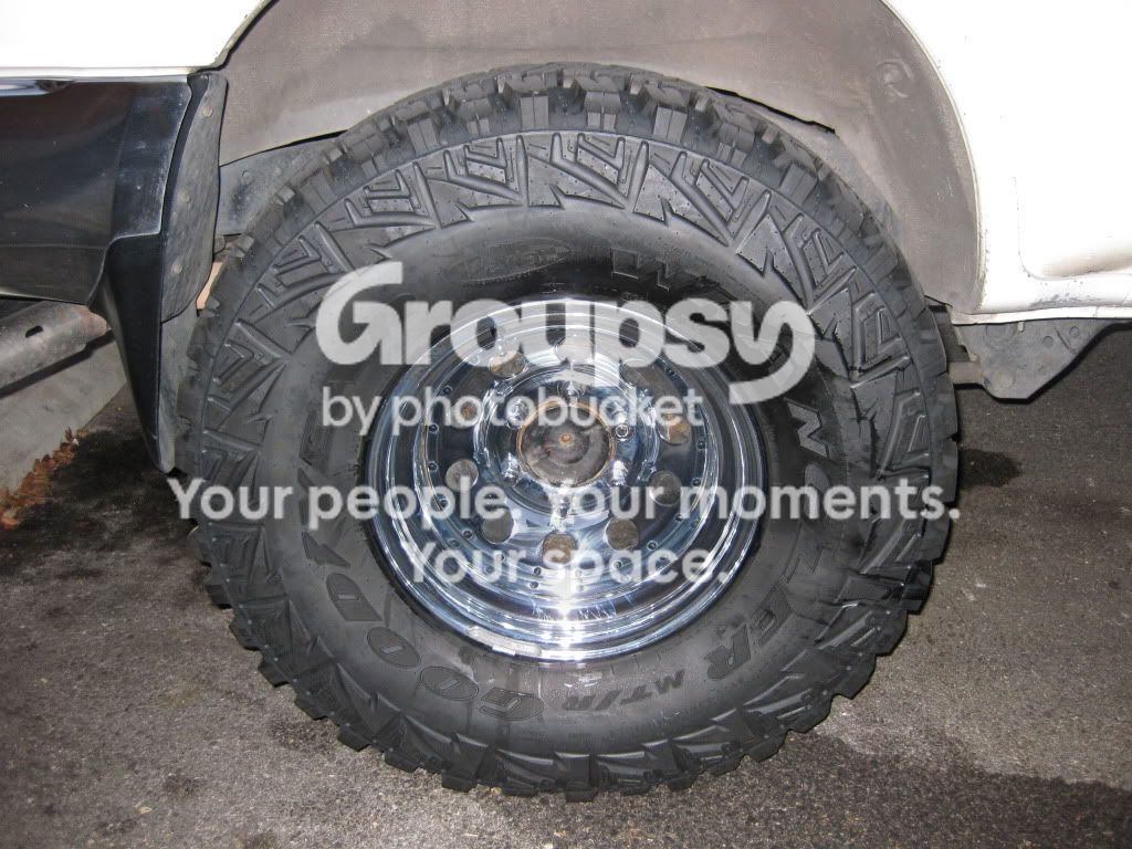

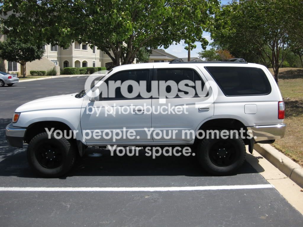

November and December were busy months for upgrades...First and most importantly, NEW WHEELS AND TIRES!! I found some 15" steelies on Craigslist for $150 and when I went to Goodyear to get my current tires mounted on the new wheels, they had a set of 33X12.5R15't that a guy ordered and never picked up. So they gave me a killer deal and I couln't resist....
IMG_0587.jpg~original
IMG_0623.jpg~original

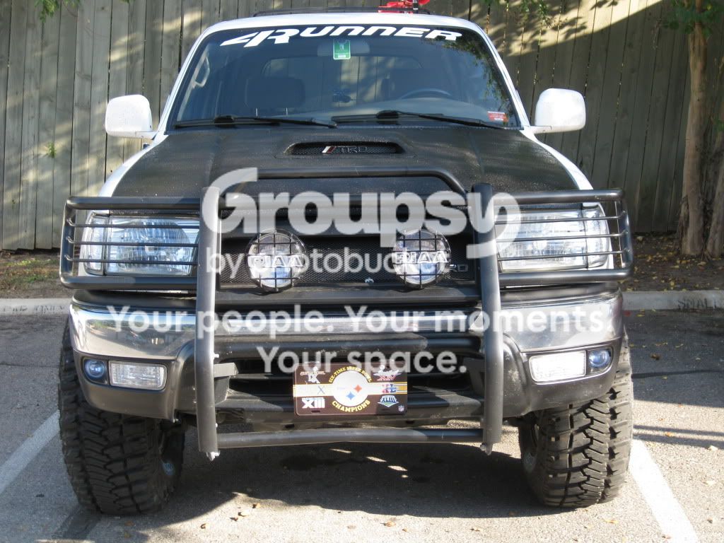

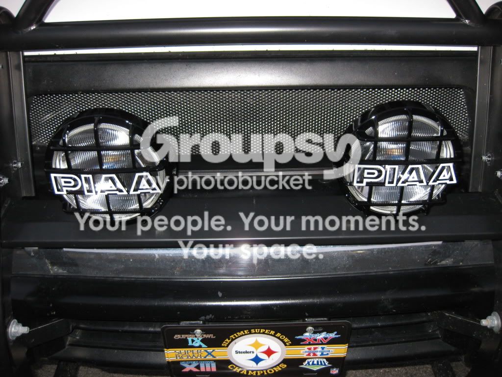

I was sick of the old grill so I did a Satoshi grill mod and I mounted up some PIAA 520 ATP's to the grill guard.
IMG_0590.jpg~original
IMG_0589.jpg~original

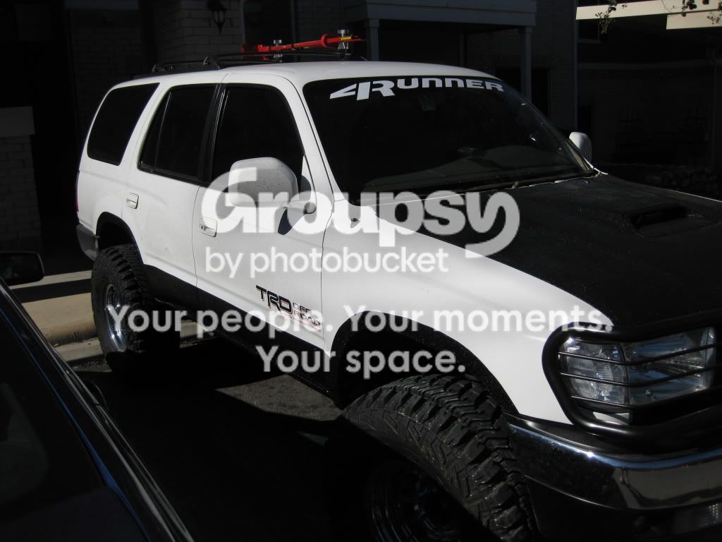

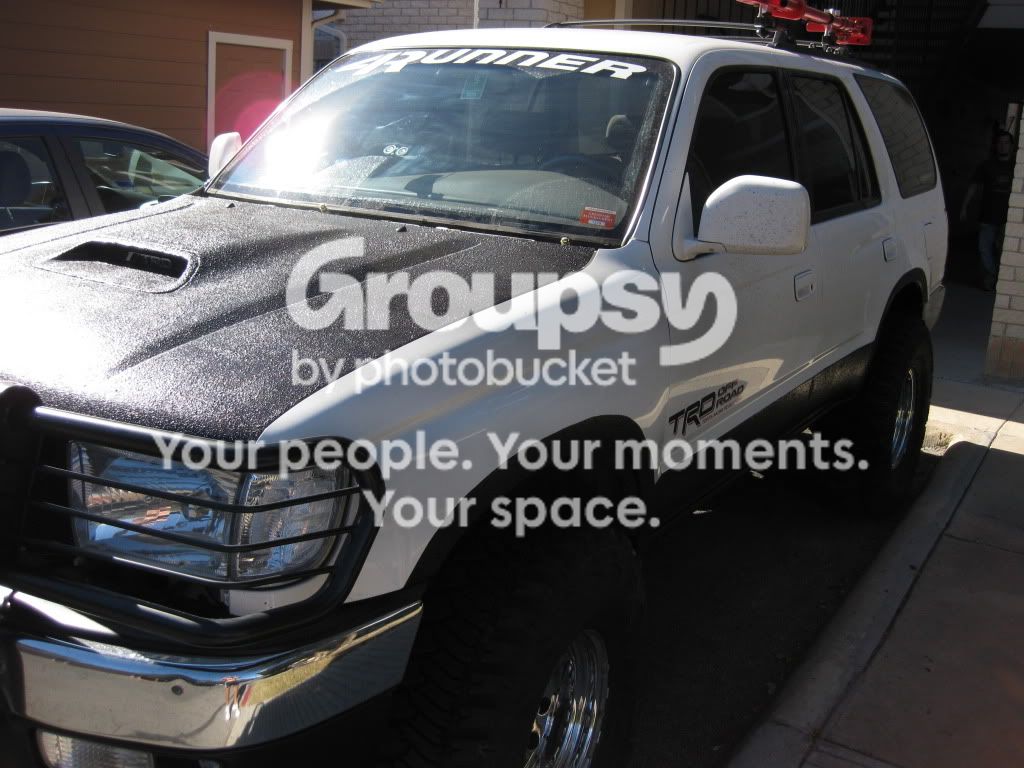

In late November, I found a scooped hood on Craigslist. The PO tried to paint it himself and ended up failing miserably and didn't want anything to do with it anymore so I picked it up for $125!! I ended up sanding all the old paint off, priming it and coating it with Durabak. I also did the rocker panels with Durabak. Here is a thread I started with more details about the hood: Found a Scooped Hood on CL, what next? - YotaTech Forums.
IMG_0646.jpg~original
IMG_0645.jpg~original
IMG_0644.jpg~original
IMG_0641.jpg~original
