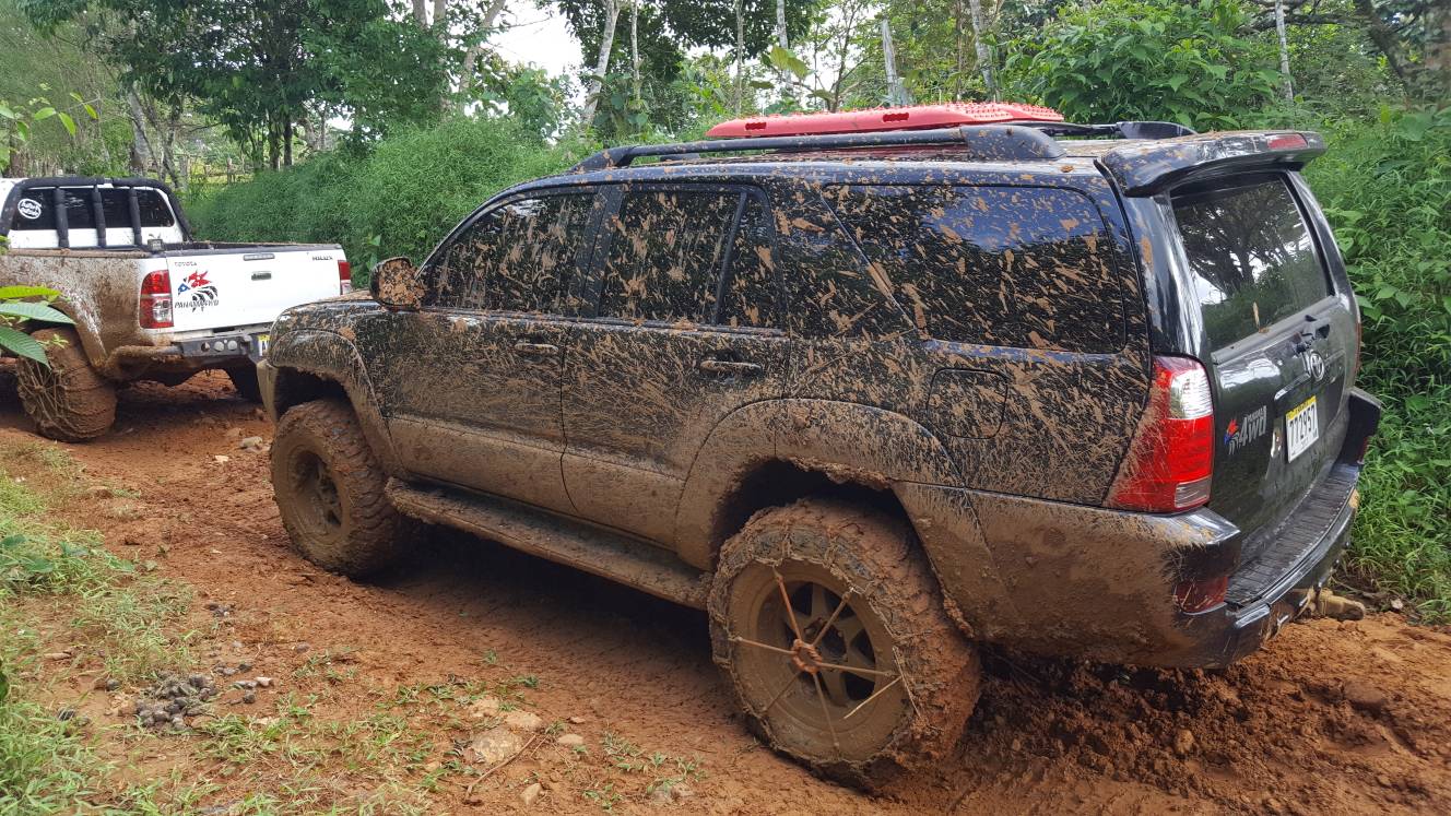

to the guy above, one picture shows why we want to not have to stop and add 4x4 engagements
got a decent shot of one of the holes we went through lol
i used a mix of 4h locked and 4l locked...couple section 4h unlocked
